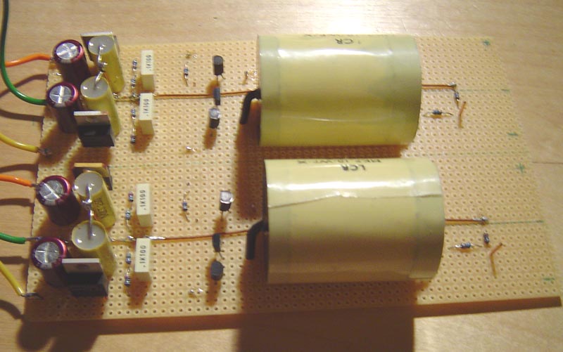

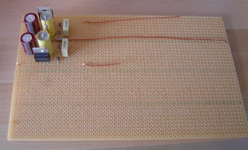

And this is the current state of the Buffer board. It currently has the second stage of rectification for one channel and i am about to do the same for the other channel.
Hopefully all be together by the weekend but lots of deadlines at work might mean it gets put back.

Here is my build of Nuuks psu.
Good work so far Fil. Nice and neat! I must redo mine sometime. When you keep changing/adding parts, it gets a little untidy.
My next job though is the 'delayed' start for the buffer output.

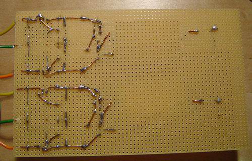

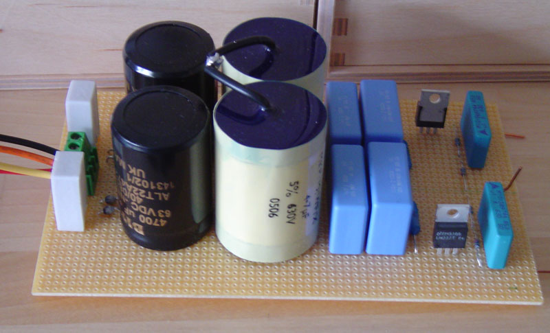

Hi all,
This thread had been dead for a while i know however i have just finished my Nuuk design psu and buffer. Havent had chance yet due to work to actually listen to it, 70hrs per weeks at the moment unfortunately.
I have also got a new 10k log alps pot to stick in so there is a way to go.
One thing i was wondering was wether the resistors ihave built it with are 1/8 watt 1% metal film. Are these too low power?
Also one channel is gving about 15.15 -/+ and the oterh 14.85 +/- will this level of difference be audible and how would i get around it. Will i need to change the resistor on the regs or should i use apot?
Any advice greatfully recieved.
Fil
They're fine Fil.
No problem at all!
Now steady on - 70 hours a week is a bit excessive isn't it? When will you ever have time for listening? I hope at least you are being paid enough to pay for the resistors!
