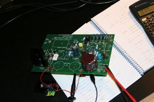

Boards haven't arrived yet - I'll expect them next week. But meanwhile I've succeeded adding your shunt regulator on my Pearl 1 boards. Setup is for 30V and 120mA of which 35 mA is consumed by the pre-amp (per channel). I've included a picture and noise measurements using ARTA.
