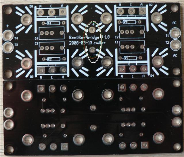

I have made some general purpose rectifier boards, which I have offered in the F5 thread , but people might not discover it inside this rather long thread, hence this new thread. 😀
The boards are 38x90mm and you can use all three legged diodes with common cathode (I haven't seen anything else).
You can see a picture of the board here:

rectifier boards
I received the boards, thanks. What are those two holes in the very center for? Also, are 1/4 watt resistors ok. I also have 2w kiwame carbons that I can use if I mount soilder style.
Re: rectifier boards
Yes, they are intended for 1/4 watt resistors. The holes are for a capacitor (in small scale applications), but unfortunately the holes got too small for snap-ins.

Christian,
I hope you are enjoying "summer in the city" and have eaten in Chinatown by now........MMMMMMMMmmmmmm.
I have a question about the center capacitor, it would be #5, (circled in photo)
What value should this be? same as the other 4?
Also it was not in your schematic.

Haven't eaten in chinatown yet, but I'm sure we'll do that soon. So far most of the time goes towards getting settled. 😉
The capacitor holes are there so one can use the board for some simple small stuff - if you're building a power amp, you can just ignore the holes. 😀

eemmmm, I gota nutha question
Christian,
Sorry to bother you again.
On the rectifier boards, the locations for the snubber caps are not marked + / - , pretty shure it makes a difference. As the caps I have are not nonpolarized. Help me out will ya please??? I've tried to figure it out, but no joy. I'm too uneducated...... Sad.

How large caps are you planning on using? I'm not sure it is such a great idea to use polarized caps for snubbers...
Christian,
as per your recommendation .068uF , I thought the caps were used as a buffer after the rectification to smooth out the remaining sinosidial wave. Or are they used to prevent the "ringing" of the diodes closing?

Yes, they are there for preventing ringing - so unless you have something else lying around, you might be better of leaving them out.

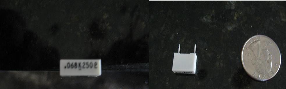

The caps I have look like little white plastic blocks with 2 pins out of the bottom. I can post a pic if that helps.

Renron said:Are you saying that because the capacitance is so small , .068uF that it would be OK to use electrolytics as the caps in a snubber network?
No, I'm saying that at such low capacitances, electrolytics are not needed, desirable, or even available. Your description of a "plastic block" sounds like a film capacitor, which should be fine. Film capacitors are nonpolar, hence no need to mark + and - on the board.

Grenert,
Thank you for taking the time to answer my (probably) foolish question. I know from hanging around this website long enough that even though some of us (me) ask to be spoon-fed information, it is better for us to figure it out on our own.
I too think what I have in my surplus bag of stuff, is a film cap.
Thanks.
I found some other stuff too, a 100V poly cap from Panasonic which, after I looked up the specs. led me to a table of "Permissible Voltage (RMS) in Alternating Current Corresponding to DC Rated Voltage". This particular unit I have is rated for 63V RMS Alternating Current. 🙂 Happy camper having learned quite a bit today on power supplies and how complicated they can be. I had no idea capacitors other than nonpolarized could be used safely in SOME A/C applications.
Thank you both VERY much.
