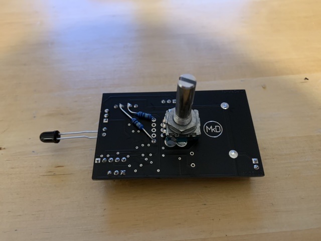

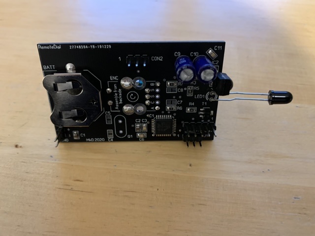

I finished a new project RemoteDial.
It is a Infrared Remote Control with following features:
- very compact
- min. amount of parts
- teach mode (learnable) for most IR protocols
- 6 functions only with one push button rotary encoder
(for example Volume -, Volume +, Input -, Input +, Mute, Standby)
- run with a CR2032 battery or alternative (AA or AAA)
- qiescent current 3-9uA
- battery life >30 month
Actually we build some Dials in a german forum.
Is someone interested?
In this case I will start a new batch pcbs and I will translate the documentation.

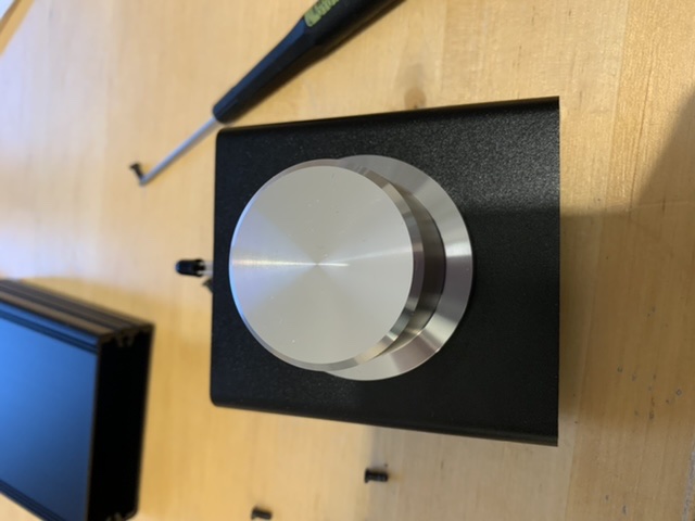

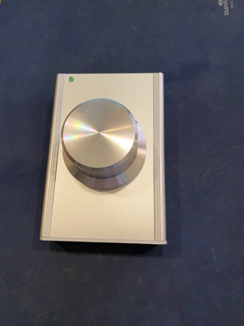

Hi all,
i have one of the first RemoteDail pcbs and what should I say, great! 😀
Packed all the components this morning and I let our trainee do it this in the forenoon ... later it looked like this.
A first test at my Pre in the office, everything is fine and works great (loud / quiet & input up / down & mute / standby).
So far it's a great toy, I didn't expect the haptic / experience. It's like controlling everything directly on the device!
Best regards ...Carsten
