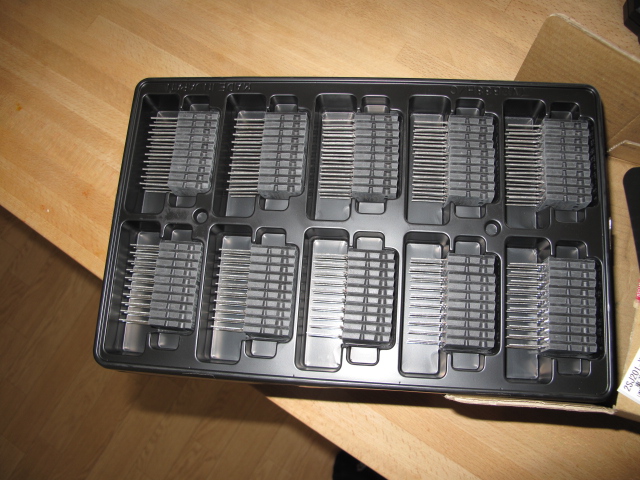

Dear all,
As you may understand from Patric’s comments some of us with F5X cases from the first GB have been discussing how to get the 1530/201 output devices to finish up our builds the best possible way.
A few weeks ago I took action by purchasing 500+500 devices in Japan with the pivotal help of Nikon1975. I did this fairly costly investment knowing that heinz1 would be able to help me with the matching, ashaw with data analysis and Patrick with special equipment and advice.
The purpose of this effort is to offer quality matched devises to F5X builders with priority to those from the first case GB.
The whole thing is not going to happen in a few weeks, as I will first get the devises mid July. As a moderately optimistic estimate I would say that distribution could be done the first half of September.
Although the final matching procedure has not been decided yet, it will be done at operating temperature/current using a curve tracer. Different methods are being tested and we will continue this testing until the fets arrive. I will of course post the exact method and I hope that AndrewT will check a set of devices to validate the quality claims we will come with😉
I find it useless to discuss what kind of pairing to do until we have a good idea of what we have in hand.
As for pairing, pricing cannot bee decided until we know the device spread. I hope the cost will be similar to the price offered by zhoufang. I’m not doing this to earn money (fortunately I already have a good day job), but considering the work and the risk I’m taking I think making a loss would also not be fair.
I’m not asking you for any upfront payment, but simply to have a bit of patience and stay tuned. If you are in a rush to listen to your F5X, which I very well understand, I guess you can use what you already have at hand or get devices from zhoufang - entirely your choice.
Nevertheless, as the investment has already been made I hope for your continued support.
Nic
