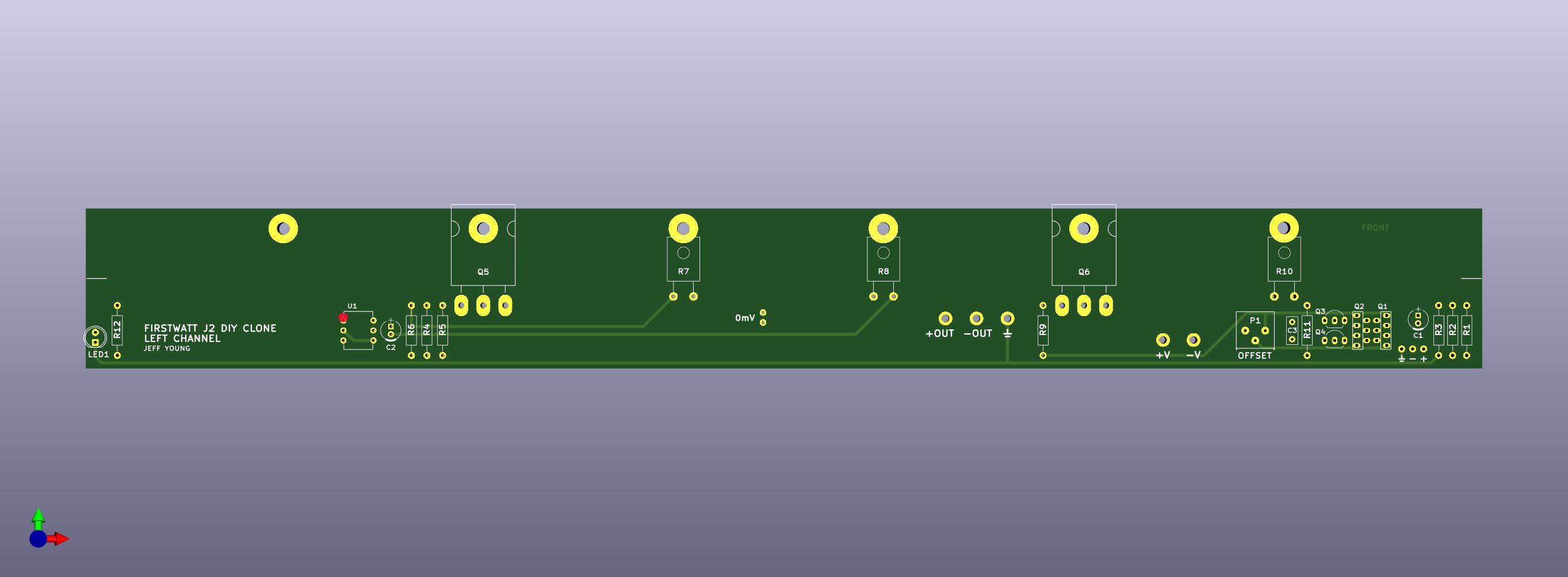

GB "long and skinny" FirstWatt J2 clone PCBs
@EU,
pcbs arrived in Berlin. 🙂
