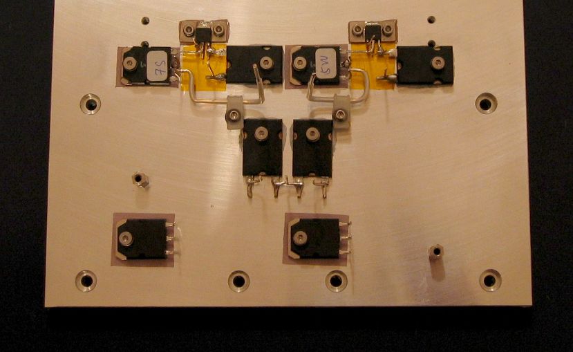

Question for anyone that is using these insulators
I am considering buying a small sheet of this product to cut into insulators as needed, but I have a few questions for the users on this group buy.
Has anyone tested the product to see if it is actually performing better than mica and grease or other insulators?
How workable it are the insulators? Are they too fragile to cut with an exacto knife?
Any insight would be greatly appreciated.
Nick
Nick
Nick:
Good questions. I've compared them favorably with the best performing Bergquist pads available at Digikey. I'm not sure if tab temperature is the best metric, but that's what I used. I'd be interested to see if there is another way to compare them, without drilling holes for a thermocouple. I have recently ordered a IR thermometer and plan on comparing with that as well, once it arrives.
I would say they are a bit more fragile than other insulators. The main thing to worry about is torquing the device down too hard. Cutting with an exacto knife is possible, but you have to be careful with the fiberglass pieces that run through the pad. I'd suggest clamping the piece down with say a piece of aluminum and exposing the edge you wish to cut. The clamping force will help prevent pulling on the fiberglass strips, which is what causes the pad to tear in my experience.
I have a few pieces handy that have manufacturer defects that I'd be glad to pop in the mail for you, just shoot me your information and I'll try and locate them among the various piles of stuff in my work room :)
Thanks for the info. I would would definitely be interested in your findings when your IR arrives. What temp. difference are you measuring between tab and heatsink?
Measuring tab temps. I recorded 30c difference with silica on a high biased F5 pass clone and 22c difference on the same amp with mica. I would really like to drop that number further.
If I commit to my purchase then the defects would be great, especially to practice cutting on a few pieces before touching a virgin sheet.

You miss the point completely. The stuff requires NO grease, just like Silpad.
But unlike Silpad, or mica with Whatever grease, it has a maximum temperature difference of 5°C at 30W dissipation on a TO247/TO3P.
I have been using the stuff for years (since 2006), have measured enough examples in enough different applications myself.
I am also the one who made it know to the Pass forum.
So the stuff works, as long as you use it properly, like NO grease.
See :
http://www.diyaudio.com/forums/pass-labs/37262-mica-goop-2.html#post1032023
Even the fragility of the foil is public since 2006 !!
Patrick
PS You can get A4 sized uncut sheets (which is what I use) if you buy enough. But you need ceramic scissors to cut them properly. Or at least use a brand new one which will be no good for anything else after finishing one A4 sheet. The foil is ceramic powders embedded in plastic matrix.
