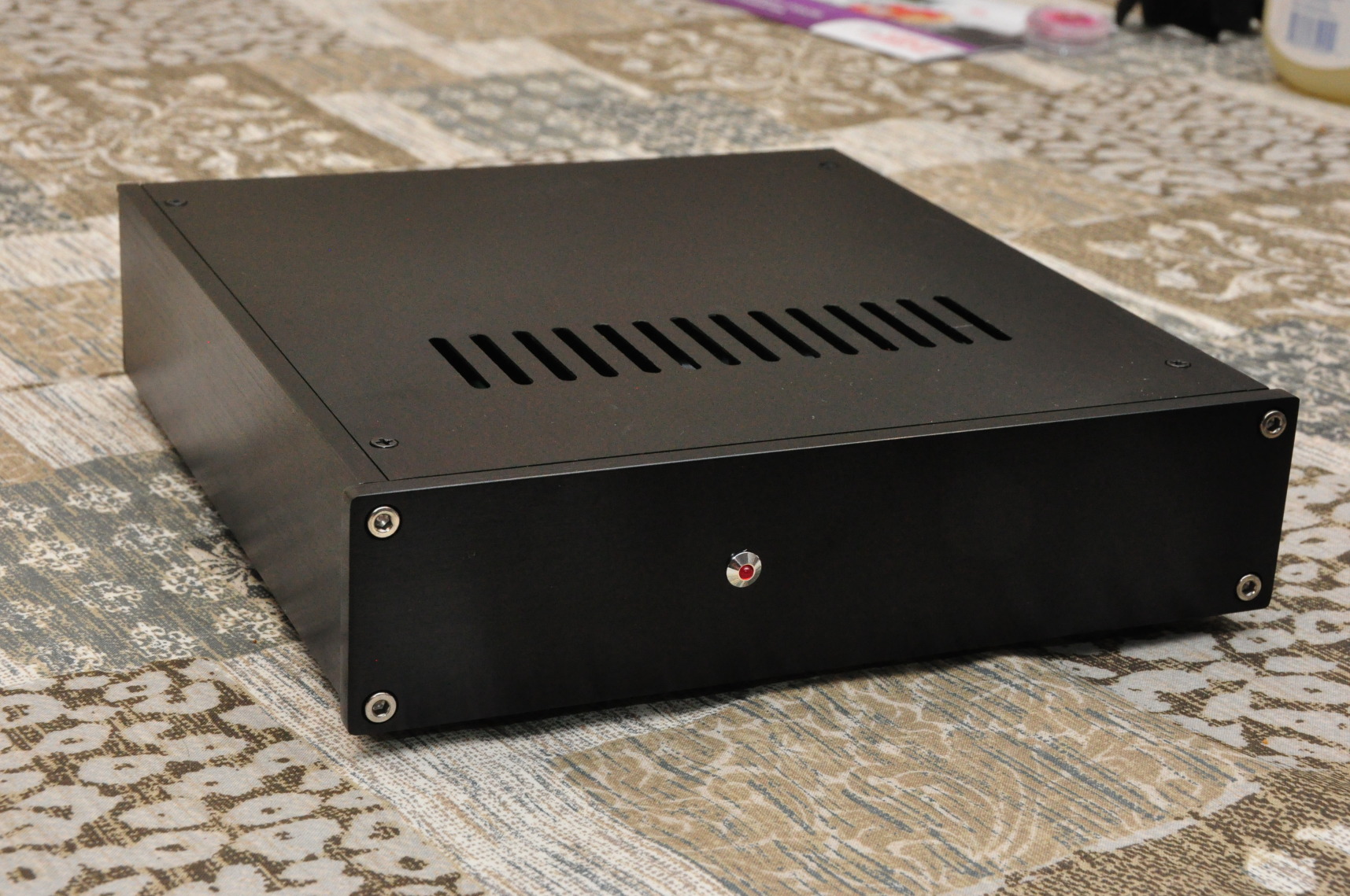

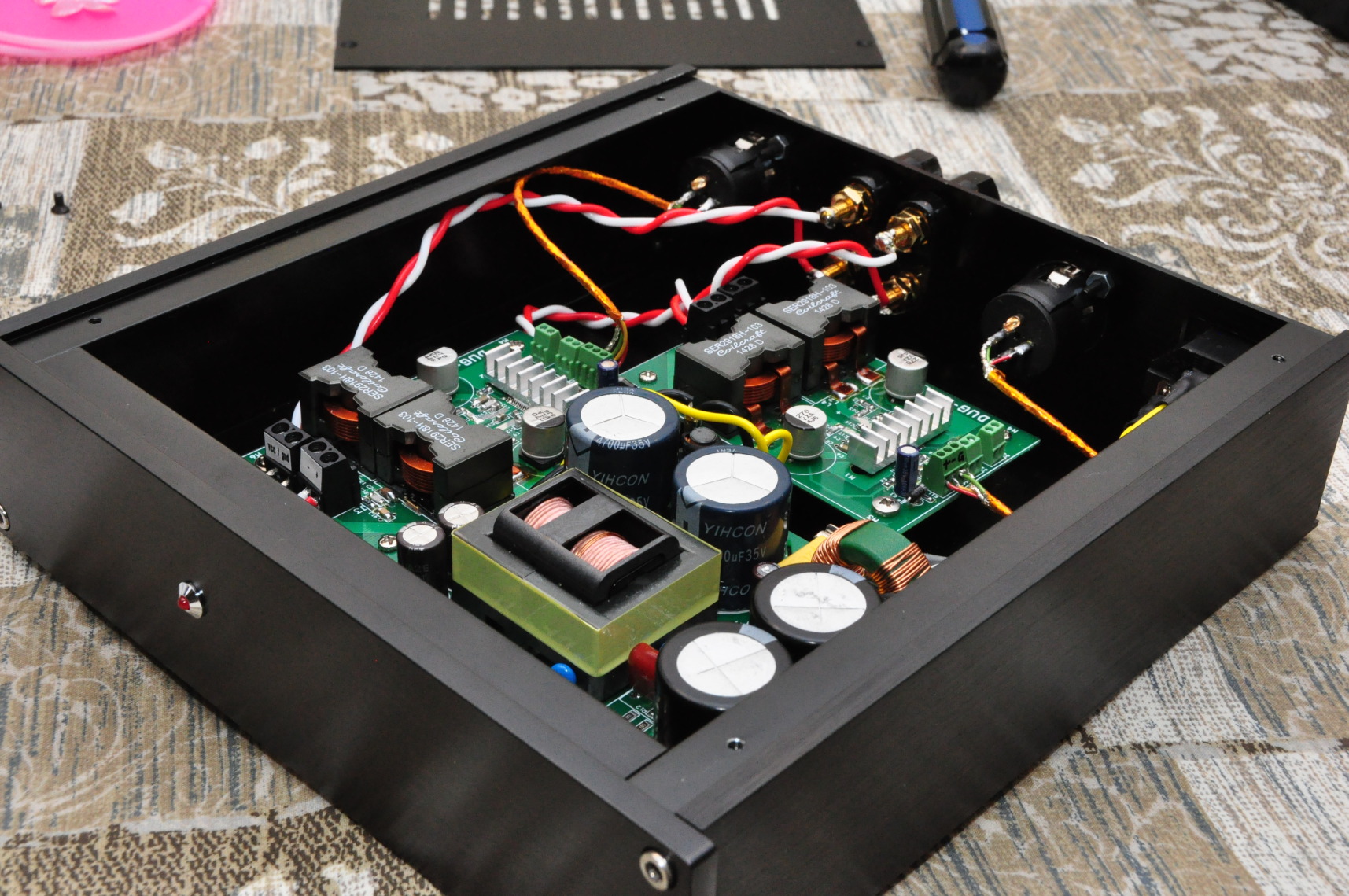

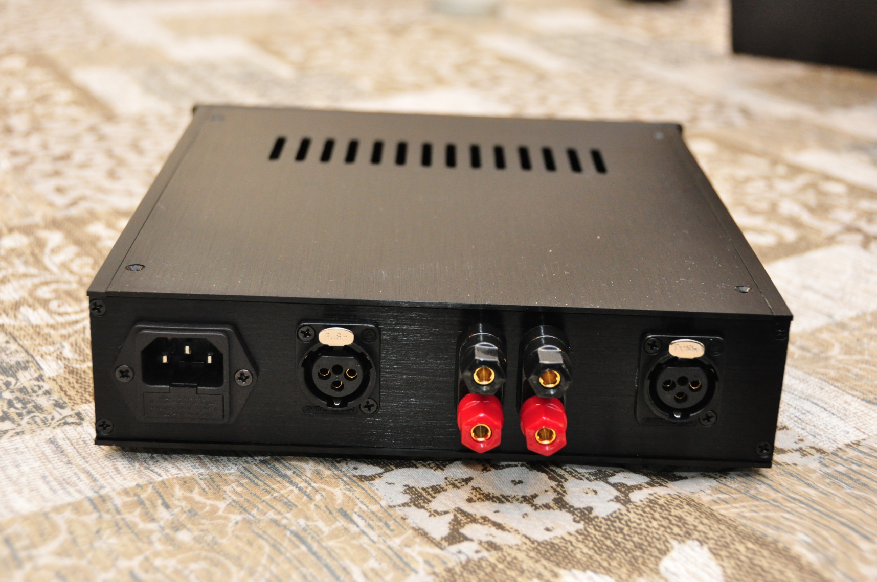

Finally finished my DUG-1 build. I posted some pics a week or two ago of the boards in "test mode" on a paper plate. Finally got the case all put together. Some features that I haven't seen much of in others' tpa311x build: balanced XLR inputs and use of the ConnexElectronic SMPS300RS power supply.
This is going in the living room; I'm replacing a modified YJBlue tpa3116 with it. I took the new build for a "test drive" last night: it powered the speakers while my wife and I watched a movie. Worked fine!
I'm flirting with the idea of moving to a bigger case where I can use the Edcor input transformers (and dispense with the input caps)... or maybe I'll have to build a whole second unit!
Enjoy the pics!

Nice implementation, m_g! I've got my eye on that same PS for an upcoming build. Do you have an earth safety ground to your chassis and how is the music experience?
BK
BK
The smps300rs takes AC, neutral and ground for input. The documentation explicitly said that you should use metal standoffs to mount it, so I'm assuming that's part of the ground circuit?
Haven't really had a chance to listen to tunes yet, except for a couple weeks ago when I tested it in "pre finish" state. But it sounded great then, definitely better than my modded YJBlue amp.
Hopefully I'll get some time tomorrow to do some more music listening.
Nice job matt_garman! You've really come a long way in your DIY building skills, and the clean work is professional. I promise I will be done with your Edcor input transformers in 1-2 weeks. I've been traveling quite a bit for work and have to go out of town this week. Oh well, at least I have had time to check out record stores in other places. If you do decide to use the Edcor transformers, and you should strongly consider it, you will need a larger chassis. Fortunately, DUG incorporated thru-holes on the input cap locations, so wiring in the transformers will be easy. Thanks for being patient.
When there is DC all the time I read it should be blocked from transformers in order not to have increased treble distortion. That doesn't help with removing the damned capacitors. Core material more expensive transformers will add less than Edcor's, but distortion added could still be considerable.
I don't know, might be true.
i didn't measure DC on my CineMag transformers or on Matt's Edcors. It's no problem at all. In fact, it's a great solution to getting rid of audible colorations from caps. An even better solution is having a source with balanced outputs and feeding these directly to the TPA31xx amp inputs as long as the source's output impedance is suitable. Then one wouldn't even need input transformers for balancing the inputs.
Only if the DC sits at the 3V the amp is expecting. Differences from this may (just supposition) produce DC offset at the output.
One of these days I will make a test setup to find out the answers to this and other questions about this amp.
There is 3.01V DC both on negative and positive input, the caps block that and the transformers do too, however see my earlier post.

Thanks for the kind and encouraging words! I don't want to toot my own horn (too much 😉), but I have to say my latest builds definitely look better than my early ones. I find this work to be somewhat like painting a room: the more time spent with planning and preparation, the faster the "real" work goes and the neater the result. I usually only have a few hours on the weekends to tinker with this stuff, and my only work area is our dining room table... meaning there's an ever-present pile of junk that (particularly for my wife) gets to be an eye-sore. I think to myself, "OK, after this one, I'll take a break for a while." But then I finish, and I'm so pleased with the result, I feel compelled to start another project ASAP! While the finished product tends to have high WAF, the process of getting there, not so much. 🙂
Anyway, no hurry on those Edcors. I think I might actually be able to squeeze them in the current case if I move the amp boards around a bit. Maybe. Thinking about buying a second Edcor anyway for a possible dual-mono PBTL tpa3110 build, using either these "AC1103" boards I bought off Taobao, or maybe the new Sure PBTL boards...
Any link to the case that you used for your build?
This is the particular one I ordered. That's the "L-2205" aluminum enclosure, seller along1986090. USD $30 + $24 shipping from China. If you just do an Ebay search for "L-2205", you should see lots of different sellers selling the same thing, for roughly the same price. I've ordered a few cases from that seller though, often asking for slight tweaks, e.g. black face instead of silver, or vent holes on top. Always responds quickly and fulfills the order accurately.
