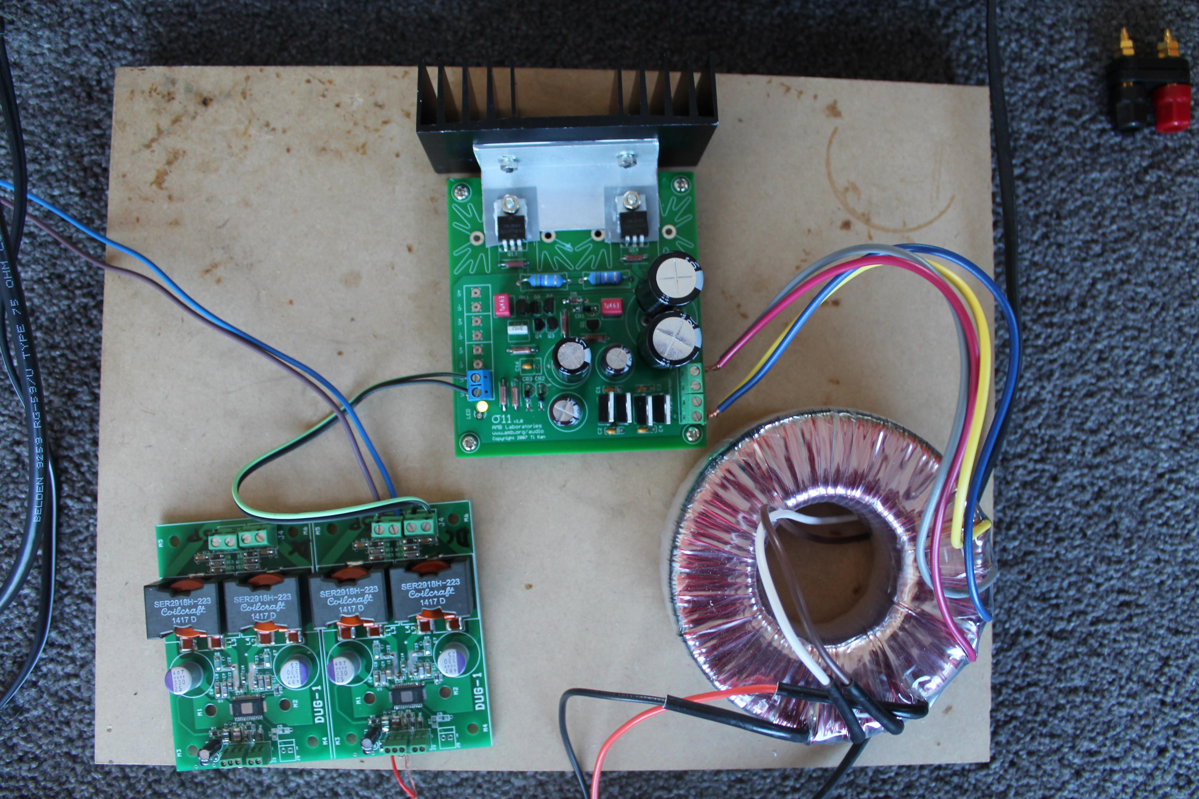

Yay, makes music! Somehow I always get a bit nervous first time applying power with a build like this, especially SMD.
Doug, its a great board, easiest SMD build to date. So much better than moding those Chinese boards cheap as they are.
OK, time for a coffee, hook up both channels later for a real listen.
BTW PSU is an AMB Sigma11 as requested by my friend I built this one for. Mine is next😉

How much Ampères can sigma11 deliver like that? Is it modified like latest sigma22 ?
Its a matter of how much heatsink you attach, the MOSFETS are rated 8amp so thats the max. I estimate with the heatsink I have used 2amps continuous but, of course, the 3116 demand is not continuous in fact its dead cold at low levels.
Of course its the watts and temp rise that the heatsink can handle. Watts calculated as input voltage-output voltage*continuous amps. The input to output in my case is 10v, necessarily high by virtue of the PSU design.
I will run the amps at a reasonable level for a while and monitor. I have a large CPU heatsink ready if this one is not enough.
Don't know about the sigma22 mods.

As I understand it, AMB recently tweaked the sigma-22 with a couple extra parts for lower-noise performance under sustained high-current conditions. The sigma-11 board has not yet been modified due to remaining inventory of the existing design - I asked. They are great performers regardless. I have six of them on various DIY projects! My TPA3118/sigma-11 runs super cool @ 18V with the default heatsinks.

We bought 2 sigma11 boards but I will use mine on another project. For my DUG board I will use a non-regulated supply as per design supplied by Destroyer OS, have already built one of these and very happy with the result. It will be interesting to compare the 2 DUG builds with the different PSUs, otherwise identical build.
Well did some listening including at least 1/2hour at highish volumes - the Sigma11 heatsink barely gets warm - I think its fine, overkill if anything. Basically music does not constitute a continuous load by any means.

Th say that I would need to set up a proper comparison. Unfortunately I have just swapped drivers around and the driver/cabinet combination I am using to test is not one I have used before. Given the driver/cabinet combo (Tangband 4" in FH3 cabinet) I am very impressed by the sound, good separation, plenty of bass etc..

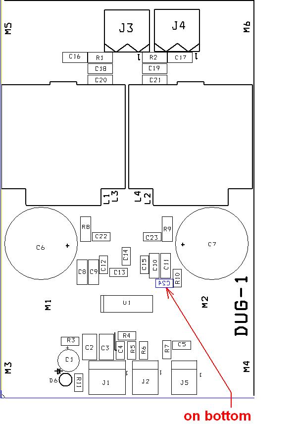

I just got my boards - very nice! I love it that there is room for the massive Coilcrafts! Now I need to order the SMT parts.

I missed which post contains the schematic and BOM... ?
Thank you Dug! 🙂
This BOM is a little old and some of the parts are not available at Digi-key any more.
Feel free to sub parts...just watch voltage/power ratings and package size.
I have found another inductor to add to the list.
I am using it in the kit (parts arrived this week).
SUMIDA CDEP 10uH 11.5A(10%L drop) CDEP147NP-100MC-125

Dug,
Thanks for the BOM. Can you believe I actually ran out of solder? Same spool I have had for 10yrs. I need to get Pb solder - none of this all tin stuff. This looks like a lot of fun. If running dual monoblocks with separate PS do I need to do master/slave sync?

Your choice to run master/slave.
But remember that choice is made with R4 / R5, not just the RC filtering between the two.
