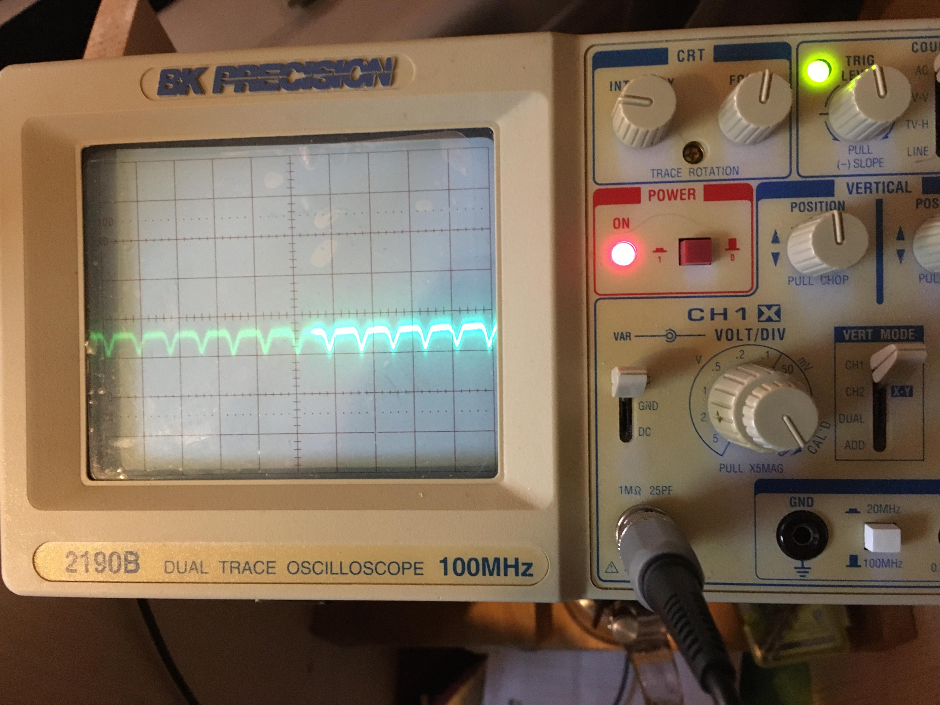

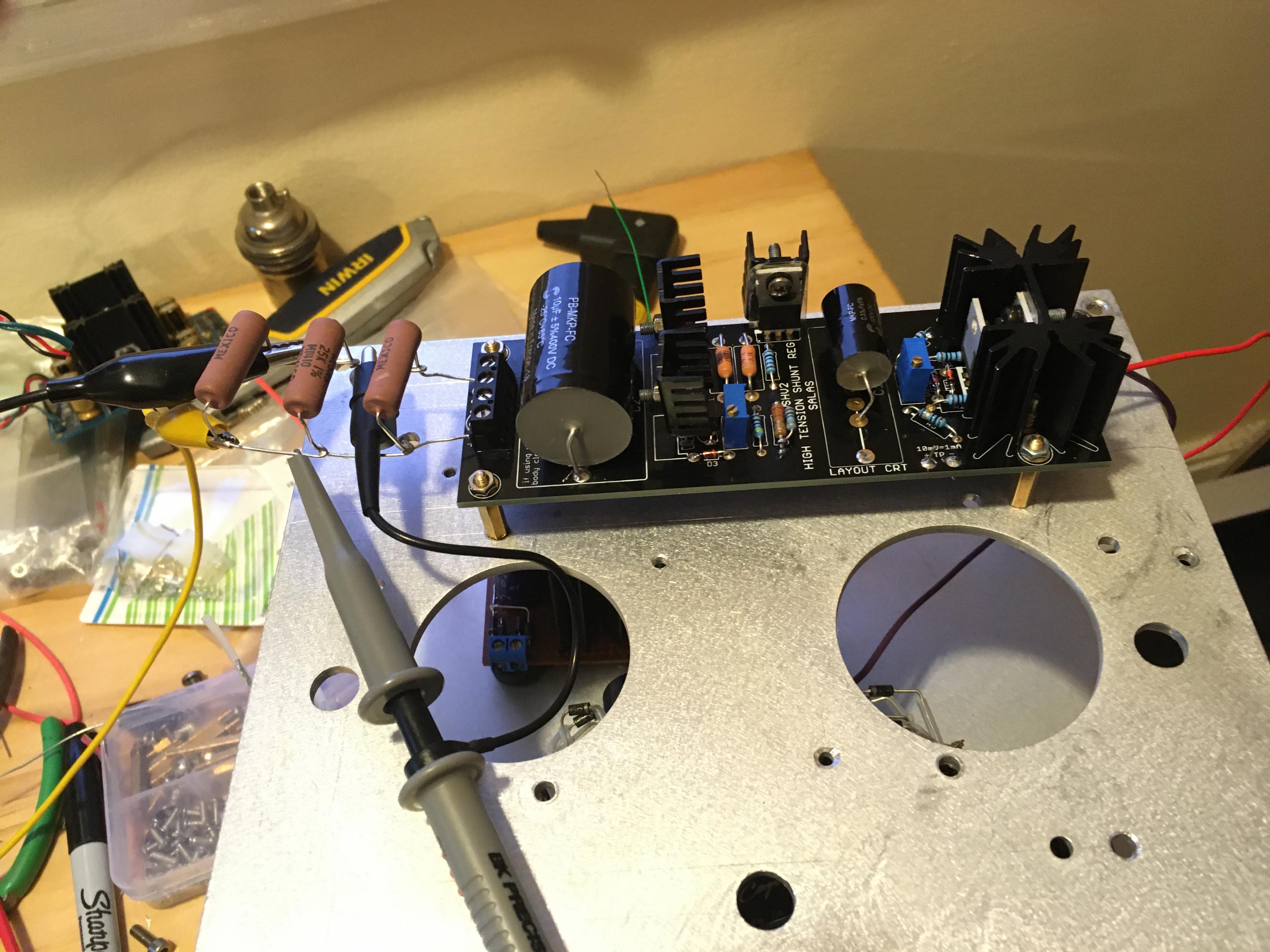

I am just getting around to putting these boards together and inserting into my preamp. I've built a few sets and have been pleased. I just put a a scope on a dummy load and was surprised at the ripple, its at 2mv/cm but its not very smooth. Is this what is should expect? Is there a way to smooth it out.
Comparing it to my Superreg boards I got from Allen Wright, the sshv2 seems to have at least 10x the ripple under the same conditions, -250v/40ma.
Rectification ripple is 100Hz (EU) or 120Hz (US) saw tooth. This is something else. Maybe common mode interference. Pull out the hook cone, put the short ground spring wire accessory on the probe's nose and measure on the connector screws. Also press the 20MHz bandwidth limit button on the scope. See if earthing the metal surface it sits against has any effect as well.
Spare current should be set 20mA above load draw and this mini sink on the Mosfet won't take it during the test by the way. Unless the reg is set current starving right now and almost all the CCS current goes to the load. If so, its operation is challenged.
I see also the heatsink of DN2540 small.
