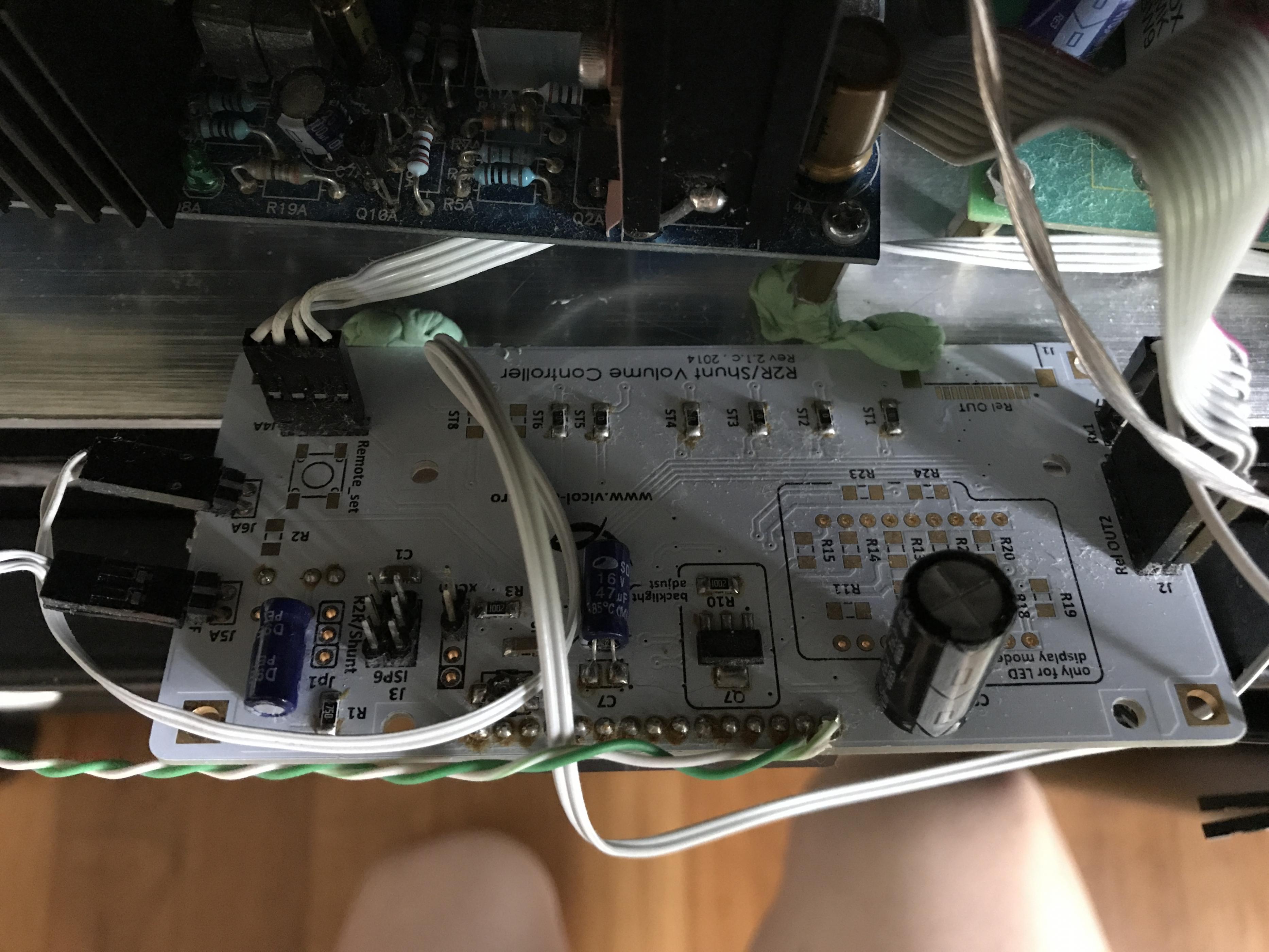

Hi Tibi,
The new file does not even power up the board. back to 4.1 now. The earlier 4.3 flashes fine but changes in volume clicks directly to output like the other transistor version software. This latest one does not even power up.

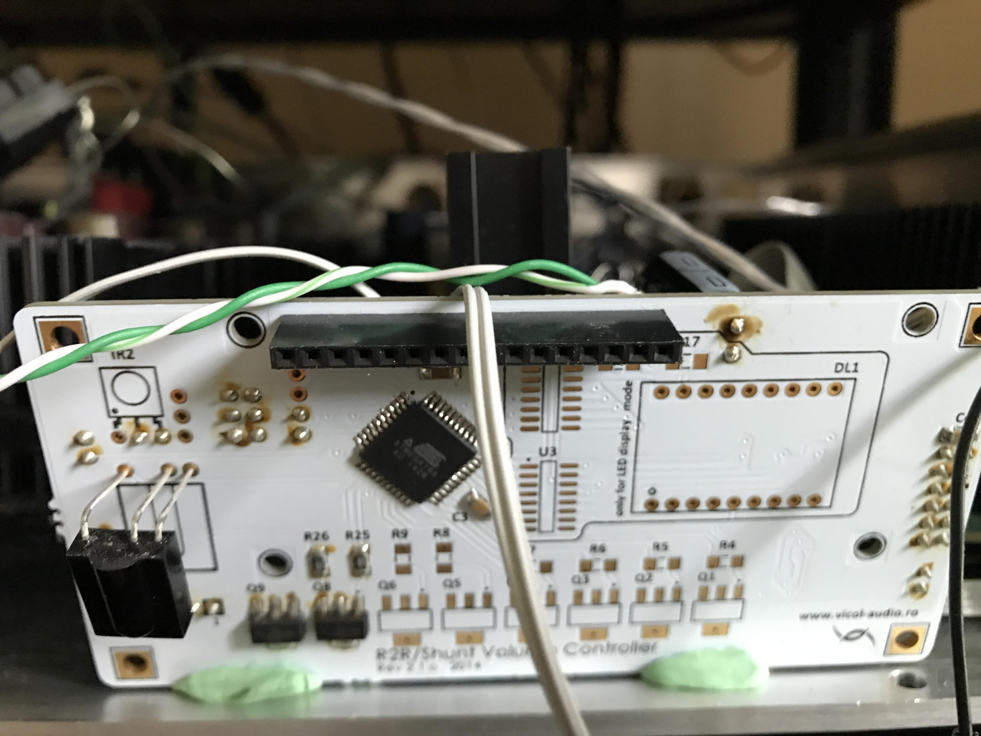

Hi danzup,
Happy New Year! Unfortunately this does the same thing. if it offers any clues, the relays don't click when testing the communication with the controller with the avrdude -c usbtiny -p m16 command when the offending firmware is flashed.
Additionally, you just hear clicking through speakers with each volume increase. Back to 4.1 again.
To be clear, the version I have is the assembled boards from Tibi. The boards are white just like the ones in the guide. There was no option about choosing transistors installed... so this is a little inconvenient that firmware upgrades are difficult. Since 4.3 is the final version, I hope you can help with this.
Hi ristar,
I have tested 4.3 and this version on a old r2r without transistors board and all firmware are working without issue . Can you post here a picture of pcb with lcd front and back ?
I think there is something else here ...
I have attached the version 4.3 without transistor here.
Best regards.
Best regards.
Hi danzup,
Hi ristar,
Best regards.
this version is 34k vs 36k from the one tibi posted earlier. the clicks only start from -32 and up... I didn't test all the way because I still like my unifield3 😉
