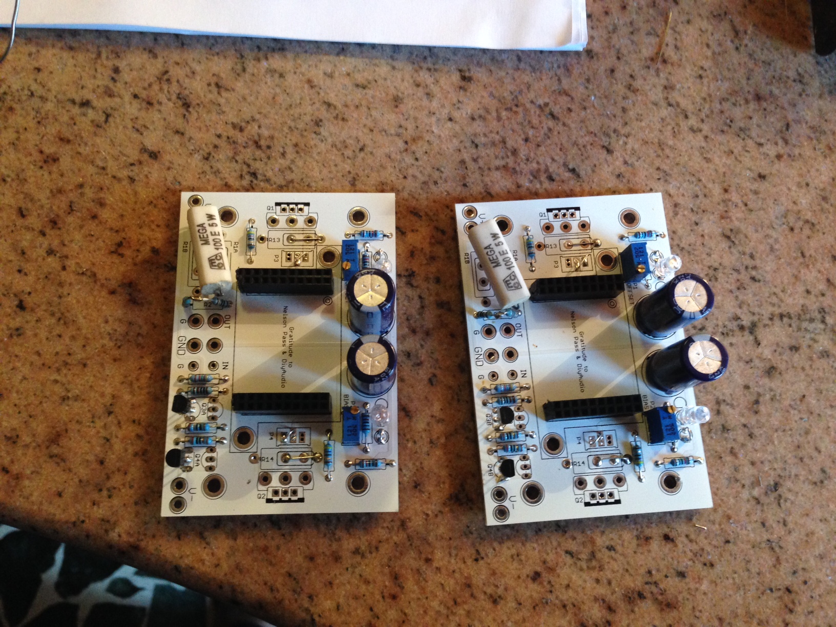

F6 build - How to set the bias
Trying to complete a long pending project during this Christmas vacation. I finished stuffing the Tea-bag's F6 boards with all the components and also jumpered the un-utilized LED and output degeneration resistor and preset slots.
I have the required Semisouths as well.
Now I need to test the boards. I do not have a variac but have a light bulb setup. To begin with, do I set the bias pots to zero resistance, and if yes, to which side? Also do I set the offset pots to centre?
Please help.
Attached is the picture. Please let me know.

I would install the transformers, and try to get units LEDs to light up with without the FETs installed. Should get voltage over the toshiba JFETs.
If that works, then install FETS, but get the Pots at the lower Ohm reading first, by measuring underside of unit.

Should I measure pots to zero towards the side indicated as CW on the circuit ? Also where do I measure bias? On the set of parallel resistors in the PS?

I measure the pots on the underside of PCB.
Yes, measure the bias from the power supply resistors.

Pot is maxing out for bias on one channel
Managed to get both the channels up and running. Adjusted the bias and offset on one channel to 1.5 amps measured on the resistors of the power supply on one rail. While the other channel biased as well, the bias preset is maxing out at 1.2 amps. Do I need to reduce the 10K resistor value (R4) in series with the bias LED, or should I change the LED?

Hi Anilva,
What is the voltage across the Semisouths from gate to source?
Are you using Blue LED?

Just to shared my thoughts wrt resistor feeding LEDs and 5 k trimmers,
LEDs in general prefer to be well forward biased for the Vf to be well establish. For a typical blue LED, 3v forward voltage correspond to about 10 - 20mA forward current (some variation depending on make). In reality one also needs to consider 5 k pot in parallel with LED. Assuming 3v across LED, there will 2mA flowing through 10k resistor with 0.6 mA is going through pot (3v/5000) leaving 1.4mA for LED. 1.4mA is far from ideal for running any LED maybe that is the reason why there large variation in experience.
I'm using 1.2k instead with 2 blue LEDs. Reason I'm using 2 blue with in my setup is to produce about 6.2v ref voltage which gives able voltage to explore SS or IRF or any other lat fets. Pots takes 1.2mA leaving about 12 ~ 13mA for LED. Question for all, why isn't there a cap for smoothing of the Vref generated by LEDs?
