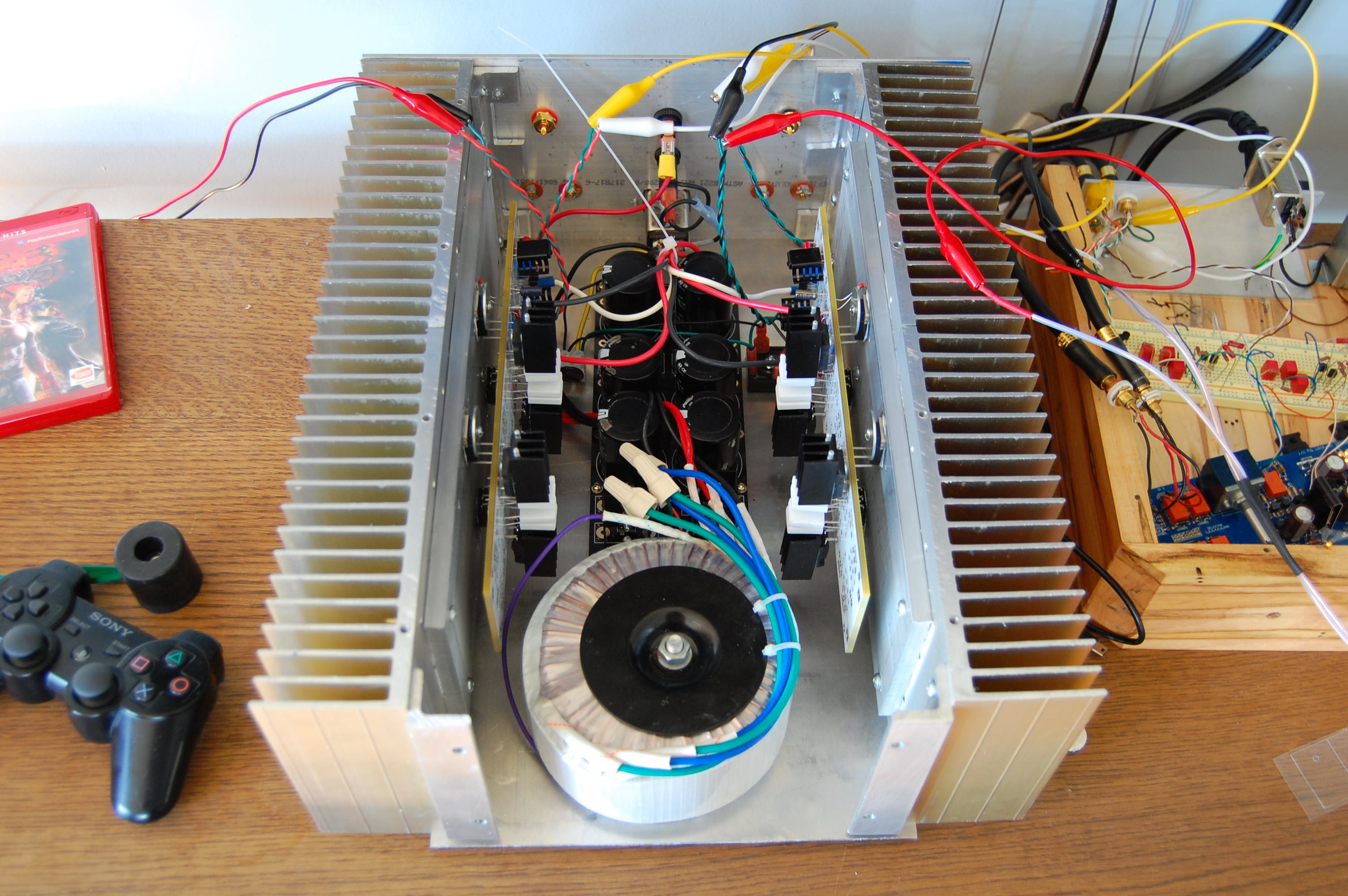

Check out the F5T board thread. You can see my buildout using Tea's boards. They are very well exceuted and more than adequate for almost all needs. They only lack the ablity to do dual mono. In truth, I haev an idea how to execute this if a standalone PSU is used.
Currently not much beyond what is in post one. Buzzforb has got some pics on the general thread of the production while boards as well, I can steal and port over here if needed.
I orginally purposed the board so one could use the available TO-220 FQP fairchild versions, since availablility of the actual Fairchild pair is limited, but Buzz has been delivering sets that work for that as well. If you run these as a version 2 or 3 with lower bias, you can get this into a 'normal' chassis.
Considering the lower bias point. Nelson runs his XA amps with higher output count and lower bias vs low output count and high bias. I hope to post numbers with 2 pairs at bias levels from the article, and 4 pairs with bias levels cut in half. All of this on a normal Class A amp frame, as TeaBag has suggested.

as discussed but not surely concluded in the other thread - I think the amount of bias might depend a lot on when someone goes into clipping during normal listening - will it possibily sound worse than with fewer devices or more at higher bias?
Myself, using as a bass-amp - I tend to not be able to notice the transition - but just want the raw current for transient power to 2x 15" woofers on each channel. But I would imagine a 3 way 82db full box would notice the transition if crancked up and would hear it barf on the midrange more. Keep in mind, this is the highest powered FW design AB design so far - so maybe as good as it gets for people with inefficient speakers they love.
The different amount of feedback and gain do make i sound as nelson describes it, a more relaxed but confident amp. It makes the normal F5 sound a little meth'd out by comparison.
Total bias will affect ultimate performance into tougher loads. My experiment is more about comparing the sound and measurements of 2 vs 4 pairs, with the same total bias.
