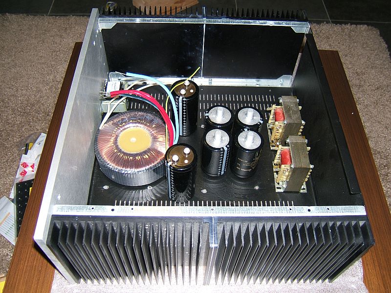

I just started with my F5 build:
Part1: getting everything in the case.

I already have a case, it's one from Hi-Fi 2000 , the heatsinks are 16.5 x 40cm and the front panel is 1cm thick aluminum, I'm planning to put some thermal grease between the heatsinks and the front panel, so that the alu front also becomes part of the heatsinks.
It looks like a good case, only the bottom need some reinforcement, that 500VA is heavy.

I know those boxes - great to work with and very good value for money! I wouldn't worry too much about conducting heat to the frontplate though.
What are the transformers for?
Those two red ones at the right are 10mH chokes for the CLC PS.
The one in the left upper corner is for the soft start based on this circuit:
http://www.diyaudio.com/forums/pass...t-standby-functions-your-aleph-amplifier.html
The soft start is done with a CL60 that will be bypassed with a relays after 5secs.

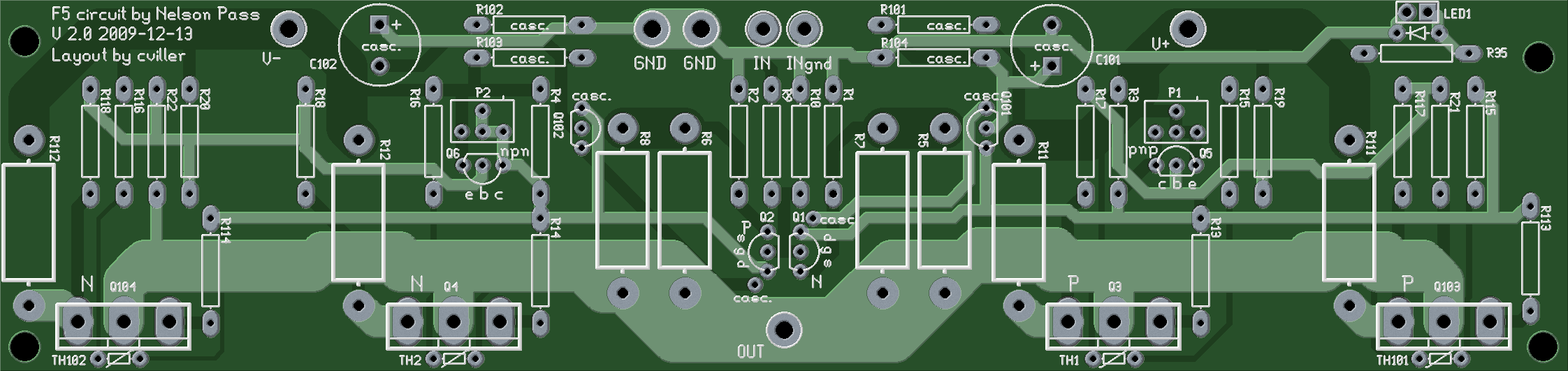

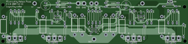

Not sure if you already found out, but the size is 190x45 mm and the hole spacing between the fets are 40-80-40 mm
I repaired a few boards for folks who purchased the component parts -- men generally don't read directions -- (in fact, the manual for one of my Hewlett Packard spectrum analyzers made that point, that if were reading the manual for the first time, something might be wrong.) I would suggest 2 mounting arrangement for the current protection transistors so that there's no confusion.
Do you suggest I make two footprints? I thought about changing the footprint to be correct for ZTX, but as you say, people don't read too much so I was afraid of causing yet more confusing. The reading thing reminds me of the simpsons movie: "I was elected to lead, not to read" 😀
It's pretty compact so there's not a lot of room on the silk -- you could overlap two devices (probably violating design rules for your pcb program) -- or affix a label to the packaging advising the purchaser that different transistors have different pinouts.
I send the Zetex devices -- they are a bit pricier -- but haven't failed me yet. Which are the transistors contemplated on your board?
I used BC550 and BC560. I don't like the shape of ztx, they are curved on the front side instead of the back side... but thats just me. 😉
However I could probably flip the footprints without causing an increase in confusion. I usually recommend people to get parts at your store, so it would make sense if the boards matched.
The BC devices are the ones Per Anders uses in his super regs so I have them for my own use. Perhaps, instead of the outline of the device, just "C B E" and let the builder take a look at the datasheet!
