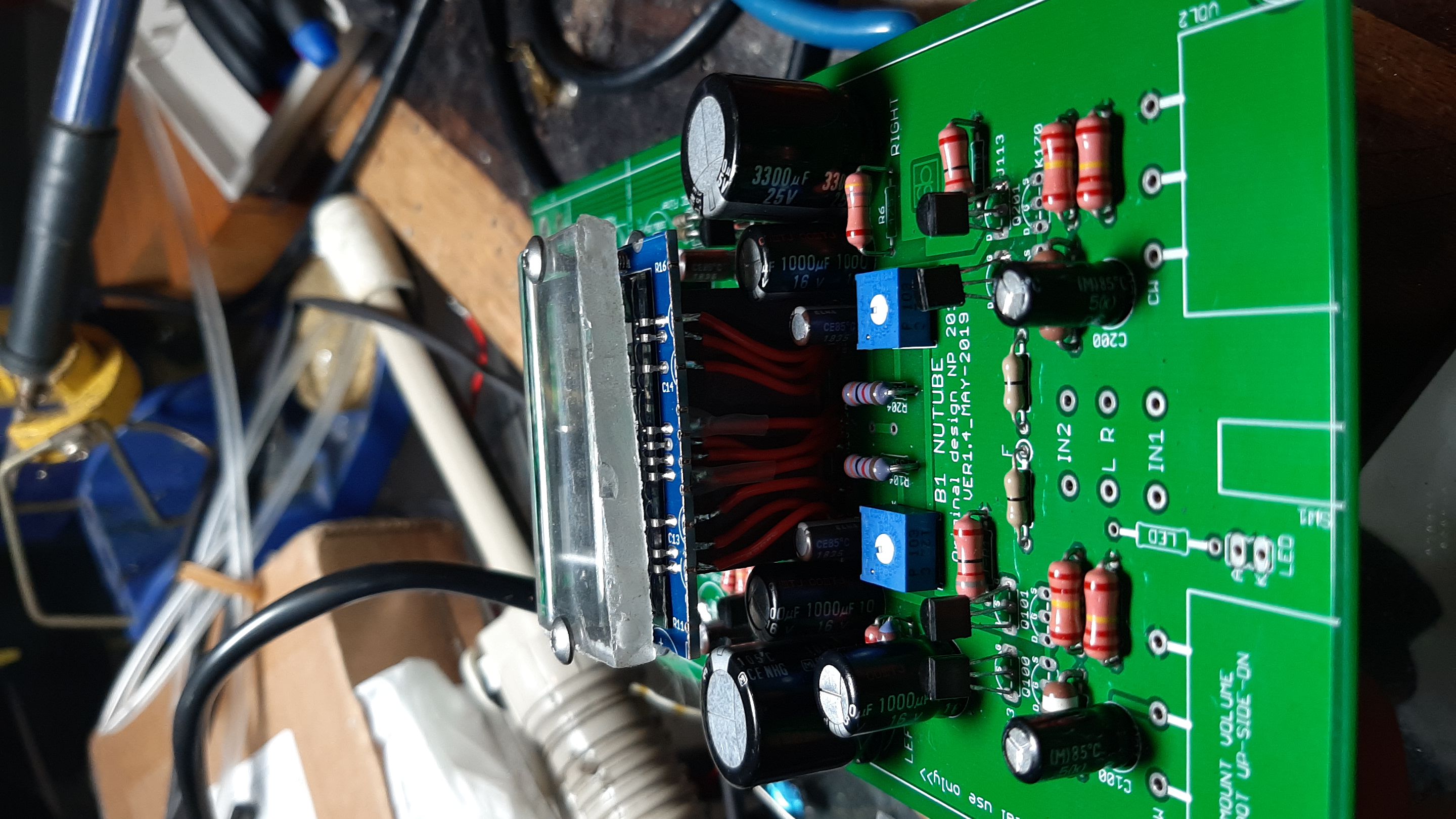

Also.... Regards to microphonic
. I was told by people. Who built..
Better to isolate the DC to DC. Mechanical vibration not recommended to be on same board.. Maybe long cable helps idk.
The korg B1 isolate is sometimes not enough.. Need find quite extreme ways to isolate.. Preferably air tight. Kinda similar strategy to build a microphonic tubes. Wood frame with copper is successful I was told. Use a heavy glass top or something.
Maybe some info wrong feel free correct

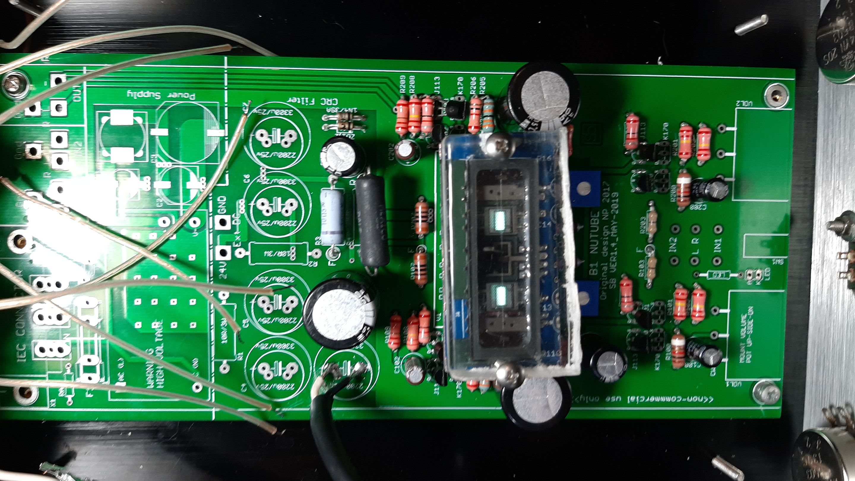

I've got my B1K finally powered up. All the voltages are correct. But when I connect it between my Brooklyn+ dac and power amp I first get music and after a short while I get a high pitch tone. Anyone any idea what could cause this?
Wonders still exist: the problem solved itself... Hope the problem stay's away, way too much problems in this world nowadays...
Well the high pitched sound is still there. Sometimes after switching on it takes a short time before it comes audible, sometime it takes more time (30+ minutes). The equipment is as follows: B1K connected to a Holton NXV500 r2. Source is a Auralic Aries G1 connected to a Brooklyn dac+ with separate PS and an Uptone ISO Regen.
Anyone any idea how to solve this?
Still ringing...
My brother had use these to mount the pcb and the ringing stops
Have you tried the magnet trick yet?
I tried putting a neodymium magnet on top while having my dmm connected to one channel. Voltage went up from 9,5 to over 13V, then I took it of scared to damage something. Do you think I should try again?
Will try to get some of those rubbers and try again!
Strange!
I'd try physical isolation first. Rubber grommets, sealed unit, away from speakers etc
Don't see any reason why not.

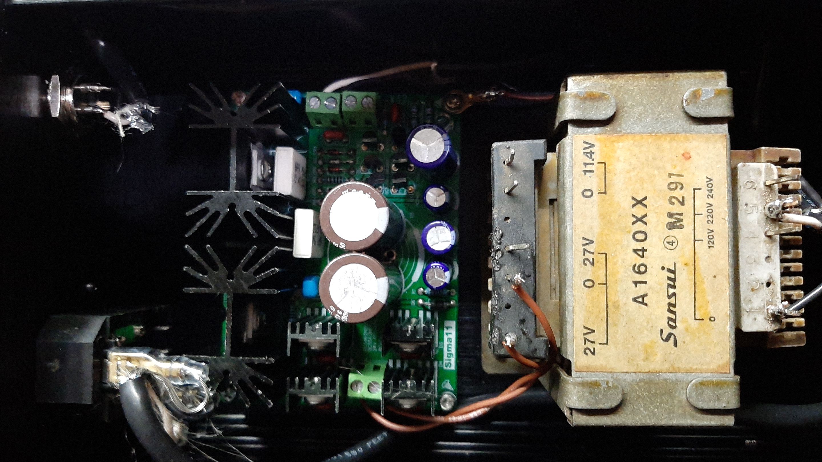

I'd pull the fuse just to make sure AC power doesn't get connected inadvertently in the future without the SMPS module.
The ground will become floating at your new SMPS GND potential, (you lose the path to earth potential without the IEC lead), so you may encounter hum when connected to other earthed equipment, but see how it goes.
If you insert 24v into the +V pad (where the on-board SMPS goes), then you can still have the CLC filter, but the filtering is already pretty good after the 'optional' point, so maybe not needed.
It will be easy enough to try with and without CLC to assess performance.
