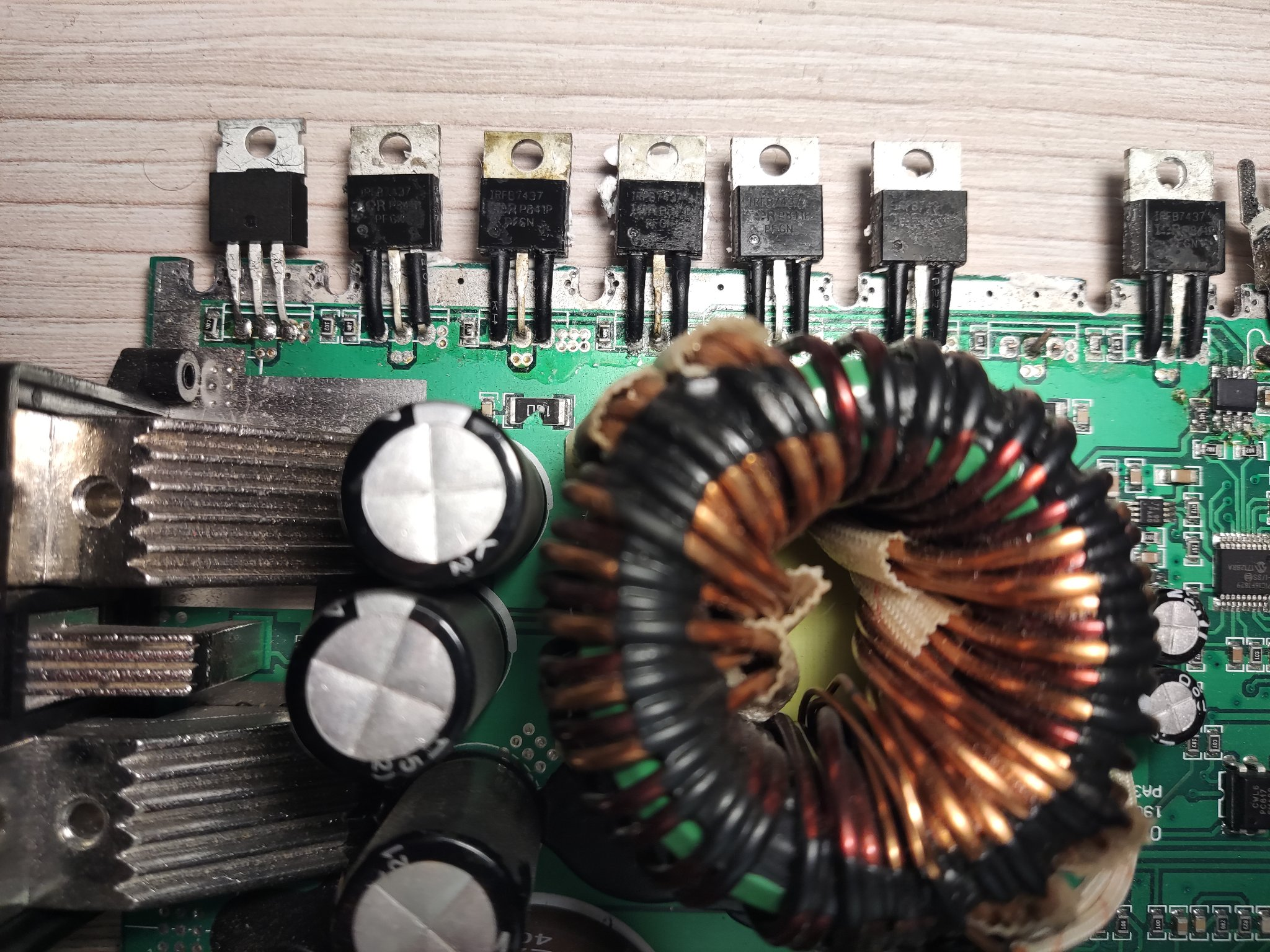

Hello, a year ago I made a post where we tried to diagnose this amplifier without much success. Since then I have gained a little bit more knowledge and an oscilloscope.
Recap of what has happened:
Amplifier suddenly started going into protect, we suspect a loose battery terminal was the cause.
One IRFB7437 MOSFET was shorted (no idea if PSU side or output side, compact amplifier so I can't easily tell)
The driver 27324 also was dead and a resistor on its VDD. Also a few gate resistors were burned up.
After replacing the FET, driver and resistors, it just killed a different FET (because PSU was a battery, aka no current limit)
Middle pin of rectifiers is disconnected.
Info and equipment:
I will be able to diagnose more only during weekends.
PSU is a 12v 5A adapter, but can shut off due to overcurrent around 7-8A.
Multimeter Lovrum T28B
Oscilloscope ZEEWEI DSO1C81
Soldering iron
Current issue:
There was a bad solder joint on the driver, fixed that and now it seems to power on and go into protect properly, without being interrupted by the PSU shutting off, but some component is making a whining noise
The whining noise in question:
Board pics in attachments.
Measurements:
All gate resistors in spec ~4.7ohm
27524 driver: Works, all gates get a solid 25khz square wave
IRFB7437 (same on all of them, scope negative on ground):
Gate:
Drain:
Source: Nothing
I assume it's just the scope bugging out on the Gate measurement.
IRFB4321: nothing, I assume that's the output side which doesn't work because rectifiers middle pin is disconnected.
There is a blown up resistor in the middle of the board, unsure of its function, my guess would be a bleeder resistor, but there is a 2nd one intact.

That's just a snubber circuit. Not critical for operation.
Does it make that noise with the rectifiers in the circuit?

What caused the snubber resistor fail between the lats thread and now? Or did it simply get broken from impact?
The rectifiers middle pin is disconnected, havent tried fully removing them or connecting the middle pin. In about 11 hours i can test different configurations of the rectifier
Previously when there was a bad solder joint on the driver, it made the psu shut off due to overcurrent, now it doesnt do that anymore and the amp can go into protect mode without any voltage drop on the psu, stays at a solid 12.1v.
I dont know what caused the snubber resistor to fail sadly.

Does this amp have any sort of LED blink code to give an indication of the reason it's in protect?
Do you have a mains incandescent lamp or some other limiter (large 4 ohm resistor, like those for dummy loads) that you could insert with the output of one of the rectifiers to see if that would allow the amp to power up enough to troubleshoot more?
It just constantly blinks power and protect LEDs
I don't have any limiter I could use to connect the rectifier to the board.
I guess the most obvious thing to do will be finding what's making that noise, possibly that has something to do with it going into protect.
Some regulator circuits become unstable (do strange things) when their connection to the rail voltage is broken (rectifiers out of the circuit).
You don't have any dummy loads or any other large resistors?
No incandescent lamps in any small table lamps or anything else? Halogen work lights?
I remembered that cars have lights that could work for this. Right now I'm going to sleep, in the morning I'll take one and hook it up
Found an mains incandescent lamp, DC resistance about 87 ohms
Connected it between the middle pin and the board, but on the middle pin of the rectifier I connected, oscilloscope didn't read anything, but on the other rectifier (middle pin still disconnected from the board) it got a reading
FMG33R connected (probe on FMG33S middle pin):
FMG33S connected (probe on FMG33R middle pin):
Still whines and goes into protect.
Connect the negative rectifier normally and install the lamp between the output of the positive rectifier and the board.
Connected FMG33S normally, connected lightbulb to the FMG33R.
FMG33S middle pin doesn't read anything
FMG33R middle pin:
FMG33R middle pin:
