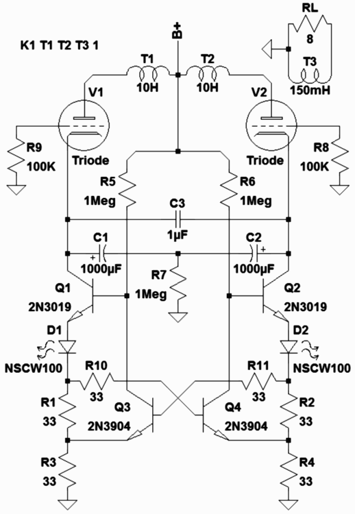

Yeah, you can certainly abuse Garter Bias to
precisely match CSS, keep the toroid happy...
Last I visited this I was mostly interested in
Class A. I hadn't really thought how to deal
with AB2 currents... But as long as the grid
and screen currents all draw in parallel with
the plate on the same side of the winding,
should be OK.
Return the drain of your source follower drive
to plate, your AB2 current is all accounted for.
Same thing with your screen Regs...
Garter should see same currents as the toroid.
Even if you just garter on the tube cathodes,
prolly don't need all the sand I've thrown at it.
This is a very slack drawing, not checked for
errors. Take with a grain of half baked salt.
You want bypass caps to GND instead of the
bridge between the cathodes for AB anything...
Wasn't properly thinking AB when I drew that.
Thanks for the input. I looked at your schematic and it was really interesting. Instead of using two dividing resistors per side as in the original garter design you are using one ccs per side each modified by a transistor crossfed from a resistor network below each ccs. I think I get it. I also think I understand why you would have to use 2 big caps to bypass the whole shebang on each side to allow for variations in current. There was a related thread, that I started that I can't seem to come up with now, where separate floating power supplies and some gyrators were involved. I never really understood that idea and I never want to build something I don't understand. It also offended my KISS sensibilities. This idea makes a little more sense too, maybe my own limitation regarding excess complexity.
I think your idea of putting the mosfet drain and (possibly) screen supplies through the OPT input winding might have a lot potential. I never thought of that. I will have to think on this.
Thanks Poin for any help you can round up also. I think I'll need it.:eek:
Eric

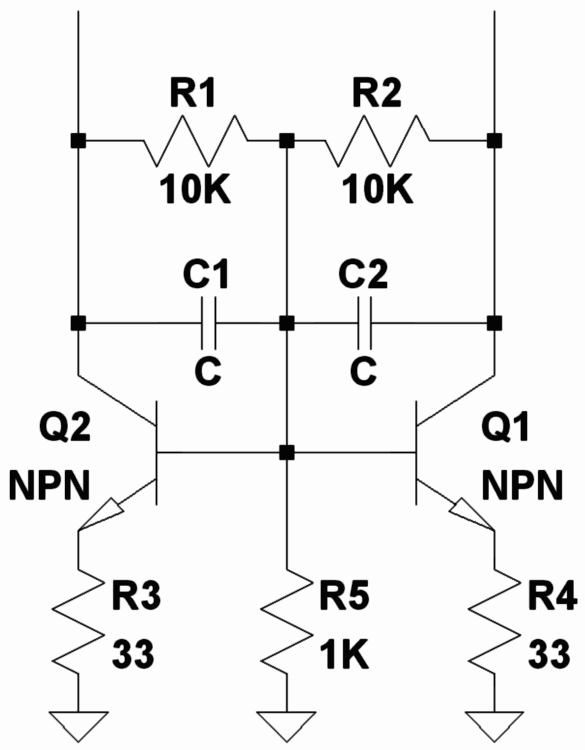

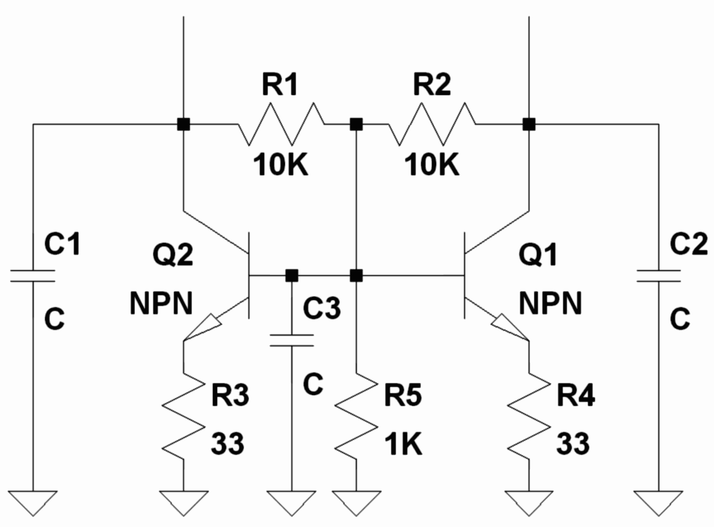

Its not Garter like you wanted. But maybe will do the trick?
Compromise between VBE multipler (fixed voltage) and current mirror???
The second gyro based is either genius or sheer idiocy?
I've been drinking, so there really no telling...
My vote is for idiocy.
I'm not up to running a full sim right now...

Thanks very much to all for the help. Apparently this was a problem that was ripe to be worked on. I think the current mirror idea is much simpler than a servo system. Great minds seem to think alike so I think I will take that cue from the small majority here and try to go in that direction. I think I can deal with this level of complexity.
