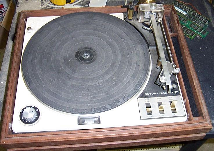

I rescued a TT from the dump today. It's an old Garrard Zero 100 looks- to be fully automatic.
Has anyone had experience with this or similar? None of the auto stuff works and I don't care. I can get the table to turn just fine though. Do you guys think this would be a nice deck with all the auto goodies stripped and a decent arm attached?
In other words, is the core of this thing worth putting a little🙂D) time into?

The trashed dustcover went into the bin but the tt is with me. I have a lot going on now - this will give me some time to think what to do with it. This is the idler model, by the way. The plinth is real wood.

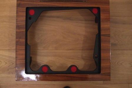

This could be a perfect donation table to a re-plinth such as the one I did on an old Sugden Connoisseur...CAD $35 if I remember correctly.
Nanooks dumb ask replinth
A "Winners" (that's TJ Maxx or similar in the US), Asian Hardwood cutting board for CAD $10. practice arrow for the shaft, 2 for CAD$3, some junk wire and a piece of scap aluminium, an old pen refill, a 1/4" pipe plug, and some junk parts off a beater turntable (junk Realistic or similar), and four marbles for feet.
this is my cheap $2.19 DIY tonearm. If the bearing is buggered, then a bearing would have to be sourced.., but that can be done on the cheap too. Have a listen to the turntable while it is spinning with a stethescope, thatt'll tell you if the bearing is shot for sure.

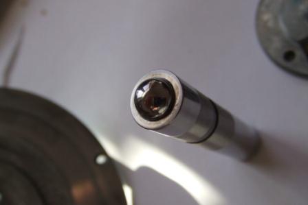

This picture shows the new inverted ceramic bearing.
And there is so much more.
All changes are easy to make and without changing the looks of this great looking TT.

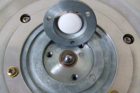

Your iverted bearing looks very interesting and simple. Is it just a steel ball on top of the centre rod and a ceramic plante in the original small round plate that is attached to the centre of the subplatter? Which parts of the original bearing did you junk?

To make a inverted bearing is quite simple, I have done this without any CNC-mill. Just saw about 4mm (there is already a sleeve there) of the central bearing, drill a 7,5mm (3 mm deep) hole in it and place a 7,5mm steel ball (no glue or welding needed) in it. The only difficulty is getting a piece of (technical) ceramic from the right size (I was lucky to get it, look at a jewelry shop). Actually I am now using a thinner piece of ceramic with a glass-Teflon coating, silent as a baby. Stick the ceramic bearing with some double side foam tape on the top plate and that’s it.

Your bearing design is simple and brilliant. I'm definitely going to try it. By the way is your ceramic plate alumina (Al2O3) or something else? I might try a ceramic ball with a teflon plate if I can't get my hands on a suitable ceramic plate.

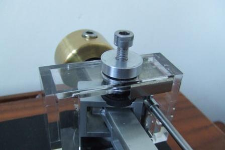

Concerning the arm: to me the geometry seems all wrong. Anyone familiar with General Motors "A" body cars of the late 1960's to early 1980's? The problem with those cars is their rear suspension, unequal links controlling the location of the rear axle. By changing the geometry things really improve. I think the same can be said of the arm on this table.
The arm and the link that keeps the headshell pivoting as it moves across the record have different lengths and are not parallel to each other. If the location of the pivot (for the "trailing arm") can be moved, and the link length changed, then this arm should track as though it were a true linear tracker. At issue also is the quality of the bearings used for the pivoting portion of the arm. If the slop in the fit between the pins and the bearings can be tightened without increasing the friction in the bearing, then the second issue in the arm can be taken care of.
