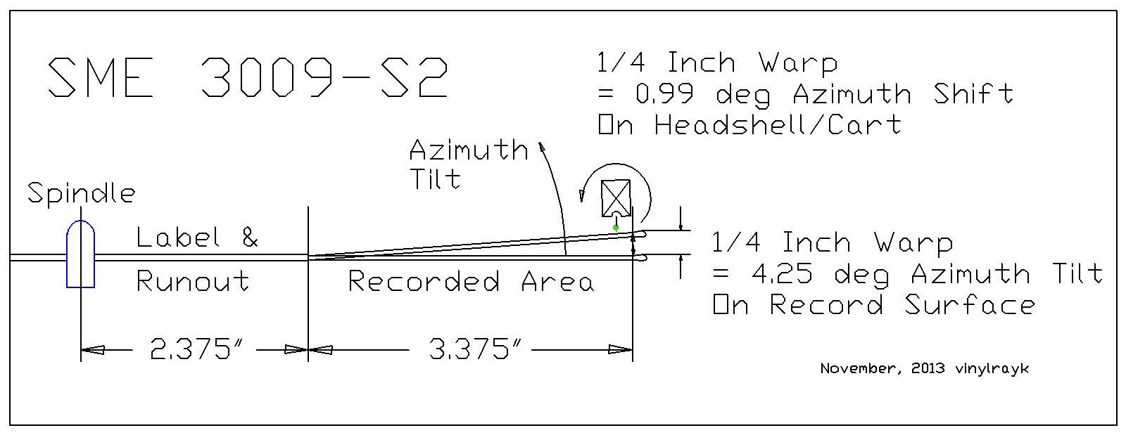

I can disagree about that for one reason...There is more azimuth tilt in the warped record surface itself than there is from the vertical pivot orientation of the arm tracking that warp. The relative azimuth tilt will of course depend on the profile of the warp and the arm pivot design but, on average, the azimuth tilt introduced by pivot orientation helps compensate for some of the azimuth tilt in the record surface. So, the azimuth tilt that results from pivot orientation can actually be beneficial.
Suppose the warp did not have a tilt as you show in that drawing, and the warp was more towards the label/spindle, as it can sometimes be.
I've had a few records that way, a "bubbled up" area.
Then why aggrevate the situation with a perpendicular pivot as in galu's Technics?
Bottom line I think is to stick to the angled pivot design

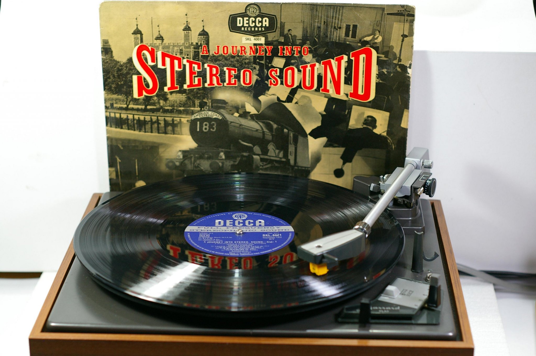

Indeed, "record changers" always used that style of pivot mainly because of stacking records adds height.Wiseold, I'm delighted to see that the vertical pivot axis of my vintage Garrard SP25 MKII is not perpendicular to the the arm tube.
However, it's a fiddle to get the removeable headshell to line up square to the platter!
And notice, the Technics 1200's and other "higher-end" single-play used that technique as well.

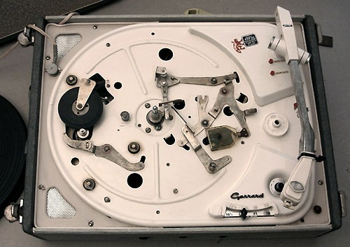

Indeed, indeed! The Garrard SP25 MKII is simply a stripped down, single play version of the Garrard AT-60.
Indeed again..... I've serviced every model of Garrards through the years.Indeed, indeed! The Garrard SP25 MKII is simply a stripped down, single play version of the Garrard AT-60.

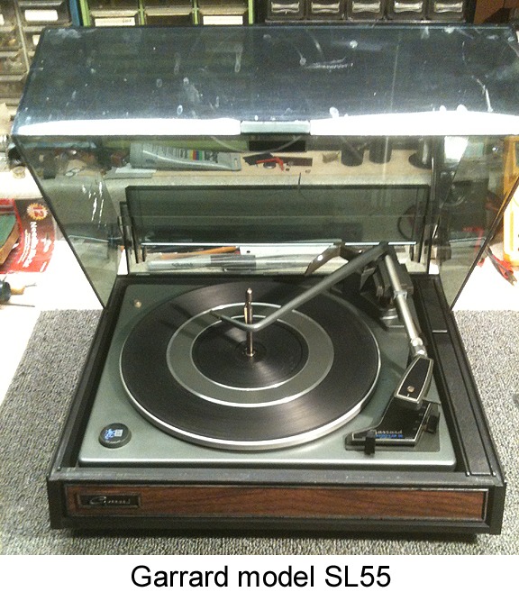

Recently sold off a SL55 on craigs list for $99 - fully restored of course.

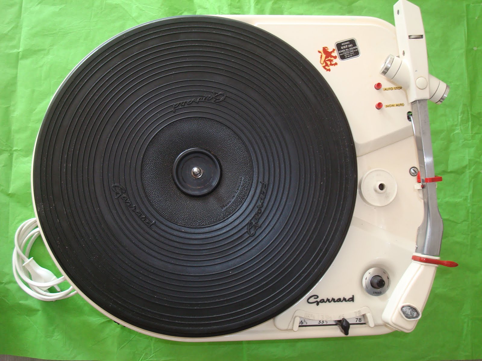

And notice.. the angled vertical pivot? 😉I once had a Garrard 4HF, which I believe was released subsequent to the Garrard 301 in 1957.
It could amost be described as a Garrard 301 with an integral tonearm!

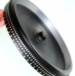

The mass of the turntable platter...
Of course, a high moment of inertia is what you want in a turntable platter when it comes to maintaining constant angular velocity.
Refer to the attachment and note how the mass of the Garrard 301 platter is concentrated at the rim, resulting in a high moment of inertia.
