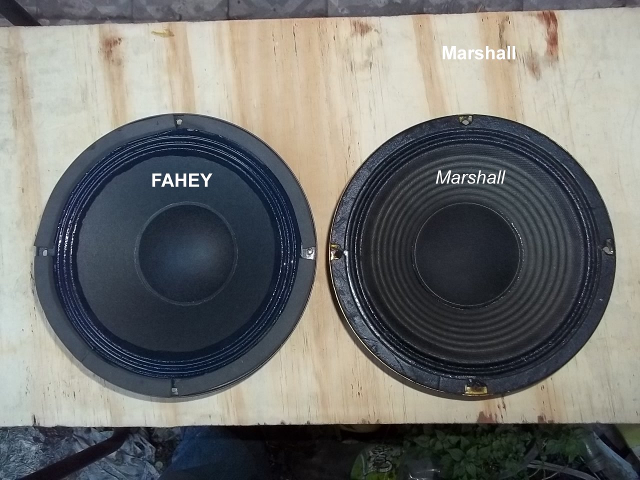

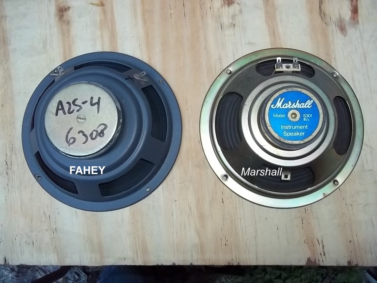

These are a few of them, I make from 15" Bass woofers to 4" high power cone tweeters and everything in between:
12" Guitar speakers, Fahey on the right,compared to equivalent Celestion on the left, then front and back of 8" Guitar speakers, again side by side with the Celestion they replace (Musicians pull those to install mine):
