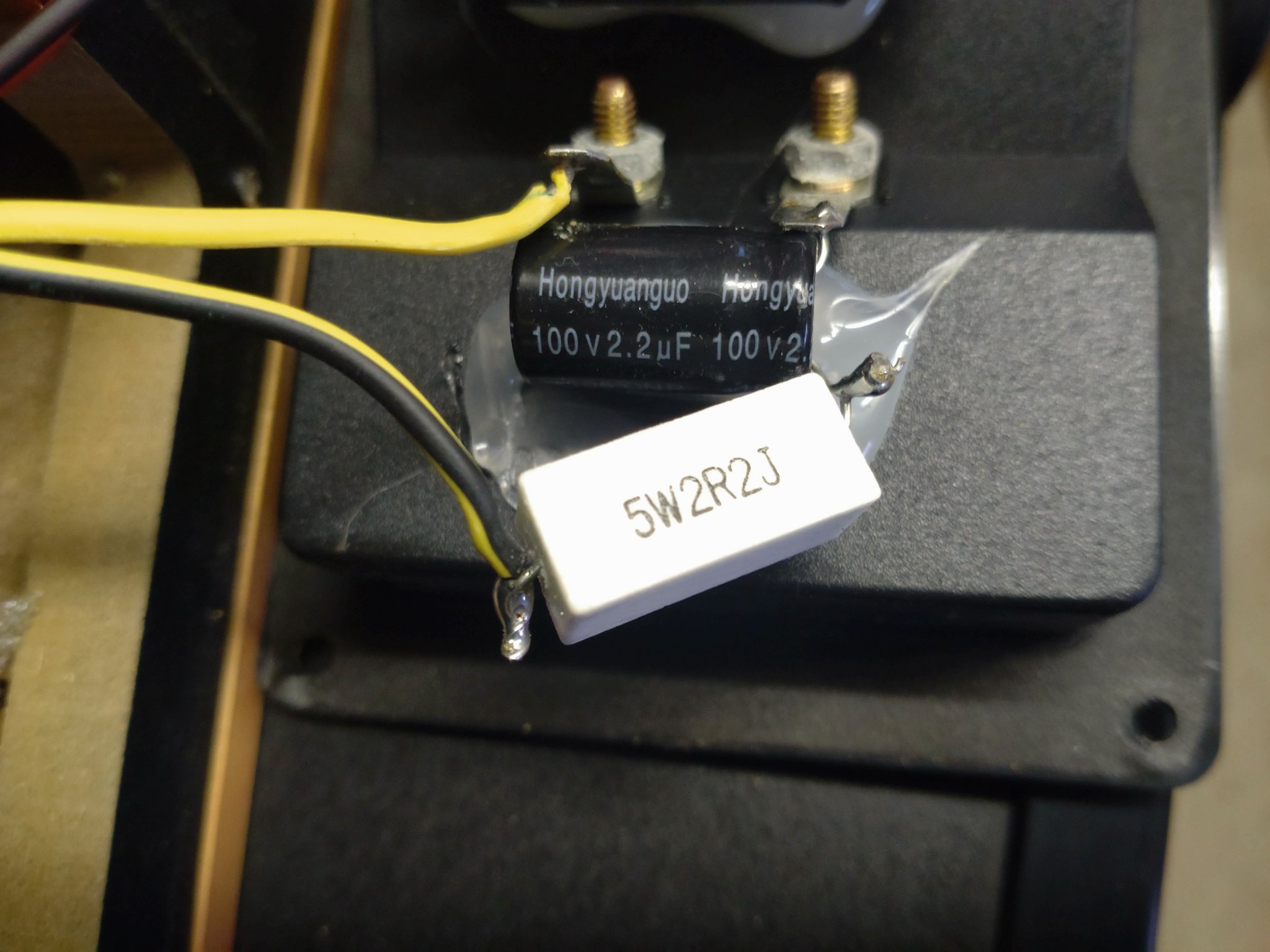

Recently collected a free set of Gale Gold monitor mk1 bookshelf speakers which came along with an amp I was after. Having read the reviews for these speakers the suggestion is that they are decent budget speakers, let down by wayward treble. Connected them up (bi-wired) to a Cambridge audio a300 amp today and they definitely lack sparkle. At low volume I put an ear to each of the tweeters in turn and swear I could detect very little coming from the left, and nothing from the right. LF drivers seem fine. Disconnected tweeters and both had a resistance of approx 6ohms. Then went to look at resistor and capacitor for each tweeter. I don't have a dedicated meter to measure capacitors, however on the ohm scale the left speaker cap started at approx 10megaohms, then climbed steadily. On the right speaker the cap started at 30megaohms then climbed steadily, although did go open circuit on one measurement attempt.
Duff cap/s perhaps?
Has anyone upgraded the tweeters/resistors/capacitors on Gale Gold Monitors to a successful outcome? If so, which components did you use?
The reviews would appear to bear some truth about HF being wayward but I'm unsure if that's what I'm experiencing, or if I have other issues with the capacitors.
Should I replace the caps, and if so which would you recommend? If you have upgraded to better the treble and bring it better into sonic control, I would be grateful if you could share the detail please.
I'm handy enough with a soldering iron and multi-meter, so, happy to have a go at fixing/upgrading as necessary.
Thanks in advance for any advice you can offer.

Dried out ferrofluid can prevent a tweeter from tweeting so you may have to look for suitable replacements.
Changing the capacitors, which are probably electrolytics, to non-polar film types would also be on the cards.
If you have a small transistor radio with a headphone output, you can test a tweeter by connecting it directly to the radio.
Keep the volume low and you won't damage the tweeter, but you will hear if it is working.

There is no need to change the resistor.
Your technique for testing the tweeter is sound.
Like planet10, I suspect the tweeter may be a version of the Audax tweeter which was popular in many budget speakers such as the original Wharfedale Diamond. If so, the tweeter includes ferrofluid, and I can vouch for the fact that this thickens over time and hinders the operation of the tweeter.

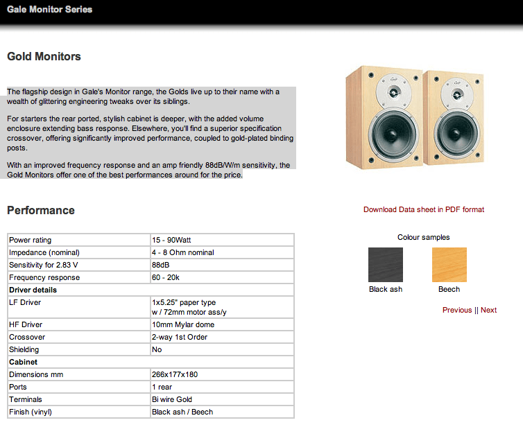

Your Gold, at 180 mm deep, has slightly more bass extension than my Silver, at 163 mm deep. Otherwise both appear to contain ithe same components.
And there is an inductor in series with the mid/bass speaker as shown in the attached Silver crossover.
Both have a 10 mm mylar dome tweeter - the bezel on my Silver tweeter is black, not gold.
I have also attached the specs of the Monitor Gold Mk.1

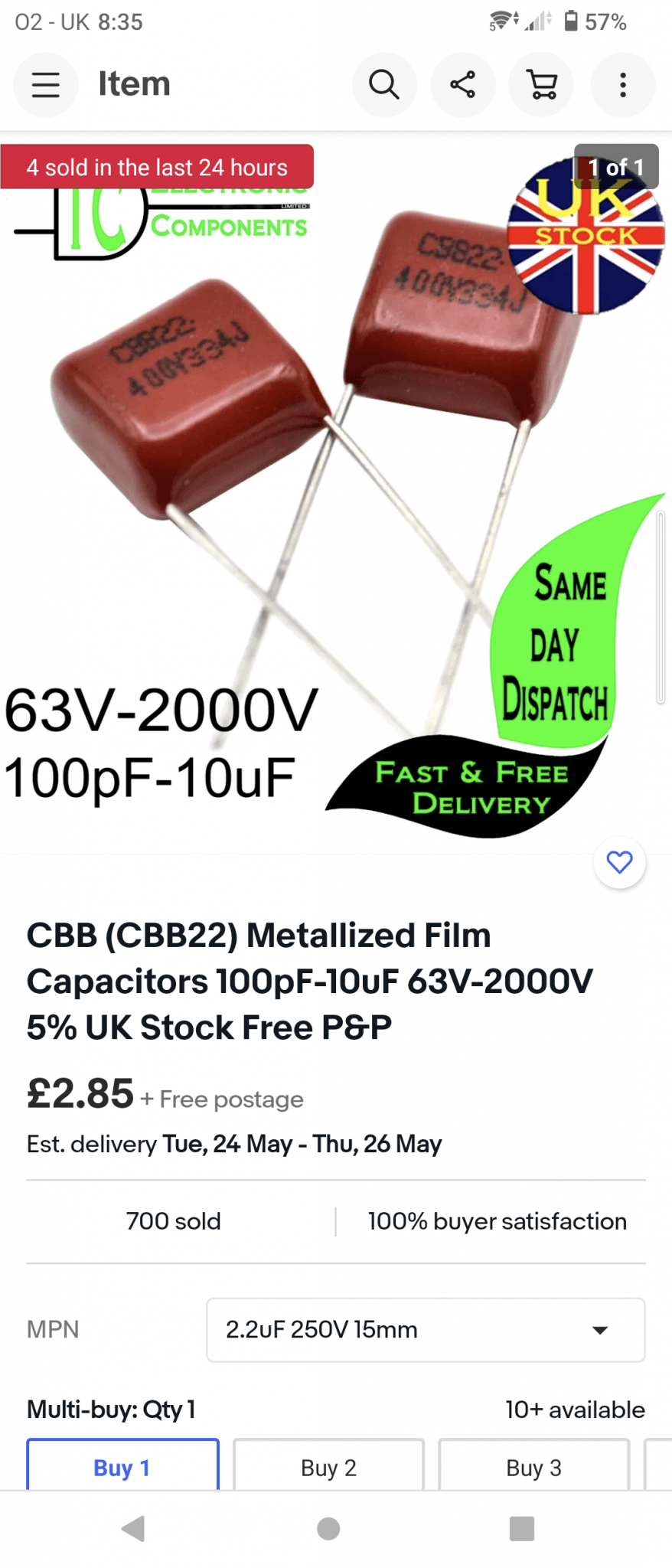

So much choice for film Capacitors........does the voltage rating matter, if higher? I've had some recommended as per attached pic......would these be good to replace existing electrolyte caps? The 2.2uF are rated 250v... current ones are 100v Are they bi-polar?
