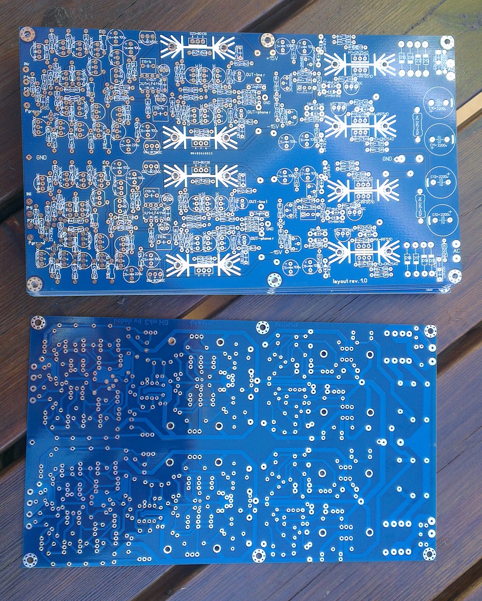

That is good idea, I will prepare the parts list soon.
By the way the boards are on the way from China.

By the way, the boards somehow are held up at the Customs office here in Croatia (still slow bureaucracy from Yugo time). I have to pay some Customs duty, and hope I will have the boards this week.

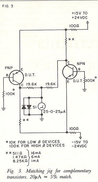

J111 (50pcs) J112 (25pcs) bc 549c bc559c diotek (1000pcs total) just for fun. Got Soome 23 years old philips bc550c and 560c in a box. Fairchild about few hundreds , I got a toy the atlas 75 dca pro . What circuit do you use matching the transistors?
I use this for complements.
Yes, thanks for testing jig plans - need to start matching as well. Do you have one for matching JFeTs?
You don't need to match jfets for this preamp.
Just choose Idss you need. to do that connect the gait to the source and then connect 10V DC between a drain and a source(+ to the drain if nfet) and measure Idss.
