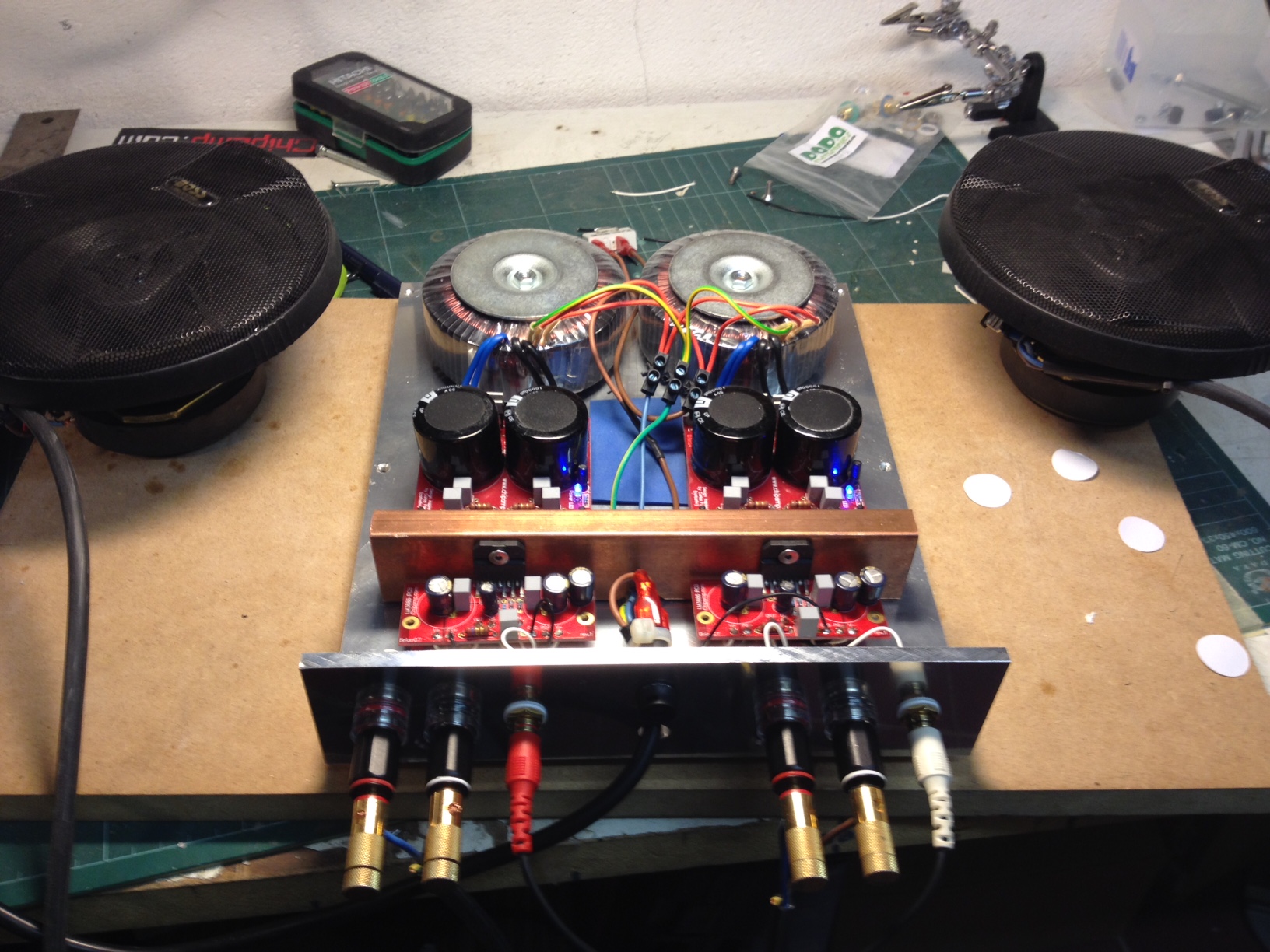

Andrew, I have no idea 😕 Bass is lush, warm, punchy, I love it. So, I probably misunderstood the "shouty" bit. To me it sounded like "the highs will shout". Sorry. I am a total nooob. In any event, the sound at normal listening levels is great. If I could tweak the treble at high volumes, I would do it but most of the time I listen to music at low levels.
I don't think it is clipping because the "harshness" is halo-like, i.e. it is evenly spread around the soundstage when volume is around 60-70%
The speakers are KEF LS50's. I am not sure is this is to be considered a "reactive" speaker.
Internal cabling is silver plated copper Olflex 260. I read somewhere that silver can add harshness but I don't really think such short runs could have any influence at all.

After some more critical listening at higher volume levels I did find the sound slightly "harsh" in the upper frequencies and with denser types of music like Bombay bicycle club.
If the power decoupling caps are too small, there's not enough coverage for signal, resulting in a harsh tone as the amp plays louder. The 100u amplifier board power decoupling caps provided with the chipamp.com kit, are too small. The value is not even plausible for full bandwidth operation with that chip.
So, if we were to crank that up as loud as it will go, the tone *may* be overly similar to an auctioneer directly after a breakup with her boyfriend (or, in other words, a bit off-putting).
This problem can be a lot like a car starved for gasoline, climbing a hill, and suddenly suffering pre-ignition overly advanced timing issues because shortfall of gasoline pressure has made the mix go wrong whenever the engine is heavily loaded. Likewise, an amplifier with a decoupling shortfall will sound like the stability has slipped off the mark whenever you crank it up.
Could this be in part because of the tiny decoupling ci on the Amp board ?
Ci is not a power decoupling cap. Ci is a signal coupling cap (typically the inverting input coupler).
It performs as part of an RC, so the attached resistor value also has considerable importance when it comes to the getting the right size cap.
Ci's size will affect the bass harmonic thud/boom balance.
Sizing:
Far too small = bass blocker and/or loud midrange
Slightly too small = warm/boomy/blurry bass
Just right size = no distortion
Far too large = cold/thud-only bass
The cap included with the chipamp.com kit is Far too small.

If the power decoupling caps nearest the chip are only 100 uF, try changing them to 1000 uF or so. And if there are also smaller decoupling caps, such as 0.1 uF, they could be increased to 1 uF or more, as long as the lead spacing is not larger than the original ones'.
Hi, Just to resume the sound of my current build:
At low to mid volume the sound is fantastic. Bass is perfect, mids and highs very detailed and clear. At high volumes (just a little difficult to understand someone talking next to you) the mids and highs seem to fuse and become a tad harsh especially with denser types of music. Acoustic stuff still plays nicely but there is a little bit of an edge 😱
I did try and find the replacement capacitors at Digikey but there are so many different types that I got lost within a couple of minutes. Could someone knowledgeable point me in the right direction and tell me which capacitors should to be swapped ? I gather, that they are the ones around the chip. But as I said, for instance, I couldn't find one with 1000uF/50v. The only ones that came up had 500v and cost more than the entire build 😱

The sound you are discipling could also be caused by the thermal protection build into the LM3886. Did you use thermal past?
Did you twist together the leads between the PSU and the amp boards?
Here is a 470 uF Panasonic FC with the same lead spacing and case diameter, it is the highest value FC capacitor of the same diameter.
EEU-FC1H471L Panasonic | Mouser
The LM3886TF chips have no thermal paste between them and the large copper bar they are screwed to. I was under the impressions that the "TF" version didn't need paste.
The leads between the power boards and the amps are in parallel, i.e. not twisted as you suggest. They pass below the copper bar.
Maybe I should start by applying some paste an twisting the wires before looking any further.

All hard surface Thermal Interfaces need some compound to exclude air from the interface.
Only the soft Thermal washers allow for a "no Thermal Compound" interface.
The TF is even worse because it has the extra thermal resistance of the plastic package on the back plate and air in the interface.
Twisted pairs is an interference attenuation tweak. I recommend this tweak for EVERY Flow and Return Pair. No exceptions.

The LM3886TF chips . . . I was under the impressions that the "TF" version didn't need paste.
That impression is not factual.
It does require thermal paste.
Plastic to metal interface is optimal with Arctic Silver; however, that is conductive (has to be applied with care to avoid shorts) so I would prefer to use Arctic Ceramique or GC Type 44 thermal paste, which works extremely well and is non-conductive.

If an LM3886 is used in non-inverting mode, stability, layout and cable routing is of great concern as it applies to heat output.
Speaker load is also of great concern and this matter is affected at HF by adding the full Thiele Small output parts, such as the often forgotten inductor parallel with resistor output parts, which could possibly result in a happier amplifier that runs slightly cooler.
RF control parts can also reduce extraneous workout thereby reducing heat.
If your various stability measures have indeed worked, the amplifier will run cooler and possibly/probably output a more pleasant and useful tone to the speaker.
OR, if the stability has gone badly, the possible ugly tone consequences could be of at least as much concern as the extraneous waste heat output. Various language to describe the unfortunate tonal consequences of instability includes: "Harsh" "Edge" "Shouty" and "Forwards" all of which are most likely to indicate a problem with the insufficient stability and/or insufficient decoupling, usually both.
Ear tomfoolery: Unstable amplifiers can image amazingly well, but with such an impractically poor tone that cranking it up can be unpleasant. Those functions typically conflict; so, try for a useful balance between those two audio functions.
Adjustments that improve the tone without reducing the imaging performance do happen to fascinate me, but not for long, since it is a very very short list. Not surprisingly, the locales for that sort are input impedance, output impedance and better quality decoupling.
After the layout and cable routing and RF-reduction work has been completed, and after assuring that the power decoupling is in working condition, then remaining stability control for a chip amplifier is the gain setting, as in gain comp, which can be done simply by changing the gain for the entire band (very easily done, but may accrue the cost of needing cleaner power, which is most easily done by better working decoupling that may, at worst, inconvenience the layout) or a more complex measure can be done by changing the gain for only non-audio pitches. Compensation is not a spot to begin, since the eventual optimal setting is affected by everything else. The gain setting is not there for your convenience with an arbitrary figure; so, for best quality results you'll need to dial in whatever gain setting happens to result in optimized output quality, done fairly close to the finish of the build.
Compensation, especially gain comp, can reduce imaging performance in trade for a more practical tone, and that seems almost a crime until we remember that practical output is mandatory. This is a good enough reason to do everything you can to reduce the need of compensation prior to actually doing the compensation work. For example, be sure to use AndrewT's ideas on filtering, decoupling and cabling before you adjust the amp compensation/gain directly.
Although there are many ways to combat a stability difficulty, the fastest and easiest way with a chip amp is to use inverting mode; or, in other words, you're far more likely to have extra labor for stabilizing when a chip amp is used in non-inverting mode (unfortunately that is the case with the majority of kits). If it so happens that your stability efforts have not resolved stability/heat/tone difficulty, leaving you with the need of a more practical amplifier see Decibel Dungon for an inverting solution: The Decibel Dungeon Gainclone index page with links to all chip amp articles. That will be faster and easier than a long fight with a kit.

I have applied the paste to the chips and yes, they run much, much, much, much,... cooler 🙂
I also swapped the pre-amp. I reintroduced the preamp of a Yulong DA8 DAC and now I can push the volume as hard as I like without getting the feeling that something is wrong. The passive LDR pre I was using was superbe with my Quad 306 but I think it is not a good match for the LM3886 which seems to be less forgiving than the Quad 306.
So, these first steps have made an enormous positive change. The edginess has disappeared and I can push the volume much harder. The soundstage is almost scary !
I will implement the other changes like the bigger capacitors, winding the cables , etc. in the near future. But I must say that I am extremely happy with the sound at the moment.
