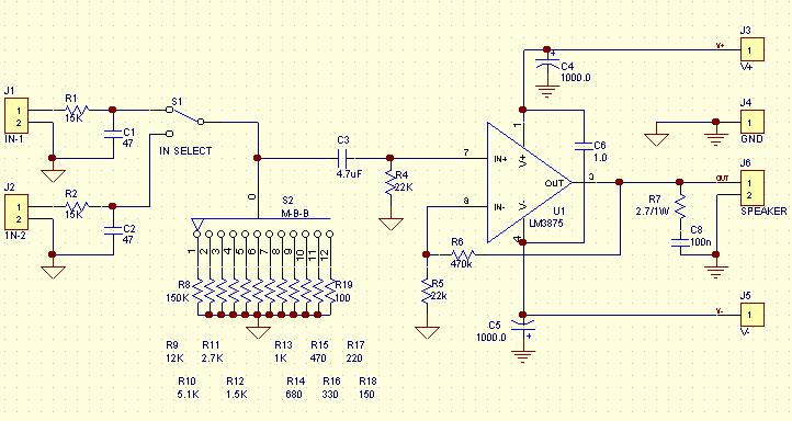

Thanks,
This guy Peter, raised the standards so high and I don’t want to just shove the parts in anything that I can find. It has to look good seating on the shelf. So far I can’t find housings for the two toroid transformers and I’m stuck. I’ll show some pictures as soon as I have something ready.
That’s the sch. and I’ll be playing with the values of R5,R6. Keeping the ratio I’d like to see what the lowest values are that will give me the lowest DC offset. I may try it without C3 also but then the offset is going to be worse off. Mind you 30 mV DC over 6 Ohms is 5mA more/less imbalance of the output, so I don’t know if I should be concerned about that. It's the same as having 6k resistor from output to -V (-30V). The PS is 2 traf’s 220VA/2x22VAC and 2 bridges each. As soon as I have it working I’ll report.

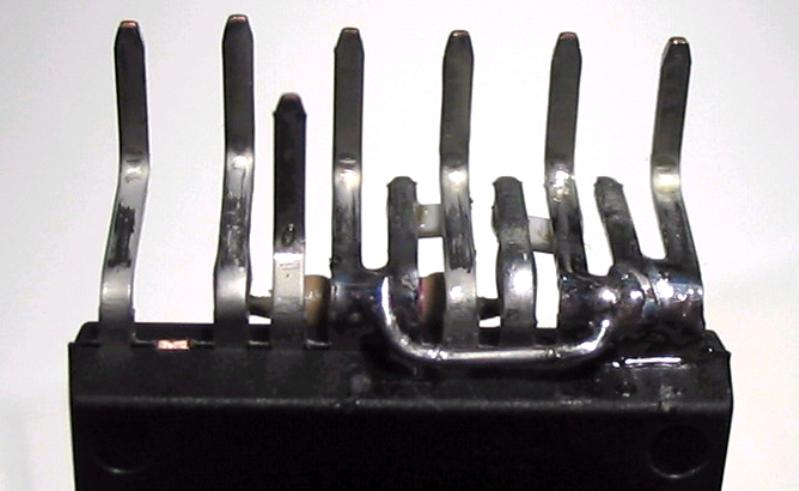

While there is nothing wrong with tweaking for lowest offset, you should be also aware, that changing the resistors values and adding/removing certain caps will also influence the sonic signature of the amp. Sometimes it's actually better to accept some offset, than having close to 0V at the output at the cost of compromised sonics.
Personally, I don't even care if the offset is aroun 60mV or so.
Peter,
What is your gut instict regarding surface mount resistors?
I notice that they're used in that Rowland amp and thought it
was interesting in the pictures posted in this thread by Greg.
...maybe they're only good for mass production amps built with
PCB's? they are so tiny! How can you be sure you don't burn
them up while soldering! Just wondered if you had ever
considered them.
(just another variable to throw in to the circuit!) 😉
considered them.
To tell the truth, I never used them before. They seem appealing though, as one might think that their sonic signature disappears with the size, but somehow I don't think it's the case. Worth trying though. I wouldn't worry about burning them.
Peter,
You are right about putting the sound first. I just wanted to se how low I can get on those two values and have a very low offset. I know that high FB res. would generate more noise. My gut feeling is that I'll get down to 5K/100K and single digit mV offset as I THINK I'll have the best sound , BUT as you suggested I have to listen and than decide. Mind you, my years are not as sensitive as yours and if I don't discriminate between the two settings I'll go with the safer (in theory) solution. I Know (I heard it myself on another occasion) that the cap in the feedback ruins the sound (even I can hear that). So I opted for the cap at the front. I'll try MTK type and see if I'll hear any difference. I know that no caps is the best sollution.

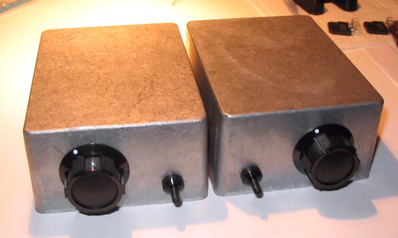

Bellow: A poor attempt to make something decent looking. Only the initial stage . I want to paint it blue. Suggestions for the type of paint I should use (because of the heat, if it matters).
Spray Can
There are lots of auto paint to chose from. Recently I tried the white engine block paint for my outdoor window trims. They work and look great, will see if they can survive this winter. Oh CrappyTire of course..
Chris
Chris
Heat shouldn't be a problem. I was using a regular spray paint on Aleph heatsinks with good results. You might try some nice automotive metallic paint (from Canadian Tire)😉 I've seen the recent Wilson speakers painted in dark (or deep) blue and they looked very cool.
