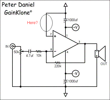

Matttcattt said:so the 50k multi-turn pots go from non-inverting input to ground, instead of the direct connection that i have on my amps? any other components i should add? i am using peter daniel's circuit.
Yes, it goes from the non-inverting input to ground.
And you connect the RCA ground before the pot (a sort of a signal star gound), and then connect that point to the psu star ground, on the caps, with a small piece of wire.

When adding a pot to control the DC offset, do you only use two pins? i.e. just use it as a variable resistor?

Taliesin said:When adding a pot to control the DC offset, do you only use two pins? i.e. just use it as a variable resistor?
Ian
Yes, two pins are joined together.
