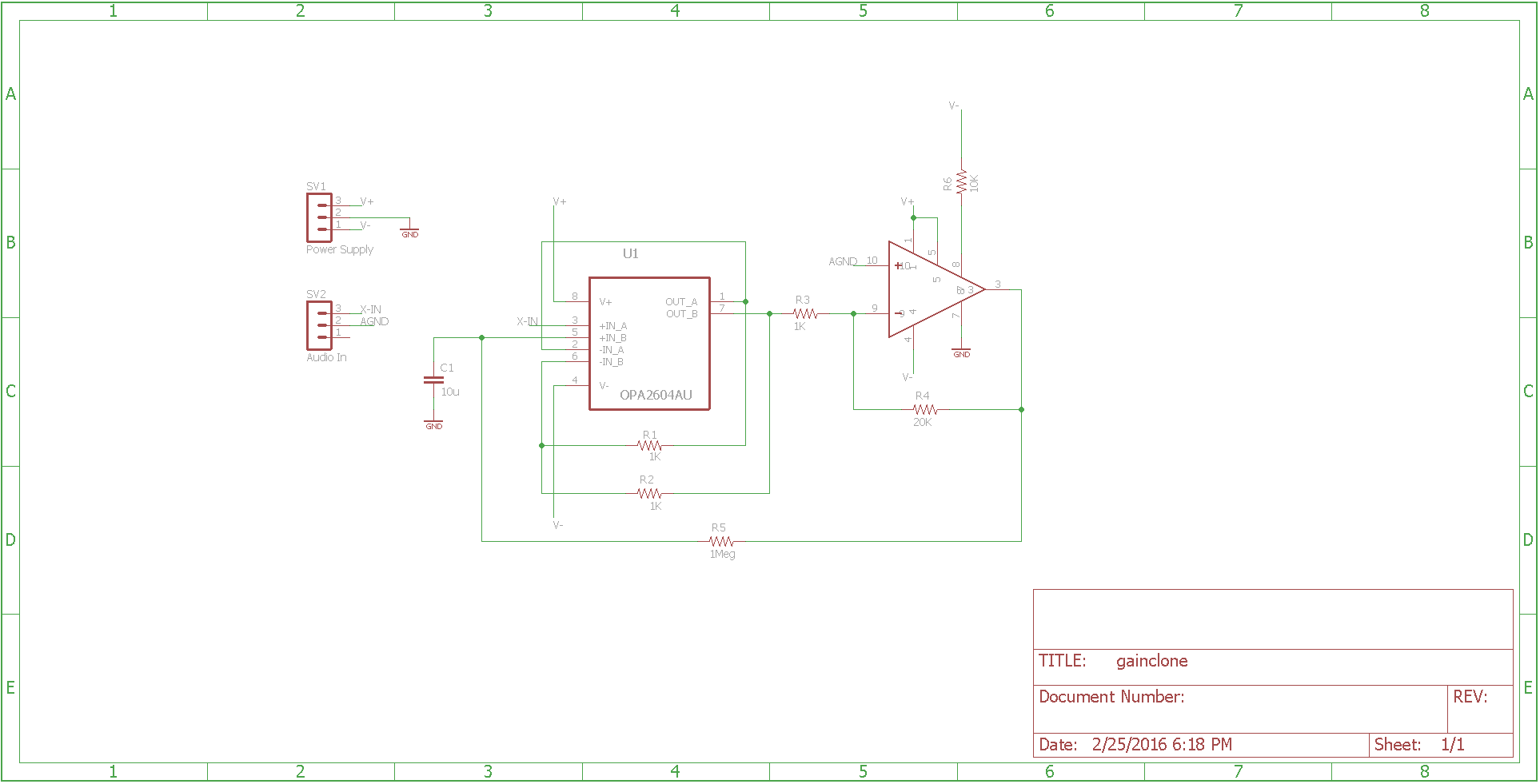

Gainclone schematic
I trying to create a schematic for the Gain Clone design from Bob Cordell's Audio Power Amplifier Design book. This design improves over the "stock" LM3886 by eliminating the capacitor from the signal path and reducing DC offset. This is my first try at Eagle and wanted someone to look over the schematic. Are the GND & signal ground connections OK ? I keep getting an error about power supply pin connected to V+/V-/GND for the LM3886. Also how do I edit the frame atrributes for author/title etc ?
