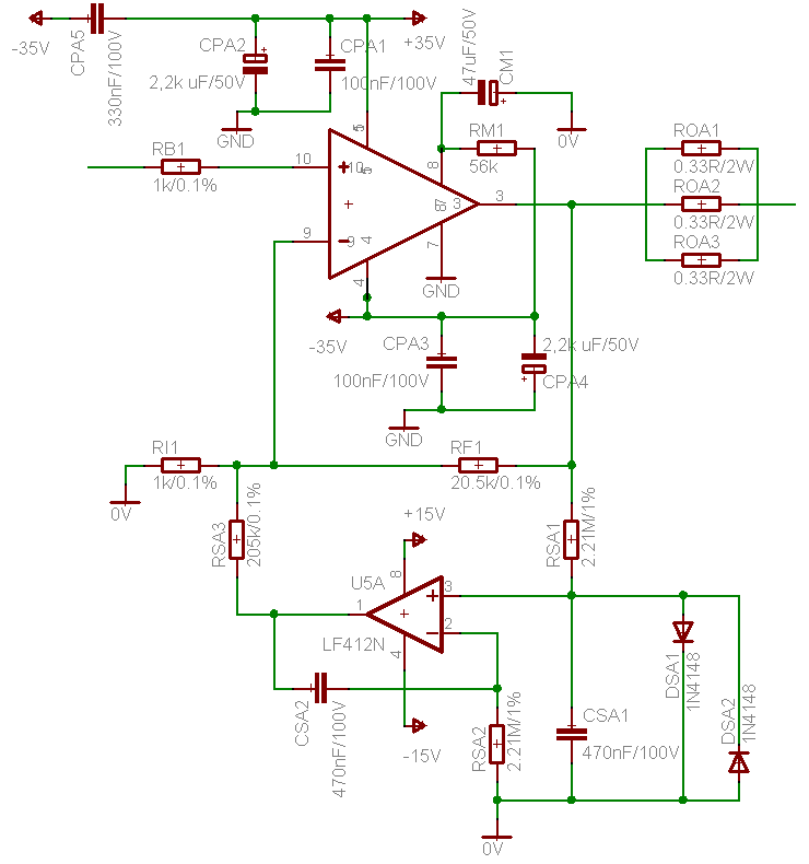

No, it is not resonable to expect a single pair of 5 A regulators to power four LM3886's. If you used a pair of regulators per LM3886, that would work. But why? Regulated supplies are (IMHO) overrated, and in this specific case, where you are building a subwoofer amp, they are totally and completely unnecessary. The only function they could serve is as space heaters. Save your money.
(Consider this as an intellectual exercise - the regulators can handle up to 5 A, so if you were able to use them at that maximum level, the maximum current through your 4 ohm load is 5 A. The RMS current will be 3.54 A (for a sinewave). Then RMS Power, P = I^2 * R = 50 W. So with a single pair LM338's regulating your power supply rails, the maximum power you can get out of any amp of any topology is 50 W RMS (into 4 ohms). This is a limit imposed by your power supply. If you use really big caps on the output of the regulators to smooth out the current requirements from the regulators, you may be able to get 5 A average (or RMS) out of them. Then power would be 100 W in to 4 ohms, but that's really stretching it. And that's assuming that you do not have to derate the output current capability of the regulators for any reason, including Vin - Vout being too high, excessive temperature due to inadequate heatsinking, etc.)

Here (in the attached image) is part of my schematic which is based on AN-1192. What do you guys think, is there something I should change? Would 0,09R be better than 0,11R for Ro? Should I use capacitors at LF412N's suppy pins?
If I will use carlosfm's unregulated PSU design, is it ok to just add 20000uF per rail or should I change something else?

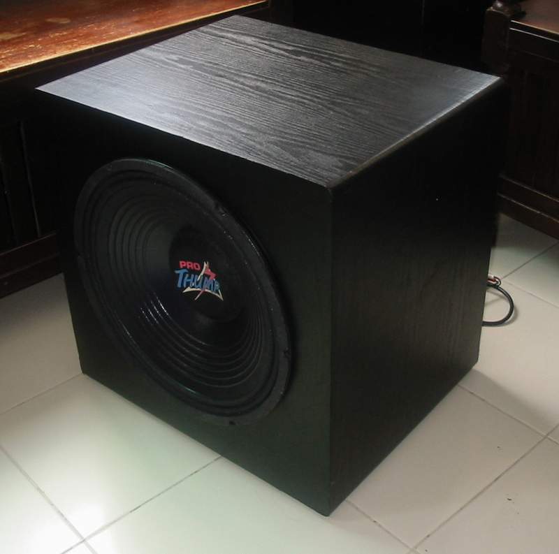

here is my sub using a OPA 549 in para-bridge with Rod elliot's EAS filter and a cheap 15" car subwoofer.

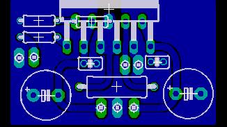

Hello all, I have also been thinking about putting together a sub amp to replace y current underpowered unit. My plan is to use a pair of bridged non-inverted OPA541's. The bridging will be accomplished with a DRV134 similar to Digi's design. I have attached my first draft of a PCB. The plan is to use two of these and mount the bridging board in between. Obviously the caps on board are a bit small for a sub, there will be a pair of 6800uF caps on the PSU board. I'm going to try unregulated first as I would like to keep it as simple as possible. I really don't need a filter of any sort as I am using this with an HT preamp that has a sub out, If I do add one I'll likely just use an adjustable active lowpass filter with an OPA134...cheap and simple.
G.
