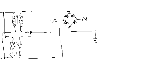

1 - Can I use a matched pair of transformers? If so, should I treat the pair as a double toroid, paralleling the primaries and hook the secondaries up to Brian's snubber PS as usual, or should I also wire the secondaries in series and treat the connection point as a center tap?
2 - If I find a suitable center-tapped transformer (e.g. 24-0-24), can I hook it up like this? (Diagram actually shows a double-transformer set up as a center-tapped secondary, to also illustrate my musing above. Yes, I know, I can't draw, and paintbrush is all I have on this computer).
3 - When running as above, will the 60Hz ripple in the neutral cause a noticeable effect in the sound? Or will the DC just happliy dance above it?
4 - What is the right way to earth-ground the setup above? Primary neutral tied to ground, tied to chassis? What about the signal grounds? (input and output) Do they stay isolated? From each other?
5 - Speaking of earth-ground, what is the right way to earth-ground the dual-primary, dual-secondary transformer setup with BrianGT's snubber PS board?

Next question set -- I'm having a devil of a time trying find a "recommended" transformer for a price I want to pay at the moment. So:

I'm a newbie at this too.
I'd recommend grabbing one of BrianGT's kits, building it, trying it out and deciding if that suits and move on from there.
You can use single or matched toroids with those kits out of the box, so you don't need to worry about PS design. You can swap to the snubberized PS later, or opt for it from the start. People seem to generally opt for 120-160VA per channel, but some just go with what they have.
I don't think you can put a 3886 in a 3875 board. The 4780 boards have zobel circuits in the current revision, maybe they all do. Ask Brian.
You can experiment with the zobel and your preamp - decide which works best for you.

Hi, Michael!
> design.
Perhaps I worry too much. I once blew a VERY set of expensive tweeters through excessive clipping. And then, not knowing why, I blew them again. I had assumed it was a line surge or something (I knew the speakers were way beefier than the amp), so I added a surge suppressor the second time. Fortunately, the second time they blew, I noticed that the amp was smoking like hell. Opened it up and found the transformer was so hot it ignited the schematic diagram, transformer paper, and scorched the PCB. A more knowlegeable person than I (the owner of the speakers) then explained WHY the tweeters blew. I felt like a real idiot. And got out some more cash.
Yeah, I'll probably build the 3886 board as-is and then decide on the zobel network as you suggest. Looks like the hard part (design) has already been done, I should be able to lift and graft from the 4780 boards. I think.
I'll have to figure out if the impedance of the parallel inputs on the 4780 board will affect the network Brian used there. Wish I had more AC theory under my belt.
Okay, that's helpful. I wasn't sure if the quoted numbers I've seen are per channel or per pair of mono amplifiers. Any idea how those numbers were achieved? Just trial and error?
The reason I'm curious is that the Overture Design Guide -- http://www.national.com/appinfo/audio/files/Overture_Design_Guide13.xls -- says [madly typing] that an LM3886 running 35V rails can put out 61W and dissipates 31W of heat when running an 8 ohm load. This makes for 92W required just for the chip, or 108VA(?) per channel.
But then, if we change to a 4 ohm load at 28V rails (bigger and the spreadsheet throws thermal warnings), we're making 73W of output, and dissipating 40W of heat. For a total of 113W or 135VA(?) of power required (just for the chip) per channel.
Hey, these numbers work better than the numbers I had last night. By over 100VA per channel! I wonder what I did wrong? Thanks for making me double check that!
Anyhow, so that means 120VA per channel is about as low as I'd like to go in 8 ohm mode, and 150VA for 4 ohm -- and another 75W for bridge mode. [What happens if I go too low? Can I prevent speaker-damage-problems by reducing gain or attenuating input?]
So. If I want to bridge these puppies, I'm looking for a minimum of ~250VA per channel. So these guys running 180VA dual toroids (90VA per secondary, right?) must not be running their amps full-tilt 100% of the time, and are definately not running in bridge mode. Or maybe their transformers are putting out more power than the sticker says they can...

> your old amp considerably,
Yeah, practicing tonight was painful, when all I could think about was getting rid of the mud so I could hear my boogie-woogie bass lines a little more clearly.
> Oh, and good luck!
Thanks! Your post was very helpful, at least I feel confident in what the *requirements* for power for these things are now. (As opposed to ... I used X and it worked for me -- makes shopping for anything other than X difficult).
Wes
I forgot to add, there's useful guides on Brian's site:
http://www.chipamp.com/nigc_kit-users_guide.pdf
and
http://www.chipamp.com/docs/lm3886-manual.pdf
Both have got a (looks identical) section on choosing a transformer, which discusses the requirements.
And, if you have a look at Brian's silkscreen pdf for the 3886 kit, you will see that the Zobel components Cz and Rz are built into the design now:
http://www.chipamp.com/lm3886silkscreen.pdf
