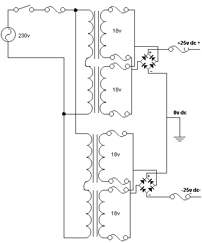

I am building a power suply using this diagram. How can i work out what value of fuse i need on the primary side of the transformer. Is it sensible to measure the current using my multimeter, or should i just multiply the current at the secondary by the ratio of the transformer? The current at the secondary is 15A max, so i will use a 15A slowblow here, then a 15A quickblow after the capacitors, so the inrush current doesnt blow the first fuse.
230v/36v=6.4
15A/6.4=2.4A
Should i use a 3A slowblow, or will the transformers (2x 300VA) blow it? should i build a soft start circuit, with a lower value (2A maybe)?

Konnichiwa,
May I polietley ask WHY ON EARTH you would do that? You have separate transformers and rectifiers so you can supply both channels fully separated with the grounds only connecting at each channels star earth point, thus making sure all current loops and grounds are optimised and you simply throw away all these advantages. I would really recommend for you to change this.
There should be a fuse PER TRANSFORMER and the value for this fuse and the type is usually specified by the transformer manufacturer as mandatory application to retain the transformers safety certification.
Absolutely NO.
Better choice, but you really should get that manufacturers recommendation for this.
Sayonara

Eleven of them? Dunno, maybe the distortions cancel each other out 🙂 What exactly are trying to protect? The transformers? The chips? They cost almost as little as the fuses and are seriously protected as is. You're certainly not doing the speakers many favours with the fuses in the secondaries - one open fuse may result dc at output.

Fully agree. Connecting those bridges together will cause one transformer to do much more work charging the caps than the other, because they will never be exactly the same. Folloy KYW's advice, make two supplies, one for +V and one for -V. You will also save big time on the bridges (in fact you would need only 4 diodes in total).

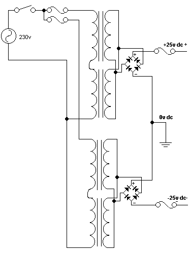

the secondaries are to protect the bridges, and the last ones are to protect my amp, or any other load attacted.
if there are serious disadvantage (other than audiophiles thinking the fuses affect the sound), i might think about using less fuses.
Jan Didden
like this?

You don't need "double" fuses for the rectifier bridges. The primary fuses are enough if your bridges are big enough. A 10 A bridge can take 100 A shortly. A 25 A can take ...much before it goes to powder.
i am going to use 35A bridges, so i dont need the fuses?
[EDIT]: back to my original question, what value of fuse should i use for the primaries?

Your original question: How much current goes at full load? If you not are going to use any soft start, 5 or 6.3 AT for 600 VA With softstart 3.15-5 AT, it depends. You should in any case use a slow fuse.
Some transformer manufactures use to have recommendations on the transformer. Check the label.

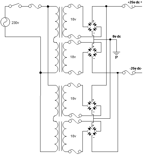

Kuei Yang Wang said:
Konnichiwa,
How about something like this:
http://ampchipdiy.com/ultimate_ps_gc_1.gif
Only scale up the two 4,700uF Capacitors to maybe 22,000uF/16V or therabouts.
Sayonara
what advantages would this give?
