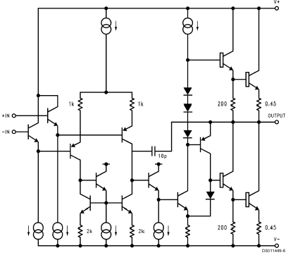

tschrama said:Hi all,
would like the www.diyAudio.com community to be the place for some serious discussion about this amp.
- I would like some educated remakrs about the influence of the emitor folowers. To my knowlegde they introduce more distortion than that they increase gain and thus feedback, so their influence is one of increasing distortion, or isn't it?
- What's the function of the 1.1K resistor in the LTP?
- What's your opinion of the amount of Quensient current?
Infact, I've never seen such a design for discrete components, why not?
- Why does everybody use Vbeamplifiers instead of diodes for biasing?
- Why does nobody use those emittor folowers, and why does NS use them?
- Would would you change to the design if it was posted as a discrete design?
Well, I hope some of you can discuss the LM3875
gr, Thijs

Yup. All details, topology et al are covered by Selfs Articles in Wireless World and his Book. It is truesly "BOG STANDARD".
I thought this should be obvious.
Bipolar transistors operate by injecting a base current that modulates the resistance of the the collector emitter line. The proportion of this base current compared to the collector current is called "Beta" and is a measure of the transistors gain. However, as is well known, the Beta of a transistor varies with temperature and collector current.
Now most current amplifier designs tend to use the transistor in a circuit that is in essence voltage controlled. Thus our base current becomes in fact a parasitic current that is signal modulated. If we now drive the amplifier stage from a relatively high impedance (like a current source tail, current mirror differential pair) this current will cause distortion (the same applies BTW to the base inputs of the differential pair with respect to feedback loops and sources).
So this varying base current produces a "parasitic" and strongly signal dependent load on whatever preceeds the amplifying stage. It should be easy to see how this would introduce distortion.
By putting an Emitter follower ahead of the input to the given stage the base current modulation of emitter follower will be the base current modulation of the amplification stage divided by the Emitter Followers Beta, so in most cases the current modulation will be reduced by a factor of 100 or more (40db improvement).
Again, this is covered in detail and with measurements in Selfs work. I rarely agree with Mr. Self, but I do agree that it is desirable to linearise a given circuit as much as possible BEFORE applying negative feedback, it not only measures better, it also sounds better.
BTW, all those guy's who are now smug about using FET's in their designs which do not have this peculiarity found with BJT's can wipe that smuggrin off their faces. FET's have other strongly signal modulated parasitics (in this case capacitance) with their own problems. Most FET Amplifiers have a strongly signal dependant open loop bandwith which can make life interesiting after feedback is applied and is (IMNSHO) the cause of the often cited "Mosfet Fog" sound. It can of course be fixed easily by adding an Emitter follower on the Gate of the Mosfet... 😀
See above. A Class A emitter follower (or source follower or cathode follower) implemented well (I'd suggest cascoding and using a current source as load) will have very low distortion of it's own. So no, in this case the emitter followers buffering each stage will materially decrease the open loop distortion and thus increase the open loop linearity of thge Amplifier.
Local degeneration. This reduces the gain in the LTP (again, Self actually does cover this) and thus improves linearity and bandwidth.
It is clearly set for what Self calls "blameless Class B". What this means is that it is tuned to a minimum of crossover distortion. However crossover distortion still exists and usually increasing the quiescent current to higher than the "blameless class B" operation sounds subjectively better, even if measured distortion (THD) is higher.
Then you have not looked very far AT ALL.
If you strip out the emitter follower buffering of the LTP and VAS stage and take out the local degeneration in the LTP you have pretty much the absolute standard quasi complementary amplifier from the late 1960's and early 1970's from the RCA Book. Naim still builds all their amplifiers this way BTW...
Is that what is bothering you? Diodes usually provide poor bias stability. They only really work well on the same chip. The VBE multiplier tends to "throttle" the bias current when the amp gets hot avoiding thermal runaway (at the expense of sound quality), it makes amplifiers more reliable...
I have seen them in quite a few schematics of commercial amplifiers actually. Also, in the 1990's D. Self extensively documented this use and it's benefits. I also seem to remember Ed Cherry and others to have commented in similar tracks.
Because they materially improve things.
If I was making a discrete amplifier I would NOT use this topology at all. I would not use SEPP, I would not use the LTP/VAS/Follower arrangement. I would do something entierly different.
But that is hardly the point here. As far as conventional structure Amplifiers are concerned the LM38XX series is a sensible implementation that ensures good performance within the limits of the design remit. Rather than mucking about with similar discrete circuits which will invariably be less ideal than the chip amp do something differnet and shift the paradigm.
Sayonara

Hi Kuei Yang Wang
I look at the input stage a little different than you do.
First the fact: Apart from emitter followers, a BJT works the most linear if it is used as a CURRENT CONTROLLED CURRENT SOURCE -period !!
In my opinion the input emitter followers are there to avoid high input bias currents and therefore broaden the range of resistor values that can be used for the feedback network.
Because the bases of the LTP are now driven by a voltage source it's emitter resistors have to be increased to the 1k instead of the commonly used low values (between 56 and 120 Ohms) to retain a reasonably large linear input range.

Oh, that's easy. If employed "inverting" the voltage on the positive and negative input are in effect 0V (reality is more complex though). This means that the common mode input voltage for the amplifier circuit ais also 0V.
Operate the Amplifier non-inverting and the long tailed pair (LTP) is subjected to a common mode voltage (inverting input follows non-inverting input), namely the signal. Due to a number of varying effects a LTP with a common mode signal is not terribly happy (no matter if BJT, FET or Valve) and will cause increased distortion or more precisely reduced open loop linearity. Again this is all covered most excellently by Mr. Self.
This BTW holds for each, all and sundary long tailed pairs. Hence my general dislike (sonically as much as technially) for the use of LTP based Circuits and in solid state my liking for circuits based on the "Diamond Transistor" structure. Here the common mode signal in non-inverting mode is not a problem. In most cases common Audio Op-Amp's and Power Op-Amps sound better inverting (taking to re-invert the polarity by swapping the speaker wires), subjectively speaking. Measured distortion also is usually better.
