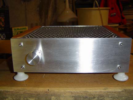

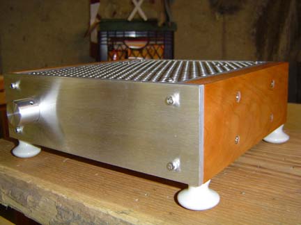

When I realized a group order for knobs wasn't going to happen soon enough, I went ahead and made my own volume knob. It took three knobs before everything fit and turned properly. I'm not sure I like the feet, they are just some old porcelain drawer pulls. They'll work until I find something better.
fcel said:Widman,
Nice built. I'm curious, are you left handed?
I don't know about Widman but I am left handed and one of the few times I can have "left handed" equipment is when I've built it myself. All the amps I build have the volume control knob on the left!
Sherman
- Chip Amps
