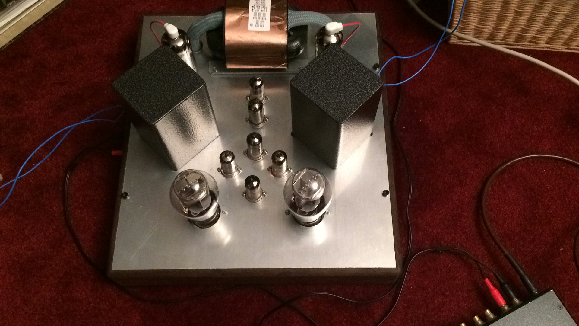

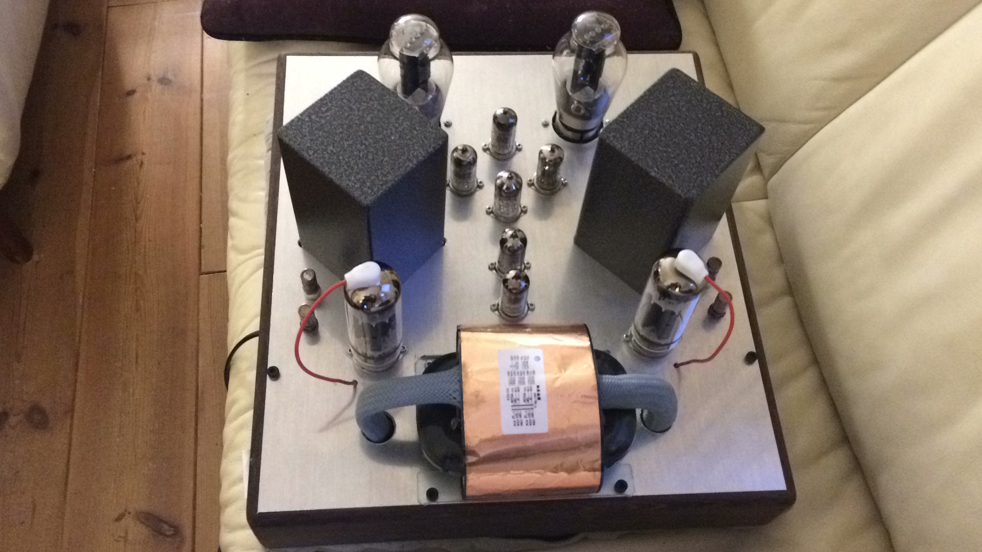

Now, I just build a GM-70 Amplifier which is running with -88V and 950V. I was really a bit concerned as my driver stage can present 240Vpp when my DAC is playing a 0DB sinus-testsignal from flac. but the music I got acutally did not sound really distorted at all. Why is that ?
I went with a recording analysis program into my flac files and analyzed the maximum levels which are in the loudest recordings I got. What I found:
- The Sinus-Testsignal of 0db has 0 db 🙂
- The loudest music recordings have their absolute peaks max at -9db, typically -12DB for the loudest in "normal loud" recordings
- Normal loud music plays around -24db
Well, now I believe stuff comes together:
By coincidence, my Gm-70 amplifier has already a bit of Thomas' design principle build in: A far too loud theoretical voltage swing for the 0DB-Lab-Sinus. 240Vpp should create severe distortion at an output stage with -88V.
But it does not. Because in reality I never present more than -85Vpp (-9db) input signal to the Power stage as there are simply no recordings (and I chose the loudest from hundreds of CDs) going louder than 9db. not even transients as I did a spekrum analysis.
Which in return means that I could (for my 240Vpp@0DB-Input/driver-stage) even design a power stage with only -45V bias and it would still be clean and not distorted...
OR...
to my surprise it looks like for real life recordings: I have with my -88V bias even 6db (factor 2) headroom build in already. So, instead of feeling worried and try to get the negative bias for the GM-70 high to -125V, Ishould feel pretty relaxed.
Any flaws in that thinking ?
(and therefore as well Thomas design philosophy makes perfect sense as he simply knows that nobody has digital 0DB recordings available, so you would waste power...which is not a good thing with a 300B SE amp I guess)
It all makes sense here. I just like the idea never to be short of headroom. I also think that a beefier driver is able to react faster on these transients and therefore gives more microdynamics. This will be difficult to measure as it is subjective. Frequency range and FF plots can give an idea but somehow all this subjective perception is something else all together...
Yes, this is a different dimension I believe we have when you say beefier...the old vt52.com had a nice formular spreadsheet which calculated for correct transient reproduction a driver should be run with 10mA at least for a 300B as an example I believe...a function of input capacitances and mu. But typically 10 to 20mA is what a driver should have...I am running 25mA with a 801A.
From my practical experience, I am building nowadays my driver with IT as I have found a very good winder (50Ae) and the IT acts - additionally to the current I send through the driver tube - as a kind of energy storage for transients...I found a 6sn7 always a good tube, but a bit boring when driving a El34, but when you give it an IT it is a different animal..much better dynamics.
I use cathode followers to drive my power tubes (any). But it is a modified follower as the standard followers are too slow for me (again subjective).

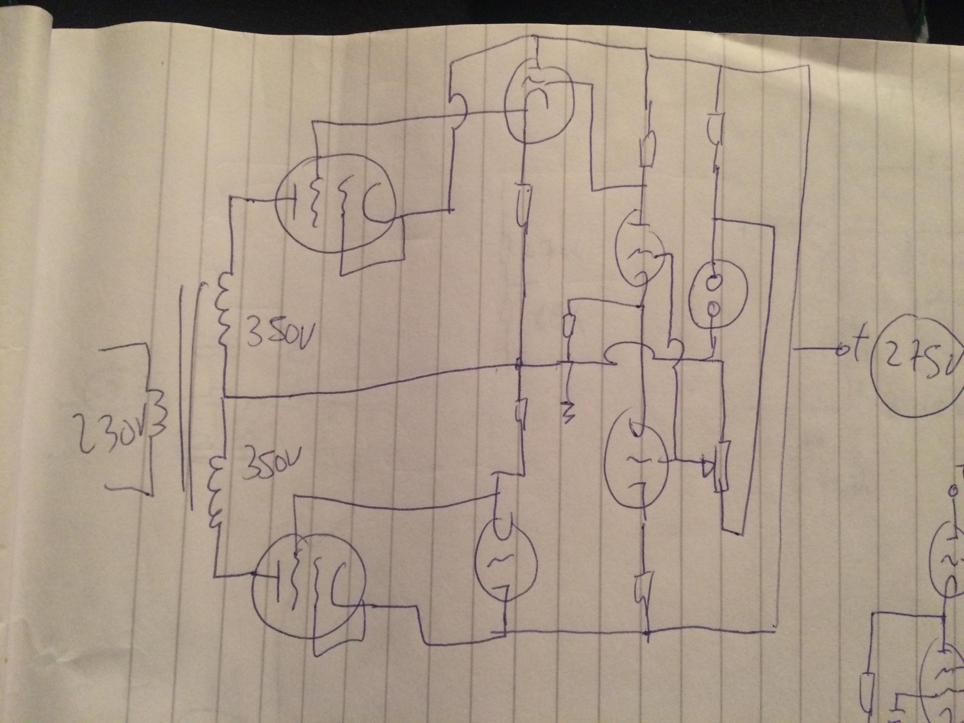

Usually i do not share any of my schematics, so please send me a PM.
The power supply i can share to give an idea...
My schematics all are incomplete as things that are obvious are sometimes not drawn or omited. So connections are missing on paper but not in the amp.
