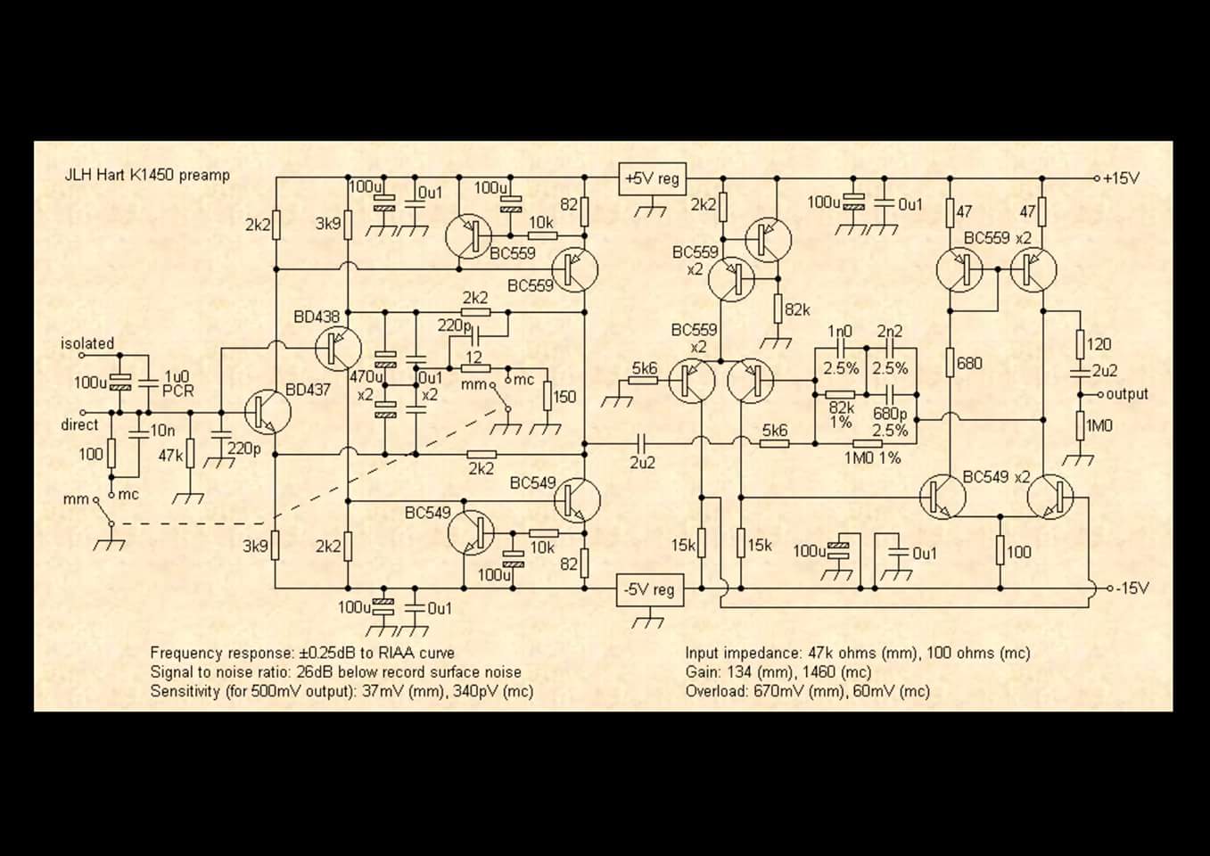

Hi all, A friend on a Facebook page has seeked my help, but I can't answer. Basicall he wants to adjust the gain on a jlh phono stage. This was his original post.
This is a John Lyndsay Hood design & my circuit is exclusive to MM carts. My question is which resister would I need to adjust to turn the gain down as on my RIAA Pre-Amp it gains the output to 2vac ? TIA for any help.

I assume the mm/mc switch is in the mm position, then
either change the 150 ohm resistor next to the switch to 300 or 330 ohm, or
change the two 5k6 resistors "in the middle of the schematic" to 10k or 12k.
Either would reduce gain with about 6dB.

I have been poring over the gain structure of this RIAA pre amp this morning (I must get a life) and I am confident that I have found a typing error on the below schematic .
On the bottom left it states mm sensitivity of 37mV this should read 3.7mV.
If you look at the bottom right it says the mm gain is 134 which is correct 500mv/134 =3.73mV.
Gain structure... first stage mm 18.16dB
.......................first stage mc 39.33dB
.......................second stage (RIAA) 24dB @ 1Khz

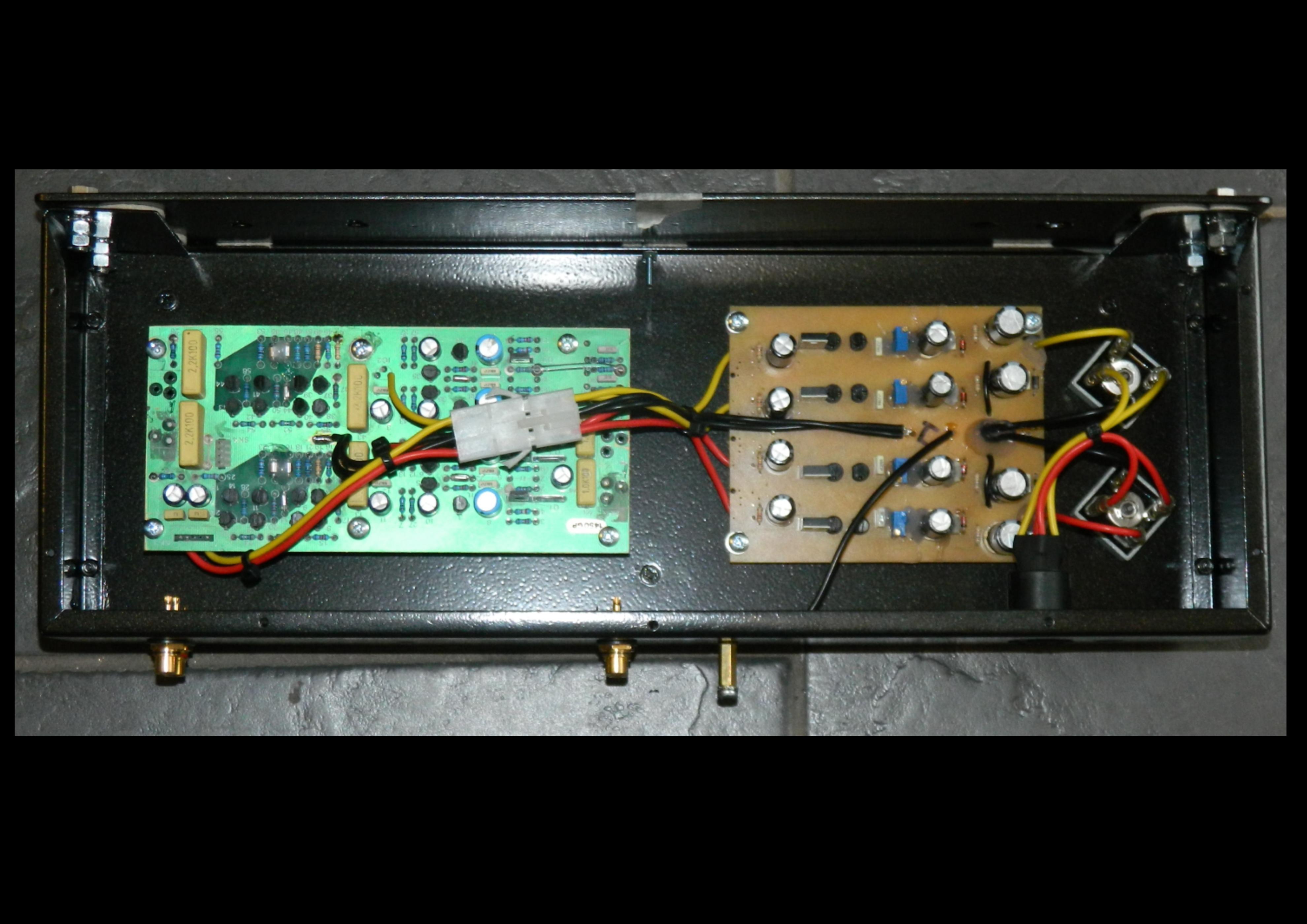

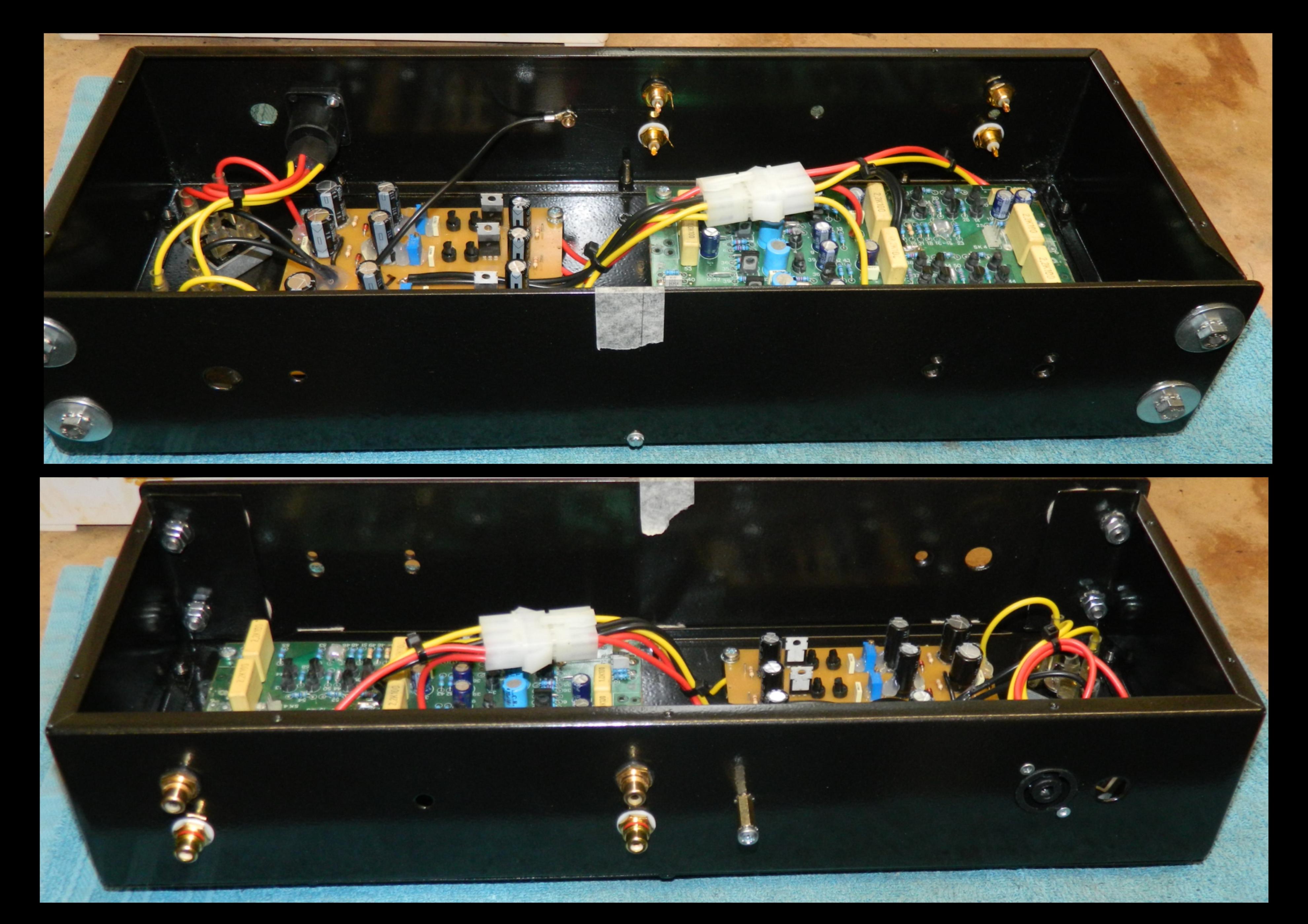

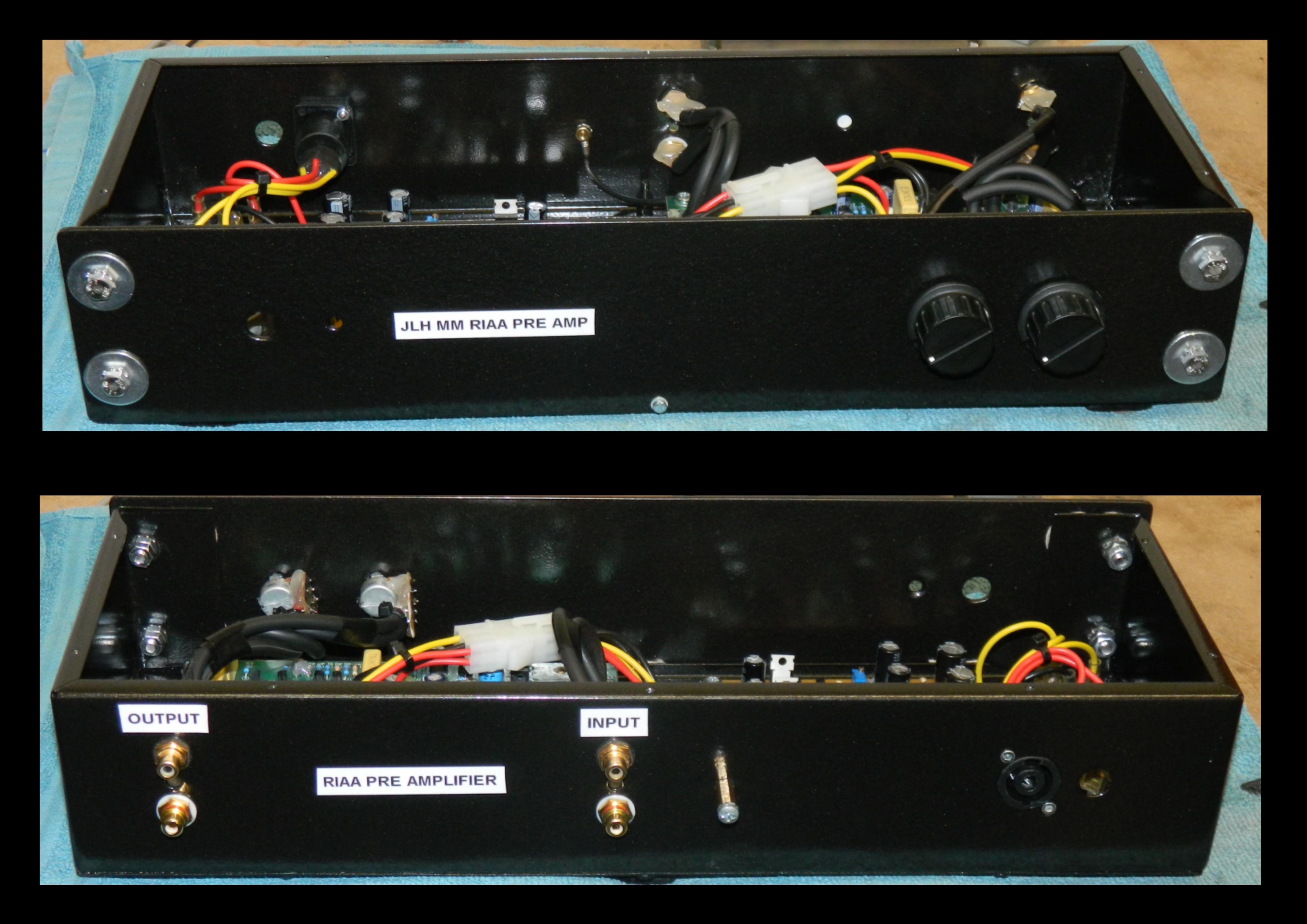

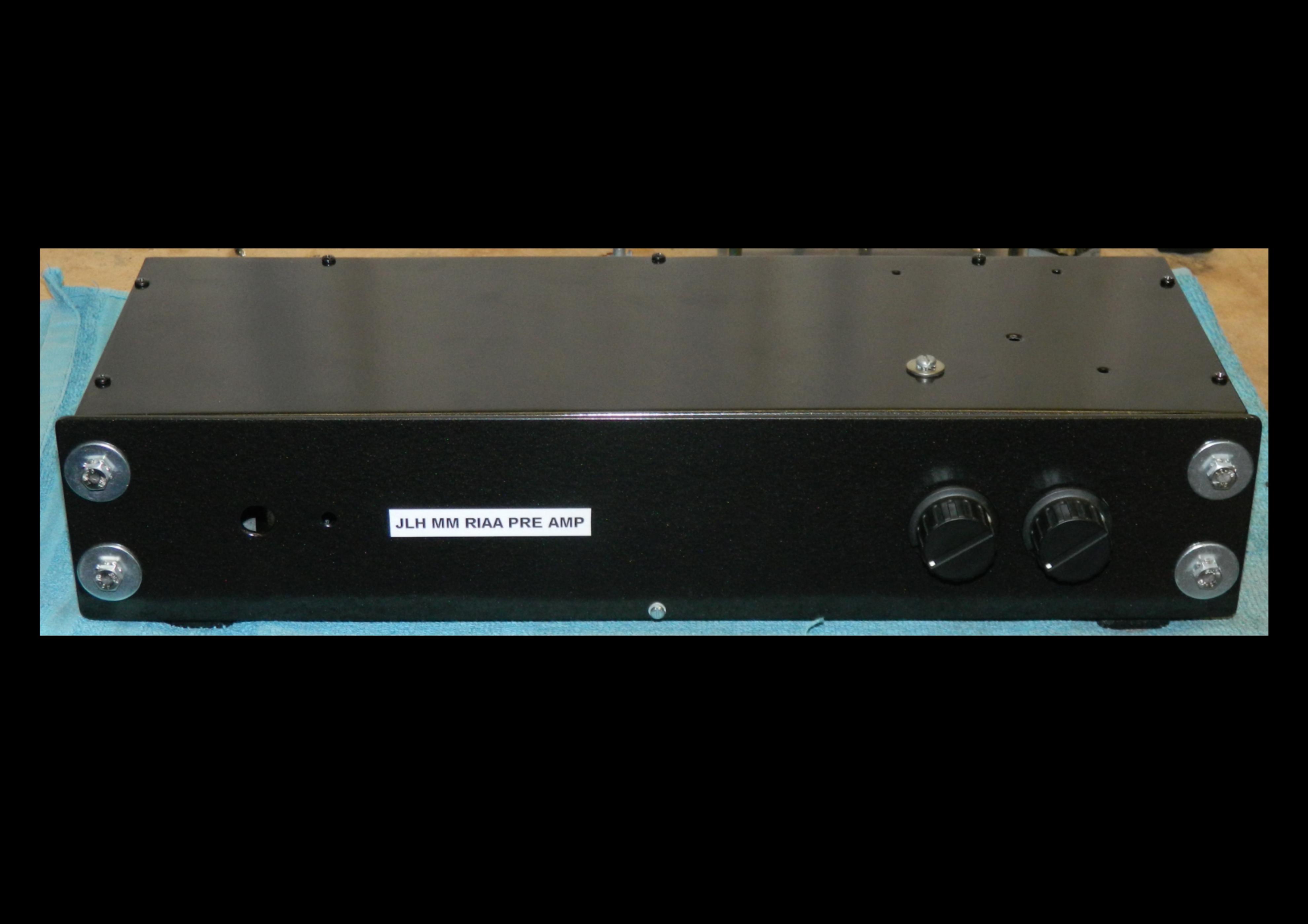

Yes, I believe there has been many typing errors with JLH circuit diagrams, when I first calculated the mm gain using the following information 12mv (at MM) I used the formula 2v / 12mv = 166 & the 166 is the gain which seems to be over the spec written on the circuit ?
As in photos you will see the rebuild complete.
The only problem with this RIAA Pre now is the background noise which may be caused by the following information:
Left Channel Input Voltage (not connected to r/p leads) -127mv
Right Channel Input Voltage (not connected to r/p leads) -281mv
With my prototype op-amp based riaa I get a high gain hiss if you turn the volume up like all other riaa pre's I have had well below groove noise.
Now with the JLH I get a deep humming sound, below groove noise but higher than the prototype op-amp based one but still lower than the groove noise, you can feel the hum on headphones if you know what I mean.
Please no fixing advise on earthing as earthing is perfect with no noise.
Could the dc offsets on the inputs be causing this deep rumbling noise & what silicon should I change everything or just the bd's ?

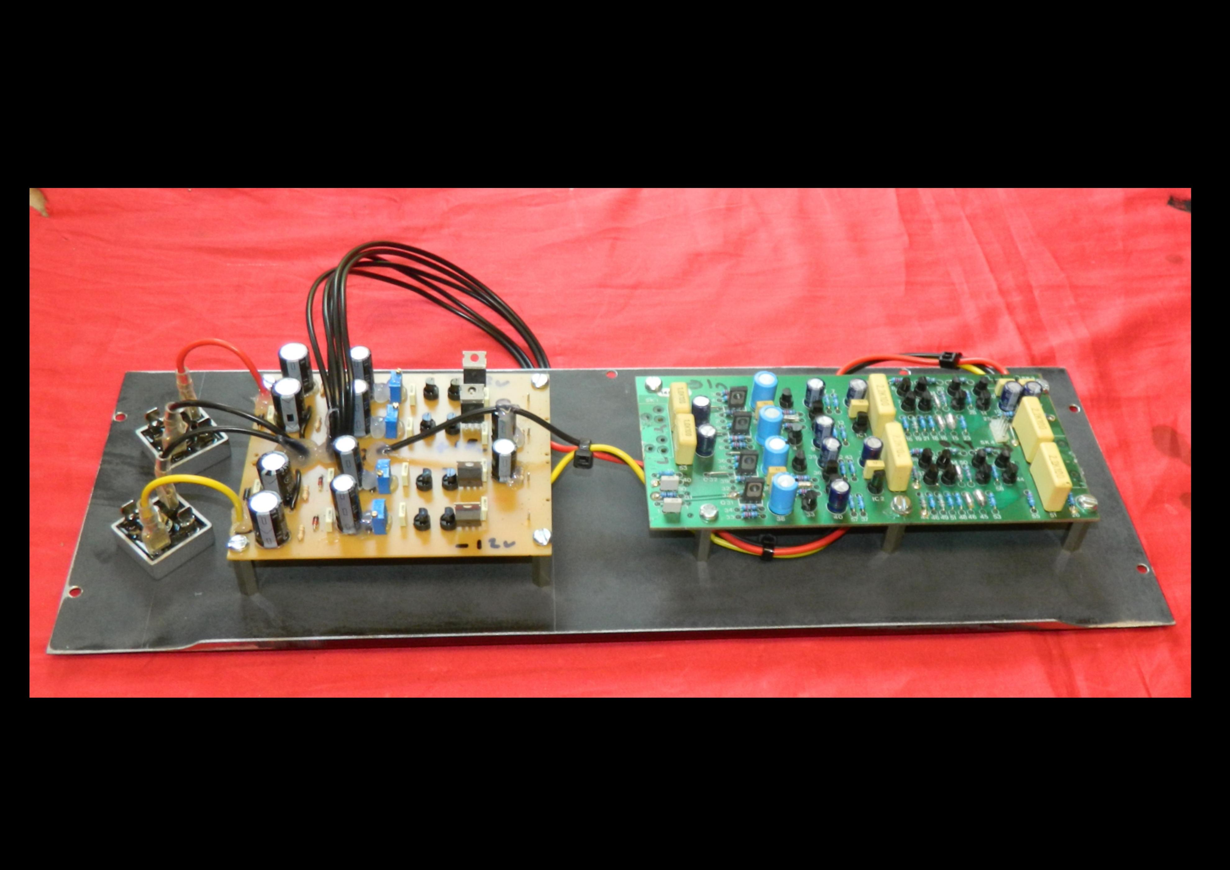

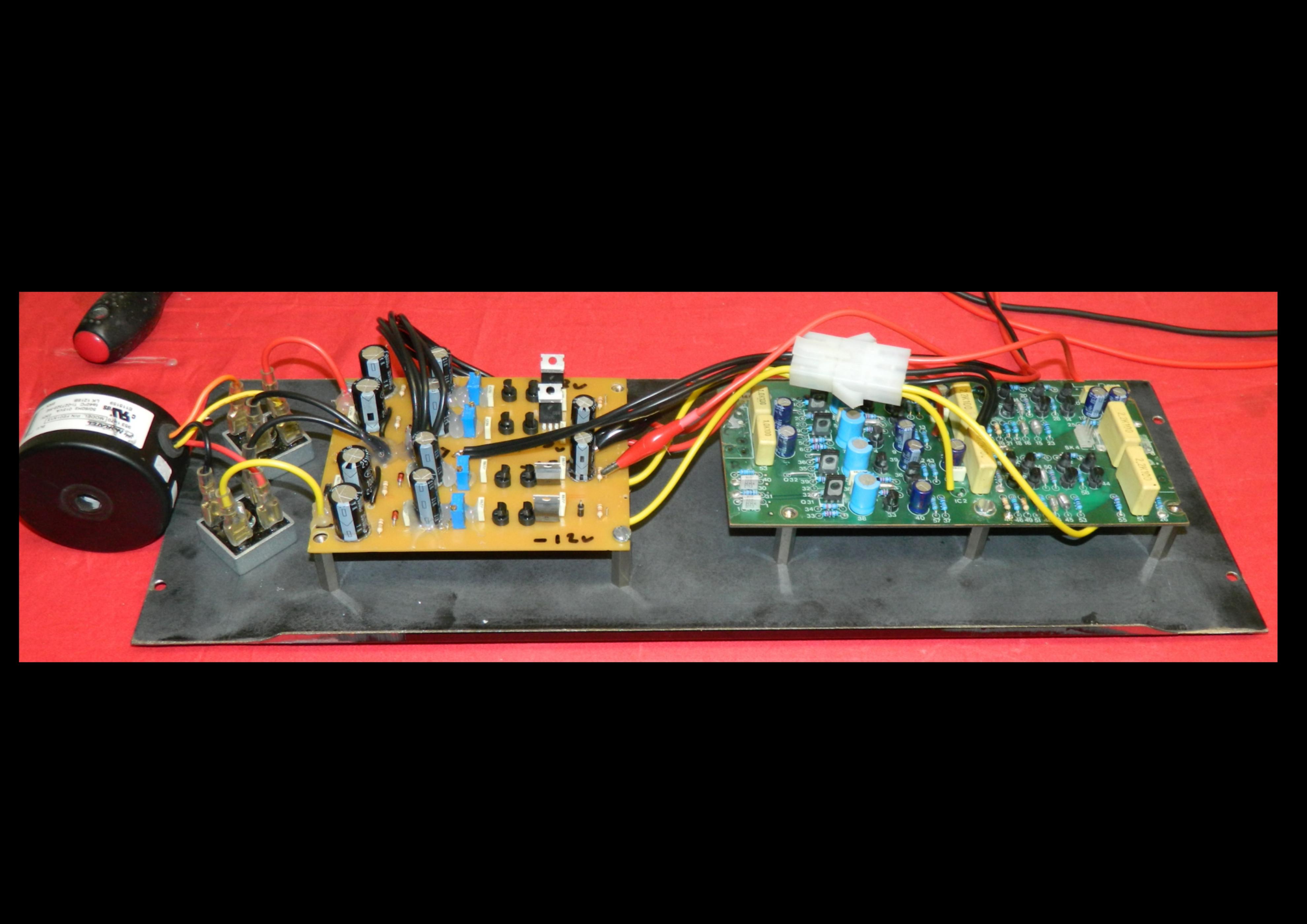

Your hum problem is probably down to the removal of both 5V regulators , they were there to increase the smoothing on the rails that feed the more sensitive input circuitry. Those voltages at the inputs are about correct , personally I would not use the direct coupled input option .
I have been making regulated power supplys for many years so I doubt your answer about the "more precise" +-5Vdc supply rails as they are symetrical voltages being given to the circuit (+-15v & +-5v) not just a "thrown together" Hart psu with way out "plus" to "minus" voltage of up to 2vdc differences
I was thinking the fault is more to do with the ac offsets at the input making the signal to noise hum instead of hiss, my prototype op-amp version is only giving -15mv on each input measured (Fluke MM).

The 5v regulators are there for a reason .. also just for info my JLH phono preamp with the Hart PSU does not hum at works faultlessly, as I have a original unit.
You need to retry with the 5V regulators for the front end .. the fact that mine works and yours has a issue there must be a mistake at some area in your work .. just my humble opinion of course .. post up some more pics of your power supply that you have used for a second opinion
Also note the Hart supply has a good star grounding pcb tracks and a good earth lift circuit that actually works ..
all the best
Bespoke Constructor
Joined 2006
Hello again
just a couple of pointers
1. is that case earthed ? as it should be earthed to the star point of your psu or a earth lift resistor
2. You have the power supply cables running over the most sensitive part of the circuit, these should be screened or twisted together
3. The 5 v regulators should be installed
4. This design was designed by one of the most respected designers in the field at the time .. I would cheekily say you expect to much from your construction skills not the design :cheers:
