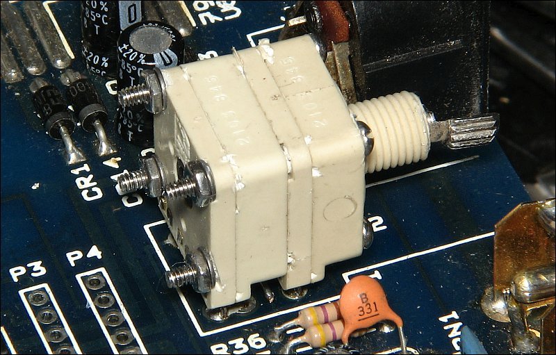

I’m repairing an older PPI amp .
The gain pot was coming apart from someone else’s attempted repair .
The pot still works but 1 pin is missing and the other is badly bent to keep the pot together .
Wondering what do you use in this case to put the pot back together
For future reference, #2-64 screws nuts and washers. The holes were drilled with a #49 drill bit.
