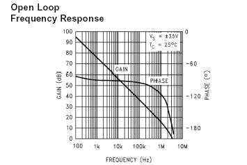

But Selfs results show that the CMRR is not constant during the signal cycle, much as the open loop gain is not constant during a signal cycle. (If it were, there would be no non-linear distortion). Especially around the zero crossing. open loop gain can vary by as much as a factor two. IF CMMM would also exhibit a similar non-linearity (which I am not sure, but Selfs results are convincing), that 0.09dB would vary during the signal cycle, which if it were symmetrical would give rise to 3rd order harmonics.
So however you cook it, CM distortion seems to be real, at least in some devices.
