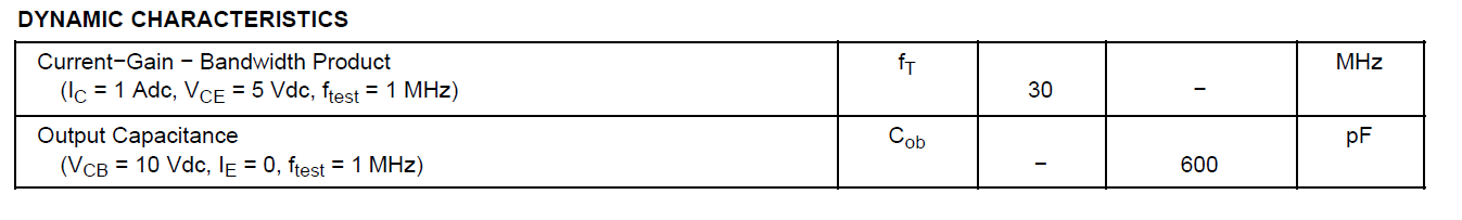

Actually, you do, it's right there in the datasheets. Your answer gave me the idea to look at some of the MJL1302 again.
Image1 is of a Motorola MJL1302 datasheet from 1995, note three colums (min - typ - max).
Image2 is of an ONSemi MJL1302 datasheet from 2005, now only min - max colums are given.
In both cases Cob is listed in the max column, and no other value is given. So, it is 600 pF max indeed.
The 220 pF for the Toshibas is a typical value, however, no min or max are listed.

ONsemi's later datasheet may well explain why I am beginning to see Forum comment that their quoted Cob can be different from what other manufacturers show.
