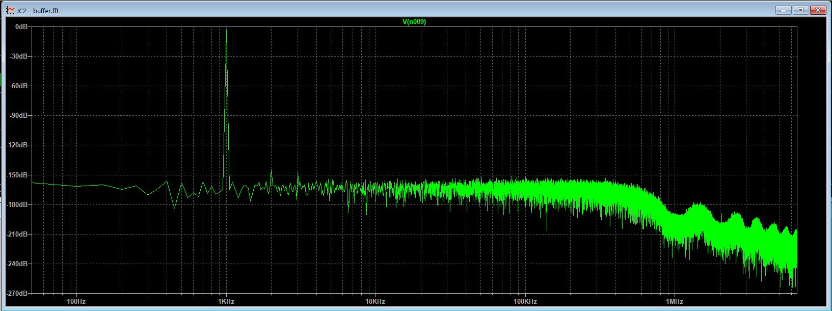

Hi i was trying to sim the famous JC2 by Mr Curl and failed
Changing some parts i have ended with the circuit attached Now it reduces the input voltage of about half
Is there a way of reaching unity gain ?
the idea is using it as a buffer maybe with 2 x 9V batteries
Thank you very much to all

The thread starter presumably assumed that everyone has access to LTSpice.
@ginetto61 Could you add a .png file of the schematic?

Hi yes sorry i did not know about the schematic but i found it on the web here https://www.diyaudio.com/community/attachments/jc2schematics-jpg.509235/

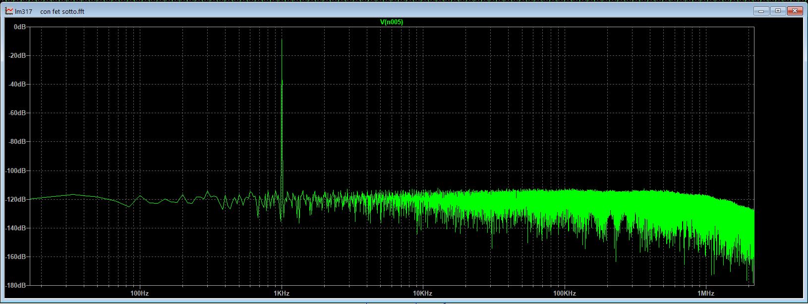

I am sure there is something wrong here I was trying to use the original line stage as a buffer I do not need gain Also because with gain comes also pain
I have to be honest I dont know how to expect The gain is slightly less than one Just one question When the dissipation of a transistor is almost zero it means that the circuit cannot work ? in the order of picoW 🤔One other thing: you look at an FFT. There are many ways to get the wrong level out of an FFT. When you look at an FFT of the input signal, do you see the level you expected?

Hi to drive a power amp stage after an attenuatorWhat do you need a buffer for?
I am very sorry i did not want to do something against the rule I thought that the circuit was pubblic domain ? the link is hereNot sure why you post a question but do not show the schematic.

as i dont need gain i was trying to wire it as a buffer Maybe changing voltages and values ...

Now i have changed my approach and i am moving in the opposite direction quite convinced that when a buffer is asked to push only let's say 500mV in a decently high impedance (in this case 5kohm) the result can be very good indeed in terms of THD at least
