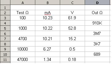

Results
Ok, so I got my results, and I did manage to dig up this: Look just before half way down the page for two tables:
It does seem to verify what I've found, but I'm going to re-do my test between about .68K and 12K
I'll post results again for future reference.

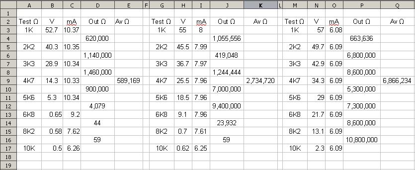

More results. This is actually quite fascinating how the CCS behaves when subjected to different loads running different currents. This is not simulated, btw. I'll post a small schematic of the simple 2 transistor circuit I'm using later on. Rail Voltage is +/- 31.5. I've got a voltmeter set over the CCS, and an array of transistors sat on the CCS output. I can then attach my ammeter to each of the pins in sequence, then read off each.
One question that does come out of this is what happens when the output current doesn't change between resistor values? I've fiddled the results somewhat because it stayed rock solid on 6.09mA. Each of the equations in the P column alternately adds and subtracts .001. If I leave the values the same, I obviously end up with a divide by 0 error, and this would also imply infinite output impedance. It's a tricky one! Whatever I do here I'm realisticly looking at introducing a factor of ten error (or worse!). If I +/-.0001 from alternate result I end up with an average output resistance 10x what's shown. I'd like the be able to measure more accurately, but my ammeter only goes down to tenths of mA! Is this equation right? Or am I missing some major subtlety?
Also, somtimes the current doesn't always carry on a trend of going up or down, and changes direction half way through. This can sometimes change the apparent output resistance to a negative value, which screws up the average result, so signs have to be changed before summing.
Is it correct to be averaging over more than 2 values? Or should I just be looking at the one closest to a rail drop over the CCS? Sorry for the essay, but this is getting quite interesting! As always in trying to answer what might look like a simple question I'm simply generating more for myself!

Interesting results!
It seems that even a simple CCS can have quite a high output impedance!
As for the negative impedance, this could be due to the fact that the CCS is no longer sourcing current but sinking it.

You could use a cascode device, FET or BJT, if you want a current source with high and constant output impedance.
BTW, two transistor CCS is very dependent to temperature over 45grdC. More temperature stable is the BJT-LED one.

I had thought about a cascode, but wont it limit the +ve swing a little bit?
Hello Ian,
There is no such thing as a free lunch.
You will trade output voltage swing for accuracy and precision.
