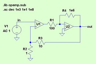

This is a small signal amp - so the output would be fed via an isolating resistor - e.g. 20 to 50 Ohms. This would remove any problems with load capacitance - I should have shown that in the circuit for completeness.
If you are interested, there is another way to do what I think you are trying to do. See conceptual circuit below. Might be simpler to implement and will be very stable. That is to use a wide-band differentiator (U1) feeding an op-amp (U2). Varying R4 will vary the feedback factor without changing the GBP. U1 can be a transconductance amp too, or a discrete subtractor like you have in your current design. U1 needs to have a GBP greater than U2.
