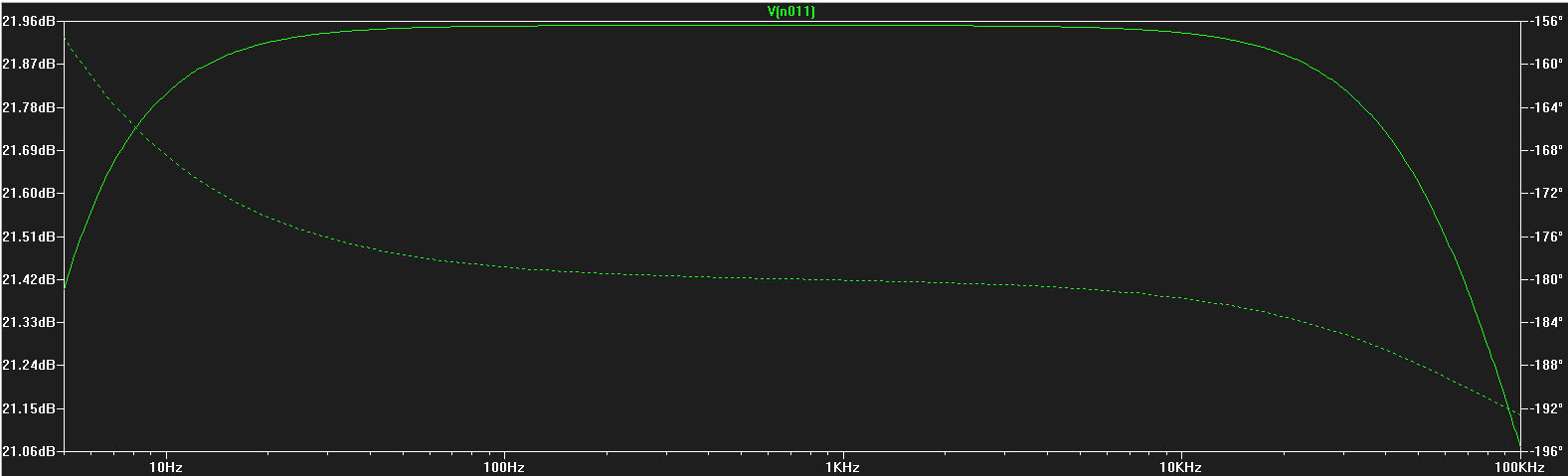

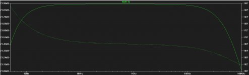

I was idle so decided to find out what this simulator does - came up with an exercise in gain/bandwidth - thought I'd ponse around with a few circuit ideas.... I initially had a line input stage in mind at first.
I thought I'd go whacky and wierd and use something often done in RF amps -- use the emitter as the inlet ....what fun .... now I'm having coffee and cake.

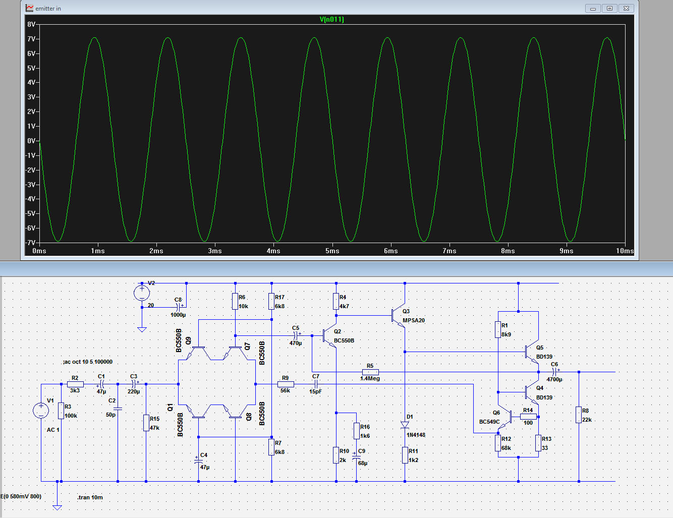

As I said I was just mucking about with a semi daft idea of having a common base input for a line board.
Common base mode is not generally used in audio. Common base mode tends to feature in FM radio designs as the input from the antenna - the bandwidth is extreme and input impedance is very high, before FETs were commercially available. If one were to remove the front end... remove C7 drop the value of C9 and reconfigure the input values for maximium gain - this will operate well into the RF

Have you measured the input impedance 😉
Collector of Q7/8 ?
That would make the input impedance zero, Mooly -- it's not zero
or were you joking?😉

Q7/8... Collectors have no DC path anywhere.
Q6... looks like you are attempting a constant current source... look at the value of R12.

Ahhhh I see what you're getting at 😉
Yup - it's not a CCS - its only a neg feedback inject, playing with gain/bandwidth product - infact if I put a path right there to DC, according to simulator gain reduces and bandwidth reduces because then it is decreasing input impedance.
If I remove that feedback path entirely - the gain remains the same - but bandwith goes beyond what I think the BD139s are capable of - it potentially shoots off to 30 Mhz. Be great as a first stage of a radio. Which is where I was wondering if this simulator thing is picking up the Base emitter and collector base capacitive properties in the junctions? I'm suspecting not.
