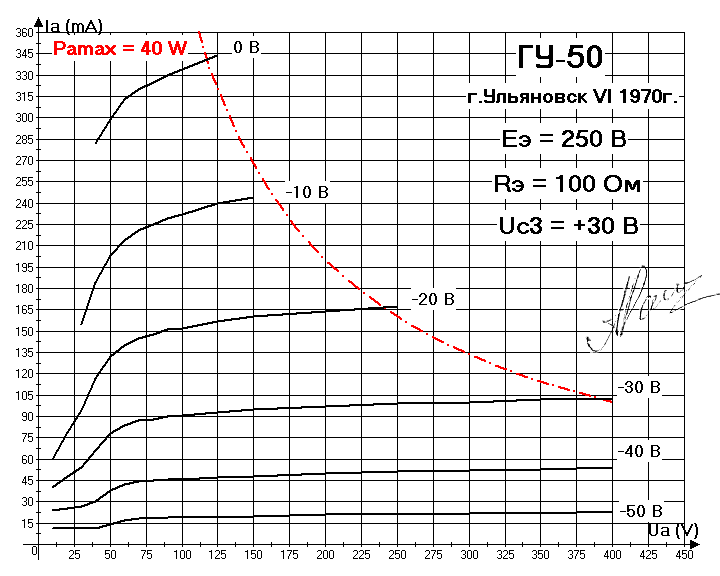

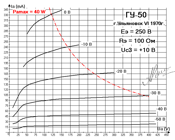

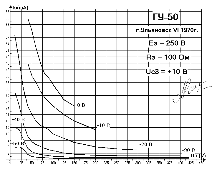

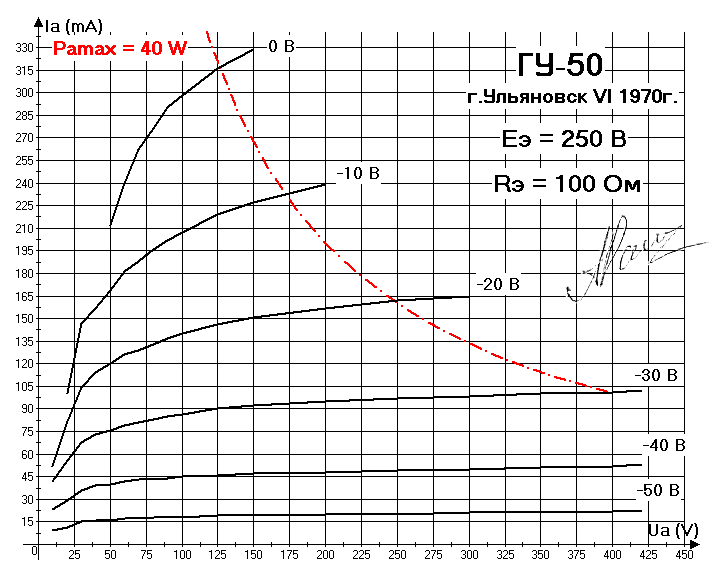

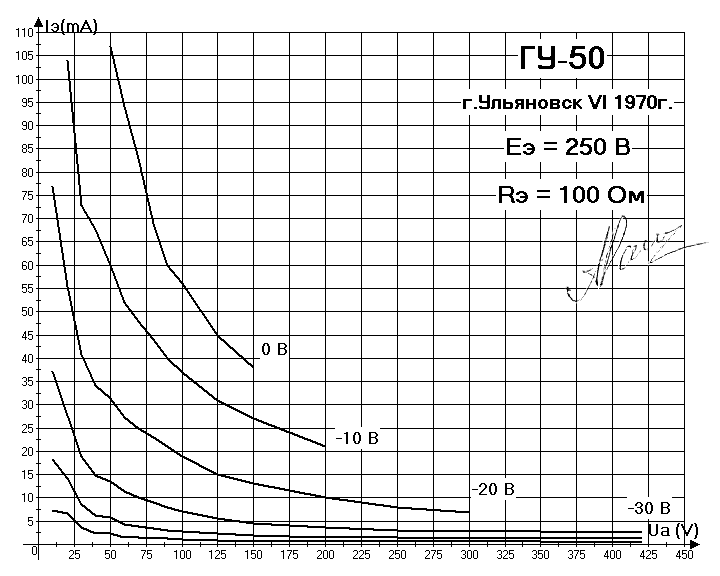

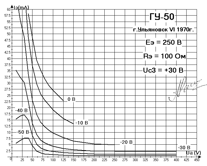

In attachment you can find the datasheets of the different names given to basically the same tube (pdf files), plus (jpg files) curves of it at different positive g3 voltages (curves square up and the screen current decreases).I have never seen a GU50 so I have no real experience with them. What are you trying to do with it? Can you post a data sheet?
I would like to build a push pull amp with a sextet of them. Now the best attempt (on LTSpice) is to apply 20% UL with a tertiary winding for screens, and supply the PI from those UL taps to give shunt feedback to GU50s' g1 through power drive (à la Baby Huey) going into AB2. No gnfb, but a small amount of variable current feedback from OT secondary tap to PI.
Your solution would simplify the power supply (no more need to have +-3 times the bias to supply the powerdrive) and the output transformer as well (no more need for tertiary winding), so will reduce the cost of this "experiment".
