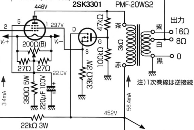

Just found this diagram in the Japanese schematics and designs published today on this forum.
I guess it could be used too for using the ultralinear tap to feed G2 with a somewhat lower voltage than B+. For example use a KT88 with 560 VDC B+ and 400 VDC for G2. G2 could still follow the plate’s swing.
Has anyone tried this ore something similar? What can be expected?
Regards, Gerrit

I'm sure that this circuit would work, especially with a TV sweep tube or other tube that likes a low screen voltage. The screen voltage in this circuit will always be less than the plate voltage, and quite low when the plate is pulled toward the cathode due to the voltage divider tied to ground. One can tie the ground end of the divider to B+, but that can create it's own isssues.
There has been considerable discussion and experimentation with variations on this concept scattered throughout this forum. One thread is here:

The technique can be made to work if the voltage ratings of the Mosfet can be contained and the tube g2 max voltage rating obeyed.
Dividing the plate voltage down with the R divider for a lower g2 voltage will increase the effective triode Mu above the intermal value and raise the triode's plate resistance too. Not generally desirable for an efficient power tube. Power output is greatly reduced with the g2 Volts dropped severely when maximum current is called for. Many TV Sweep tube internal triodes also have 2nd harmonic roll-over in their curves, which the simple R divider UL scheme does not fix.
Using some "shunt Schade" N Fdbk can get you a better effective triode, since the plate resistance goes down (effective triode Mu goes down too). The g2 voltage can then be set for optimum power output at max plate current too. Making the tube more efficient for power use. The 2nd harmonic rollover in the triode curves gets improved too with "shunt Schade" N Fdbk.
However, then you have a low impedance point to drive with a current source for input.
Another less obvious distortion problem shows up with the "shunt Schade" scheme due to the N Fdbk resistor current being proportional to Vplate - Vgrid, instead of just Vplate. This can be a problem with low gm tubes where the grid drive V can be significant. (grid 1 tends to be near a square law transfer for power tubes, so the grid1 V tends to be proportional to the SQRT of Vplate for a presumed linear output)
Putting a P channel Mosfet cascode stage in series with the "shunt Schade" N Fdbk resistor can fix the grid1 V interference, changing the N Fdbk to a modulated current source, proportional only to plate V.
I've been playing with a variant of this "corrected Schade" scheme that puts the P Mosfet in a different position to isolate the grid1 V from the N Fdbk, and provides a high input Z. Still in progress.
Probably some circuit trick(s) could be applied to the original above posted attenuated UL scheme too, to improve that. Will be interesting to see what George has come up with there.

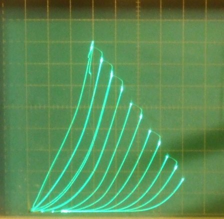

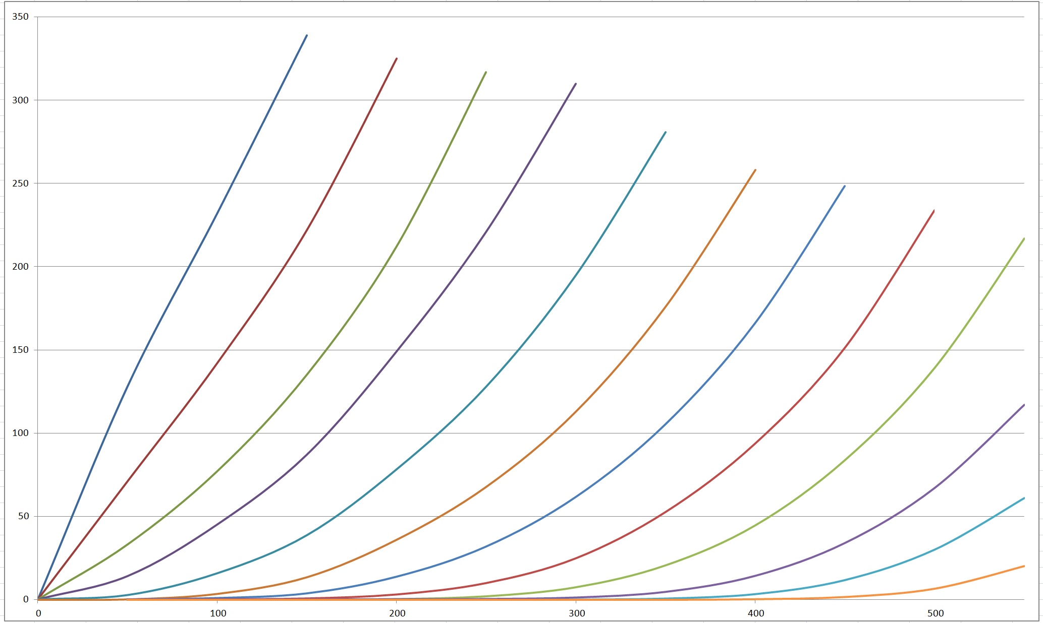

Here are some "triode" pics for the 21HB5A TV ($1) Sweep tube, using different techniques.
All are 50V/div Horiz. and 50 mA/div Vert.
1) triode mode (g2 conn. to plate), 5V steps (the ultra-linear/Mosfet scheme will normally give the same shape curves as triode mode, just higher Rp.)
2) Corrected shunt Schade, 6.25V steps
3) normal shunt Schade (old pic, no data)
Notice the lack of "roll-over" or distortions in the Corrected shunt Schade.
That's 1/2 an Amp at the screen top. Try getting that with a 211 and 350V B+.
Corrected Schade uses the same electrode (grid1 to cathode) for both N Feedback from the plate, and the Hi-Z input drive. Without Vg1 getting into the N Fdbk current.
Even a DHT has some distortion from the g1 transfer not quite matching the plate (or g2) transfer function. Later, higher gm tubes have a greater mis-match between g1 and g2 leading to obvious "roll-over" in their "triode" curves.
Corrected shunt Schade fixes that completely, even for $1 beam pentodes. And has a hi-Z input with good sensitivity.
DHTs are HISTORY

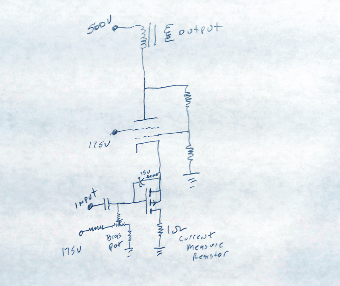

Hi smoking-amp, can I ask you a sketch of it to perform some simulations? ThanksPutting a P channel Mosfet cascode stage in series with the "shunt Schade" N Fdbk resistor can fix the grid1 V interference, changing the N Fdbk to a modulated current source, proportional only to plate V.

Sorry but I am a little lost in how you implement "Corrected Shunt Schade" feedback. Could you give us a drawing, would help greatly.
My flat bed scanner is down at the moment, but I will start a thread on this in a week or two. (have to do taxes yet! was hoping Covid 19 might take out the IRS, but no such luck)
First, a brief history of how this developed. I was following the thread below by SpreadSpectrum using "shunt Schade" using an Op Amp V to I driver:
Shunt Feedback 6384 SE Amp
The irreducible distortion that remained led me to consider if conventional "shunt Schade" maybe had some "bug" hiding in it. And I soon realized that it does.
As mentioned above, the input Vgrid1 corrupts the current through the shunt plate N feedback resistor. I = (Vplate - Vgrid1)/ R. Especially for a low gm tube with large grid1 V swing.
So the 1st version I tried was to put a P-channel Mosfet cascode stage in series with the feedback resistor. This just uses a P Mosfet with Source connected to the bottom of the feedback resistor, and the Drain connected to Grid1, with a second Schade divider resistor from grid1 to a minus biased V signal source ( to get the grid1 voltage into a normal bias range.) -Or- use a current source driver from some -V up to grid1 as is typical for "shunt Schade" (with enough idle current to get the grid V into the -Vbias operating range.). Then a fixed voltage of roughly +25V on the Mosfet Gate for cascode use, with some Gate to Source Zener protection for start-up. The Mosfet cascode stage still puts out the same feedback current regardless of what voltage the grid 1 has on it. So this eliminates the drive signal polluting the N feedback signal. The sum still obtains at the grid 1 of course.
(I used some variable power supplies for all this, so voltages are estimated)
This worked well to fix the plate curves, but this still has a low drive signal input impedance.
With a Mosfet in the parts list now, I then thought if there might be some way to get a high input impedance as well. Driving the Mosfet gate with the input V signal unfortunately gets one back to Vplate - Vgrid for the feedback current. So that was out.
Then a stroke of "genius" struck. Why not just make it a -series- Schade by putting the P - channel Mosfet under the tube cathode as a follower (source terminal to cathode). So now the input signal goes thru a P - channel follower to drive the cathode.
The old "shunt Schade" feedback, via the resistor from the plate, can just go directly to the grid1 now, since no input drive signal V appears at grid1. A divider resistor from grid1 to some negative V (like -100V) forms a voltage divider for the grid1 N feedback. (the minus V adjusted to get grid 1 into a normal operating bias range) The P-channel Mosfet follower has the same or similar neg. V on it's drain for its operating range.
So this ends up operating just like series Schade N feedback, except an R attenuator is used, instead of the interstage xfmr in Schade's paper, to develop the grid1 feedback V. Note that the tube is now non-inverting. Input signal impedance to the P-channel Mosfet follower is a high Z. And the P-channel Mosfet does not require a particularly high voltage part, just sufficient V to handle the usual input grid voltage swing safely (now appearing on the cathode). The tube transconductance, being much lower than that of the Mosfet follower, sets the tube operating current versus input signal V still, so this should still sound like a tube.
Some interesting advantages gained are that the tube now gets effectively -increased- plate V and -increased- screen V when delivering maximum current. (via added cathode V) You'll notice the above "triode" curves pic can deliver decent current at low plate V, better than most triodes. (in fact, equal to the hidden pentode used)
I'll be curve tracing some other TV Sweep tubes using this scheme next week or so and posting a thread and schematics. Eventually a SE "triode" amplifier and then a P-P version will be tried to check sound quality. The plate curves do look nice.

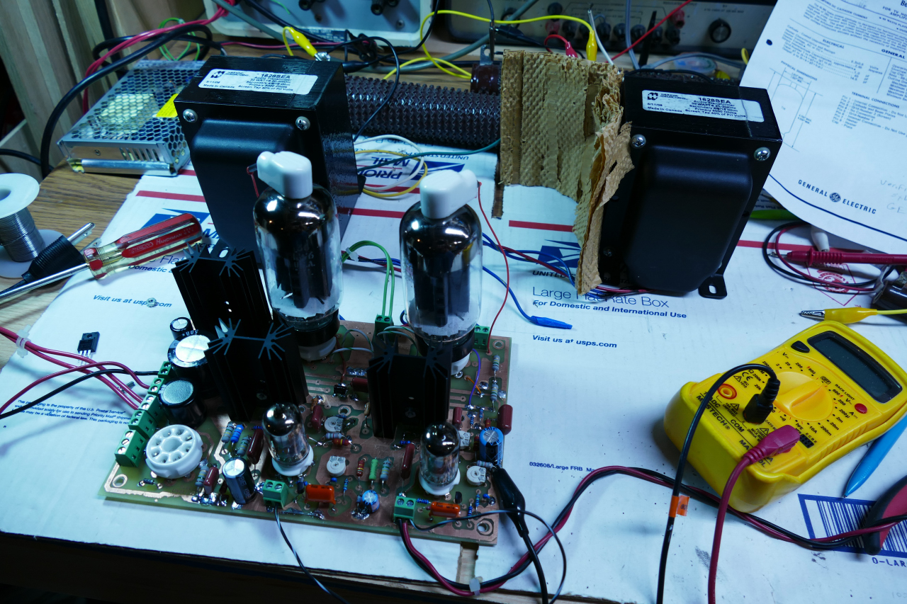

I made a board almost 10 years ago with a mosfet on every element of a TV sweep tube except the plate. It has been the subject of several experiments over the years, most ending in frustration usually because I succeeded in making some excellent TV jammers or turned mosfets to dust and even made two 6HJ5's explode violently.
I got a Vacuutrace about 4 years ago which helped, but actually delayed the cathode drive experiments since it can not step the "grid" voltage positive. This may be an issue with your curve tracer too.
The only disadvantage to this technology is that real bad things happen when the mosfet shorts and the sweep tube tries to suck 5 amps of plate current from a power supply with 1000uF of output capacitance set at 500 volts. That makes 6HJ5's explode!
Many P channel mosfets have a limited SOA and tend to fail to a short. If you choose to play with this tech, start with a Fairchild / On Semi FQPF925. They live in the cathode of a 36LW6 making 30 WPC in SE on 550 volts into 2500 ohms. Set the grid resistor ratio to about 11 to 1 (300K grid to plate, 30K grid to ground). I use 175 volts on G2. I have had this combo to 40 watts audio output, but the 36LW6 was eating about 85 watts at idle and was very mad....red faced kinda mad!

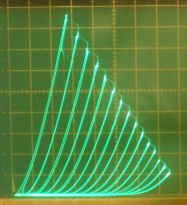

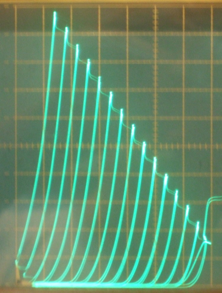

This circuit results in nice triode curves from a TV sweep tube with 500 volts on it's plate and 175 on its screen. I have called this a Composite Electron Device, and I have three working amp designs operational using it.
I have had to trace the curves manually with adjustable power supplies since the Vacuutrace can't do positive voltage steps. The CED simulates well in LT spice, but all voltages are IN PHASE so it takes a bit of getting used to. It works well for low level stages too, and G2 in the driver can be used for some additional negative feedback input in a Push Pull amp.

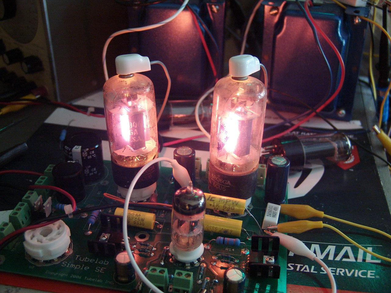

The UNSET amp that I have been working on uses a small high Gm pentode driving a big TV sweep tube. Both are set up using the CED to emulate triodes in a SE Triode design, but no triodes are used in the amp, hence the term UN SET. The final prototype version is being built now, and if there are no issues, I will order a batch of boards and it will be the next Tubelab board.
The CED does NOT work in an LTP stage since no phase inversion takes place. This makes an all CED push pull amp a bit more complicated....or not.
I have done several different circuits, some that work better than others, but the best design so far is a CED input stage for voltage gain a split load phase inverter using a mosfet, and a pair of CED's in push pull for output. Three tubes per channel, making 75 watts from $3 worth of tubes!
Included is the basic CED schematic. Pretty simple, but works. The curves are from a $1 6GF5 wired as a CED. The uneven spacing is due to my hand turning the power supply voltages on the gate terminal. The steps are positive with zero volts being max current (blue line) and step size is 5 volts.
The board is a prototype UNSET amp. Some more info and test data is here:
UNSET is coming?

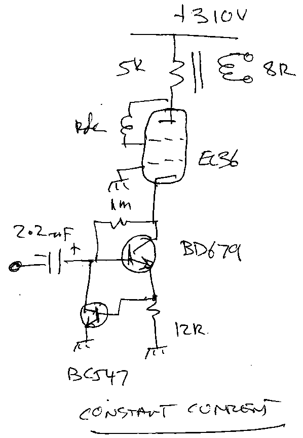

It's a bit like setting the feedback ratio in my p-channel follower driven amp. My experience there was that setting it for over 30% feedback starts requiring big supply voltages to get the bias right. Of course, a cap can help but I don't like extra time constants in the feedback unless I have to. (Plus then you have a bias resistor stealing current from your feedback network again.)

Interesting that we arrived at the same circuit (other than some minor DC level shifts) from completely different angles. I would never have guessed there was a problem with typical "shunt Schade" until SpreadSpectrum did his design. Basically the same circuit is used for inverting Op Amps all the time, but they have huge gains, so input V swing pollution is not an issue. Single stage tube gain however is another matter, and requires some re-thinking. Shifting to a series Schade topology to get high input Z then struck the same Gold George found.

I don't really need any more Sweep tubes, unless it is cap-less. But I'm curious if I've seen data for it at least. Maybe starts with an M or 8 ?
Can I ask you some information on how to set the voltages for a GU50 with 900V on plates?
I cannot get good results. Thanks.
Is it on this sweep tube list?
No.
It has a plate cap and a regular type number. It can be found in an old RCA receiving tube manual. I still have the paper book that I bought new at the Lafayette Radio Electronics store in the early 70's. I had that thing memorized back then, but 50 year old memories are somewhat fuzzy now, so I keep a PDF RC-30 on my PC along with some others.
I have never seen a GU50 so I have no real experience with them. What are you trying to do with it? Can you post a data sheet?
the GU50 used a different socket the plate is far away from the cathodes and filament pins and so running it at high voltages is not a problem, Anatoliy aka waveboure made such an amp....running plates at 800 vdc...
