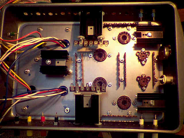

Baking pan ala g2/g1
Well, I've got the sheet metal work done for a test jig. Baking pan ala g2/g1 drive mode.
Two OTs. One 100 W 4.2K P-P for starters (3.3K and 5K standing by), the other 25 W 8K is for an initial driver plate load. Heatsinks are for Mosfet grid drivers and a CCS driver tail. I'll probably change over to gyrators for driver loads eventually, like Michael's. The 2nd small OT will then be for the cathode CT choke for an elliptron mode later yet. Extra mountings already there for an anti-triode heatsink also. 6HJ5 finals for now. 6GF5 drivers for now. Optional 6LU8 drivers later or 9 pin 9DX base pentode + triode driver sockets in place also. So many variants to try out. I may have to build up a second test jig just to compare design changes.

I may build some finished amplifiers later using some real nice bake pans I found at K Mart lately. They have heavy duty aluminum and steel bake pans for around $13. And a shallow pan of same type which would work for a bottom. I'm thinking maybe space them apart 3/4 inch with spacers, put a clear strip around the gap and blue LEDs behind to light up the inside. That levitated blue glow look.
