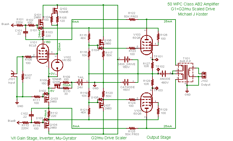

G1=G2/mu Scaled Drive Strawman Design
The basic idea comes from smoking-amp in another thread:
http://www.diyaudio.com/forums/tubes-valves/160240-suppresor-grid-used-feedback-10.html#post2098113
The linearity is similar to screen drive but the voltage swing required is much less.
I adapted an amp design I've been developing to try out the concept. I haven't built it yet; still in the conceptual phase.
The basic topology is class AB, local current feedback loading a pentode+MOSFET CCS LTP gainstage and inverter with gyrators in the anode supply. Current feedback is derived across R122 and R125
The screen drive method borrows from some class A2 amps I've built, using the "mu output" of the gyrator for super-low drive impedance.
The scaled G1 drive voltage is generated by voltage divider R115, R116 from G2 to cathode. This is then buffered by MOSFET source follower Q106. There will be about 5V offset G2 positive WRT G1 in addition to the scaling this way (not sure of the effect...)
I show a stacked power supply arrangement with a third grid drive supply returned to the output cathodes. This keeps the grid current local to the output tube loop from grids to cathode. Other arrangements are certainly possible but I have had good results with this.
I guess the 6DQ6 gm to be around 3500-4000 wrt G2 using scaled drive, resulting in an effective anode resistance of 250-300 ohms in this circuit, hence the 6K6 OPT Zpri giving a damping factor of say (300+DCR) /1650 or about 5.
I think the sensitivity is about 2VRMS input for full sinewave output of about 50W. That can be tweaked by replacing all or part of R108 with diodes.
Comments or suggestions are welcome!

Michael,
Interesting design. I see some anti-triode driver snuck in there too.

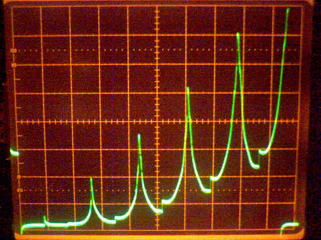

Well I haven't done much thinking about it yet, but I do have hardware. In this case it is an ugly sky wired breadboard that never worked being given one more chance at life. I know that one or more mosfets are blown (there is a crater in the plastic) so I need to replace them all (4). I plan to wire this up to my octal driver since it works good. Output tubes? Something octal, cheap, and plentiful (not 6HJ5), maybe 6BQ6's, 6L6GC's or 6AV5's.
I have several "HoneyDo" projects lined up for tomorrow, but they are all outdoors. Lets hope it rains, it rained most of today.

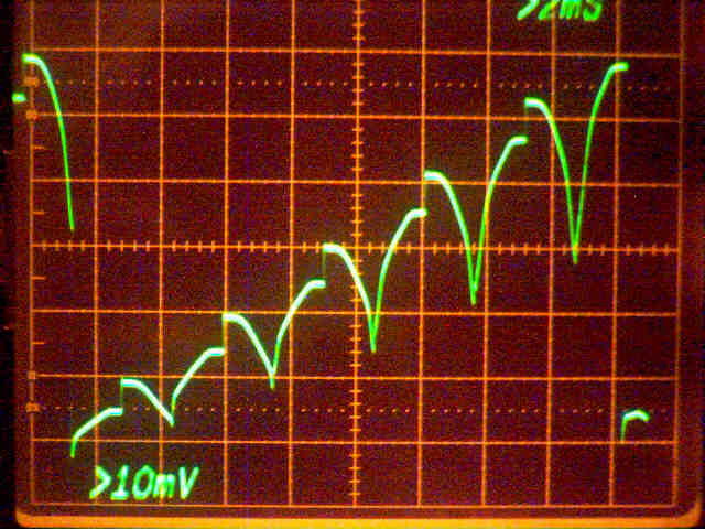

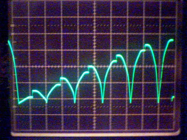

Here are some pics. These were taken on a timebase scope rather than the curve tracer, so are versus time rather than plate voltage as on the tracer. 11 stepped traces are sequenced, with every other one using an opposite 90 degree side of the power line sine wave voltage. There are actually two slightly different versions, since 11 does not divide out evenly by twos (rising and falling edges of 60 Hz may be reversed between sets) so some miss-match may be present between pics since 60 Hz sync was unknown on the scope. But general trend is obvious. ( I need to get the curve tracer set up to accept an external vertical signal so I can do regular grid current curves)
Current signals here was from a Tek AM503 DC current probe setup. Grid drives were 4 to 1. +55V max stepping on g2.
1) cathode current 50mA/div
2) plate current 50 mA/div
3) g1 current 10 mA/div
4) g2 current 10 mA/div
I'm puzzled by the cathode current and plate current traces, should be more similar I would think. Maybe I got the scale wrong on one. Well, at least one can see that the g2 current is the most spikey when plate voltage is low. Looks like g2 baseline current ramping is about half the g1 current ramp. Close to linear current ramps overall for g1 and g2, but some curvature upwards, probably a diode V/I curve. g2 looks more curved. g1 being closer to a straight ramp (resistive Z) is desirable as far as using just one Mosfet driver with a resistive divider for g1.

40K gate is quite a bit of external phase shift.
How does that compare with an internal mu?
Even a strapped triode...
For 300pF gate, I compute a 13KHz corner.
Though that doesn't take into account the
50K source follower load.
The resistive divider in the previous pics was approx. 300 Ohm from g2 to g1 and 100 Ohm from g1 to cathode. The 300 Ohm was adjusted until the voltages on the grids were 4 to 1. With 55V max stepping, that would be 137 mA thru the divider alone. But g1 is drawing about 80 mA max. Not a problem if it is a linear Z, since the attenuator was adjusted for a 4 to 1 result, but since it is not strictly linear, it may be causing the straigtening of the g1 current curve, since it would reduce the divider ratio as it draws excess (above the expected linear ramp) current. Probably g1 is just as curved as g2. I'll have to rig up a Mosfet g1 driver to test it on the tracer again.
Hmmm, maybe it will eventually be useful to put some extra resistance in the g2 leg too. The non-linear current draw by the grids is self linearizing that way (versus the internal 3/2 power transfer function).

In retrospect, what you found makes sense, as the control grid is closer to the cathode than the screen, so it should draw more current for a given positive drive. The place to look for freaky behavior will be at screen voltages of about 100V or so, though with the scaled G1/G2 drive 50V is as likely to drive the tube as hard as 100V G2 drive alone. I'd expect to only see such excursions at or near clipping for sufficiently frisky drivers.

It looks to me like the cathode current is close to the expected sum of all other electrode currents. Peak g1 and peak g2 current are on the same order of magnitude as each other, but G1 seems more linear resistive and g2 acts more like a diode as plate voltage goes lower.
I'm not too worried about the G1 current, but the allowed G1 dissipation is not specified for sweep tubes. I am assuming it's good for at least one watt. The current would need to be >200mA at +20V peak to dissipate anywhere near 1 watt.
I think some trial and error is going to be needed; I will do a lot of in-circuit test and measurement. I will stick with the g1 follower for now so I can easily experiment with varying the DC bias offset on g1.

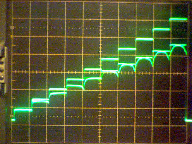

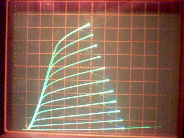

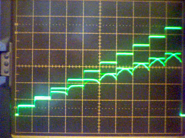

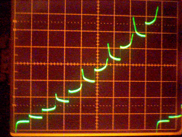

Here is a plot of actual g2 and g1 voltages using just the resistive divider to drive g1. I adjusted the divider to get twice the current level of plate curves with g1 and g2 versus g2 only. Then I checked the divider resistance, and its running at 268 Ohm from g2 to g1 and 100 Ohm from g1 to cathode. Tube Mu is nominally 4.2. So would expect 300 Ohm and 100 Ohm if g1 weren't drawing current. Can see from the plot that g1 voltage is drooping at higher stepping levels. I adjusted the attenuator on the scope to get matched 1st step levels between them. Or put a ruler to the g1 steps and see the droop.
Scale on the g2 curve is 5 V per div. according to the scope (but 5.3 V steps according to the curve tracer, someones calibration?), g1 curve should be about 1/4.2 of that, the variable attenuator was used on g1 to get a match.
I just checked the tracer step output using a DVM and get 3 V steps. Looks like the scope is right. Which means I've only been getting 30 V max for 10 steps.
Ugh, just found the problem, the variable step gain control on the tracer wasn't at its max setting.
I'm going to set up a Mosfet follower for g1 next.
Re-did the g2 and g1 voltage plot for 6HJ5 with the max step setting of 5.3 V steps per the tracer (6V steps per the DVM, and about 5.9 V steps according to the scope). Vertical scale here is 10 V per div. (scope) for g2. This is using the same resistive divider for g1 again.
The jaggies in the g1 curves on each step are from when plate voltage is near zero (occurs on leading or falling edge depending on the phase of the 60 Hz plate voltage).
Clearly, g1 voltages are drooping off with high g1 current and/or low plate voltage, when just using a resistive divider.

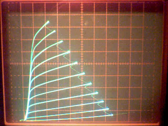

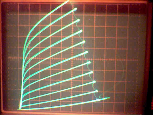

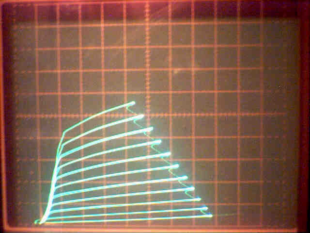

Here is Mu scaled g2,g1 6HJ5 with a Mosfet driver for g1 now. 50 mA/div vert. and 50 V/div horiz. 5.3 V steps on g2. Approx 4/1 scaling. The divider is still between g2 and cathode here, but g1 is buffered by a Mosfet follower (which has a few volt gate threshold unfortunately)
2nd plot is the earlier resistive divider curves. Same setup except no Mosfet driver.
Looks like the Mosfet driven g1 curve set is more squared up (no more g1 sag at low plate V). The lower bunched together plate curves are due to the Mosfet turning off below its gate threshold, so only g2 drive there. I'll have to rig up some DC biasing for the g1/Mosfet next, to fix the gate threshold problem.

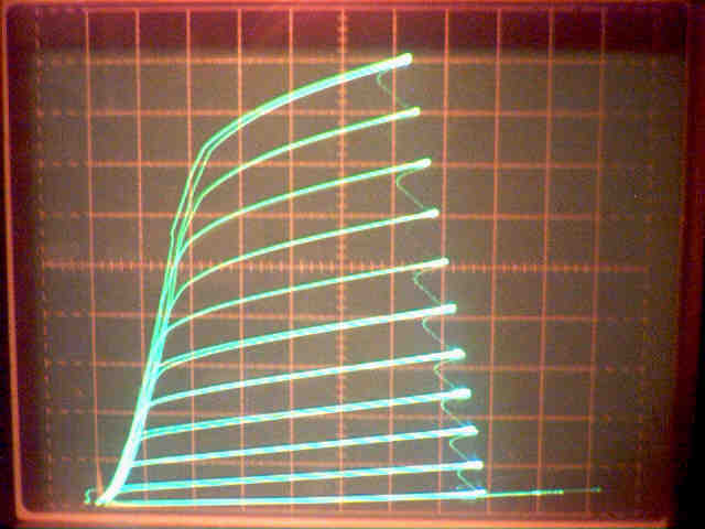

Here is the scaled g2,g1 6HJ5 using Mosfet drive on g1, with DC biasing to fix up the Mosfet gate threshold.
I ran into a problem here though using a cap to couple divided down g2 signal to the Mosfet gate. A protection zener diode across the Mosfet gate to source conducts when the drive signal is large enough, changing the charge on the cap (a blocking problem). I have a 2.7K Ohm resistor loading the Mosfet source to 0 V at the cathode, which provides the conduction path when AC drives it below 0 V. I was able to adjust the bias upwards (half of AC signal approx.) to get things to work, but if I change the # of steps on the curve tracer, I have to re-adjust the DC bias every time. Not good for real signals.
SOooo, either I have to return the Mosfet loading resistor to a negative (more than -1/2 max peak drive AC on g1) voltage to avoid blocking, or go with some type of DC coupling offseted to fix the Mosfet gate threshold.
Another problem also came up too. I had to operate with reduced g1 AC (1/6 of g2 AC here for the plot shown) in order to avoid some kind of saturation problem of the tube plate current. (I had plenty, 36V, of g1 Mosfet drain voltage to avoid saturation there) The top curves start bunching together (at the low plate voltage end of the curves) if I increase g1 drive beyond 1/6 of g2. Not sure what the problem is yet. Maybe g2 starts eating the plate current too much? More testing in order.

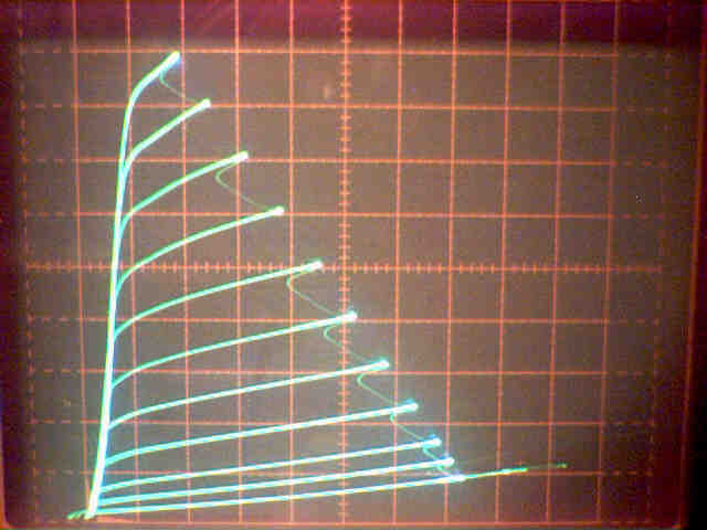

Since Michael is using 6DQ6 outputs, I dug out some 12GE5s which are essentially the same tube as 6DQ6B or 6JN6A. This tube has a Mu of 4.4, 17.5 Watt diss. rating.
1st plot is operating in scaled g2,g1 mode with the Mu divider at 4.4 and using a Mosfet driver with gate biasing. Scale is 50 V/div horiz. and 50 mA/div vert. 5.3 V/div stepping. (usual 50 Watt peak load limiting on the tracer)
2nd plot is with 220 Watt peak load limiting on the tracer (140 Ohm load resistor), same vert and horiz scales, same 5.3 V steps and Mosfet g1 driver. Mu divider was 79 Ohms from g2 to g1 pickoff and 100 Ohms from there to cathode.
Hey, you ought to be able to get 400 Watts out of these in P-P for a few seconds at least.
