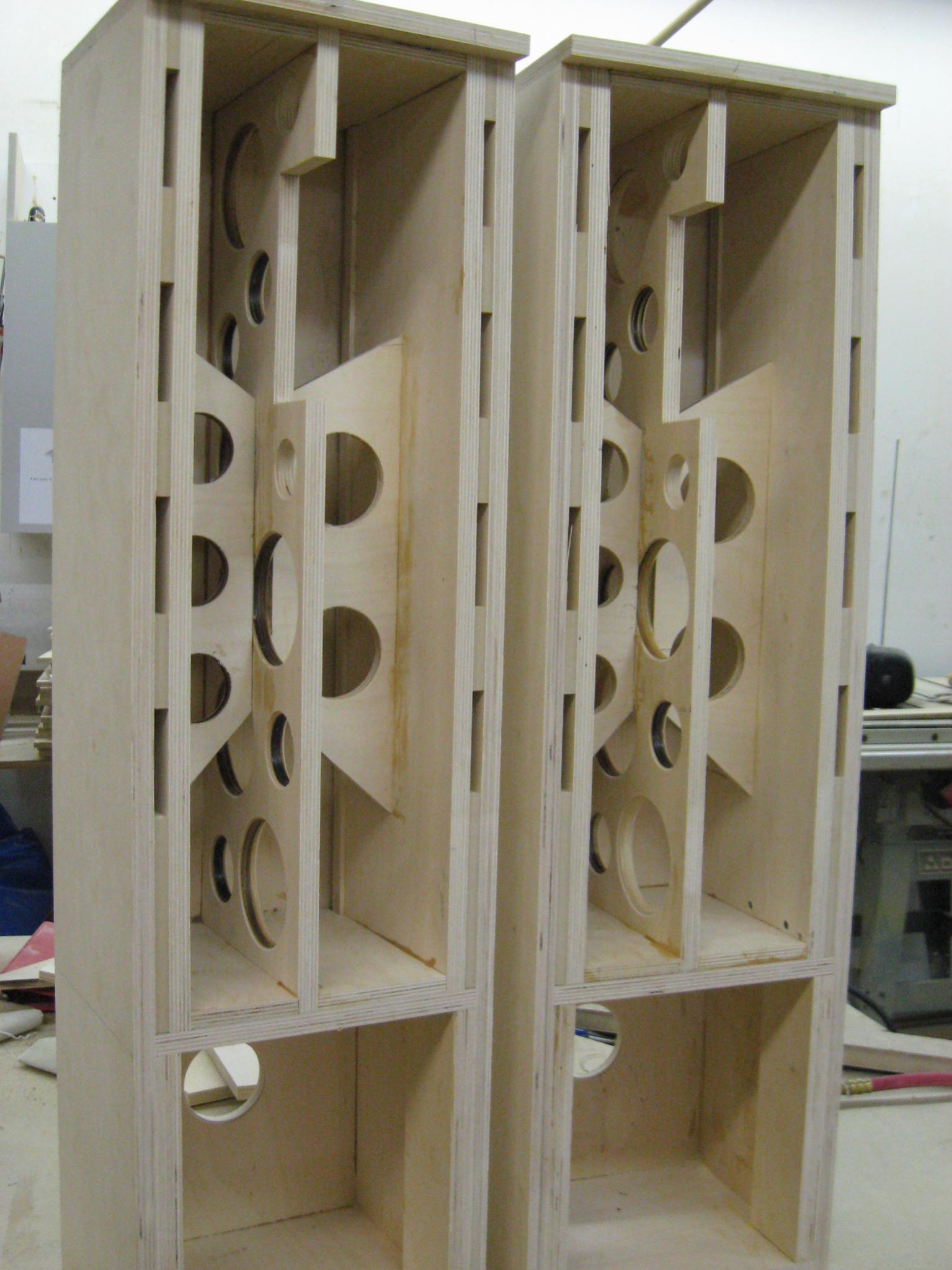

also i read its worth adding an internal brace, is there a specific design to follow for this?
see Jaguar - page 7 of attached plan set
http://homepage.mac.com/tlinespeakers/FH/download/English-Auto-Series-061109.pdf
Note that this type of combined driver / enclosure bracing is assumed for all Planet10 / Woden designs, and occasionally gets overlooked on the drawings.
The main features of this bracing scheme are:
- tightly couple as many surfaces as possible with a single panel (generally 4 for vertically oriented braces and 3 for horizontal, as well as driver magnet
- for very large/heavy drivers a notch or cradle to support magnet is handy, but rather troublesome to fit
- on very tall enclosures, staggered interlocking or additional braces perpendicular to the main brace can be beneficial
- vertical bracing is preferable to window-pane horizontal bracing for MLTLs etc,
- offset from vertical center line, generally by thickness of material,
- openings in brace don't need to be holes (if you have access to a CNC router you could go to town on size / shapes)
- don't occlude internal openings of vent or horn throat, etc with bracing or damping pads
attached is a completely different enclosure design type for FE167E, but gives a general idea of bracing scheme
