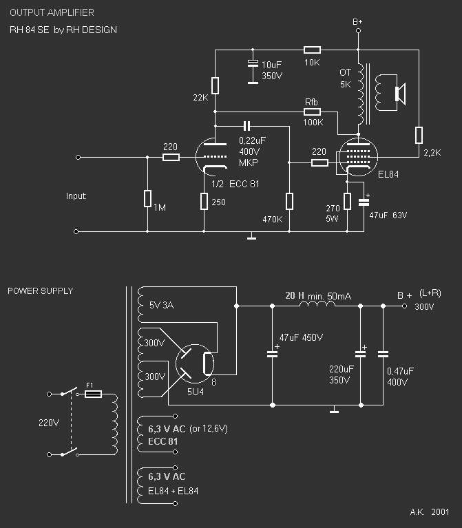

I've attached the RH807 as well for an Se option. Wavebourn will no doubt chip in about the triode driver here...

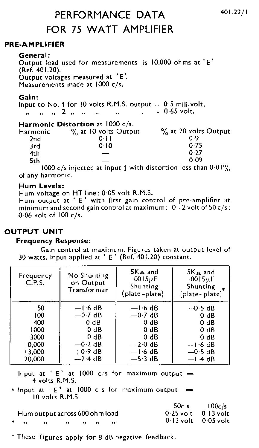

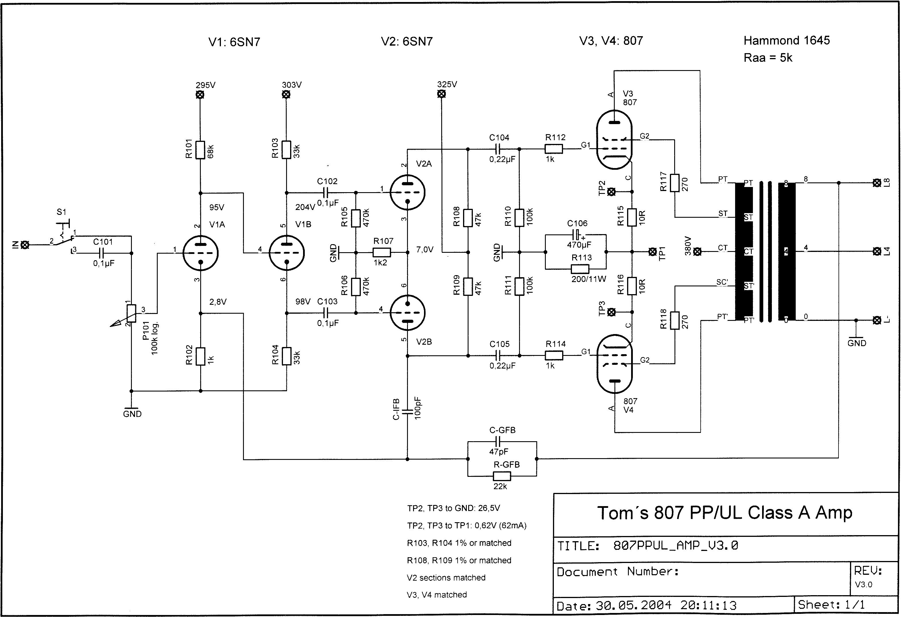

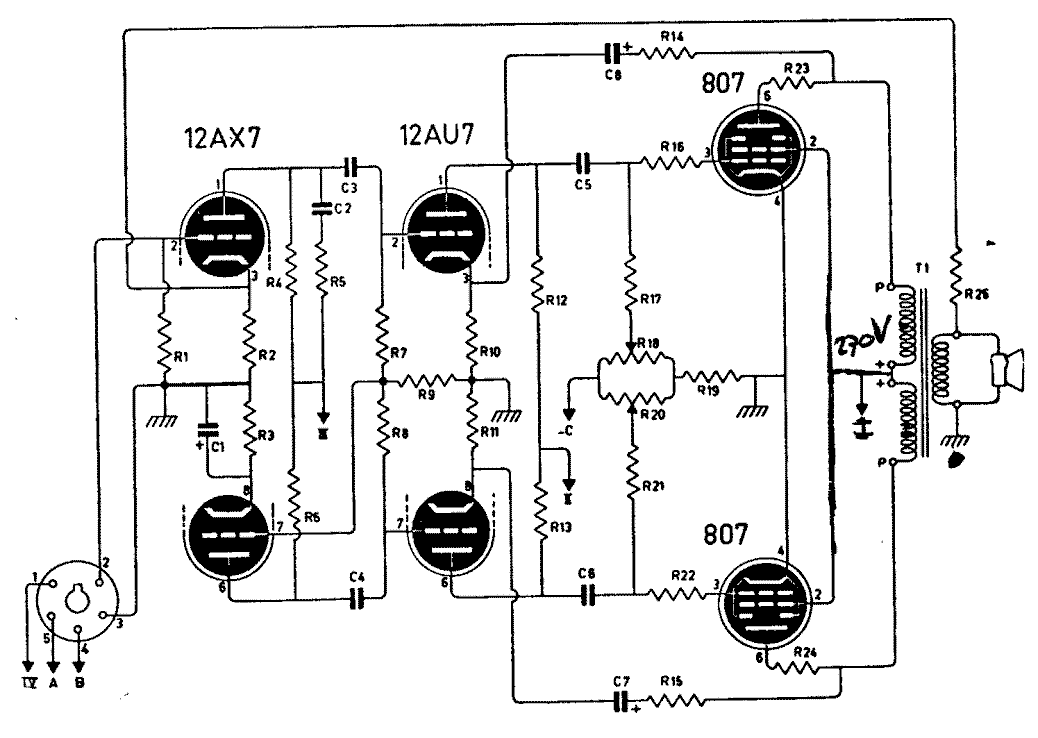

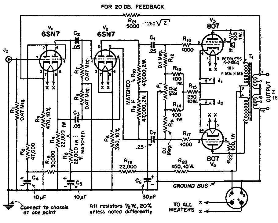

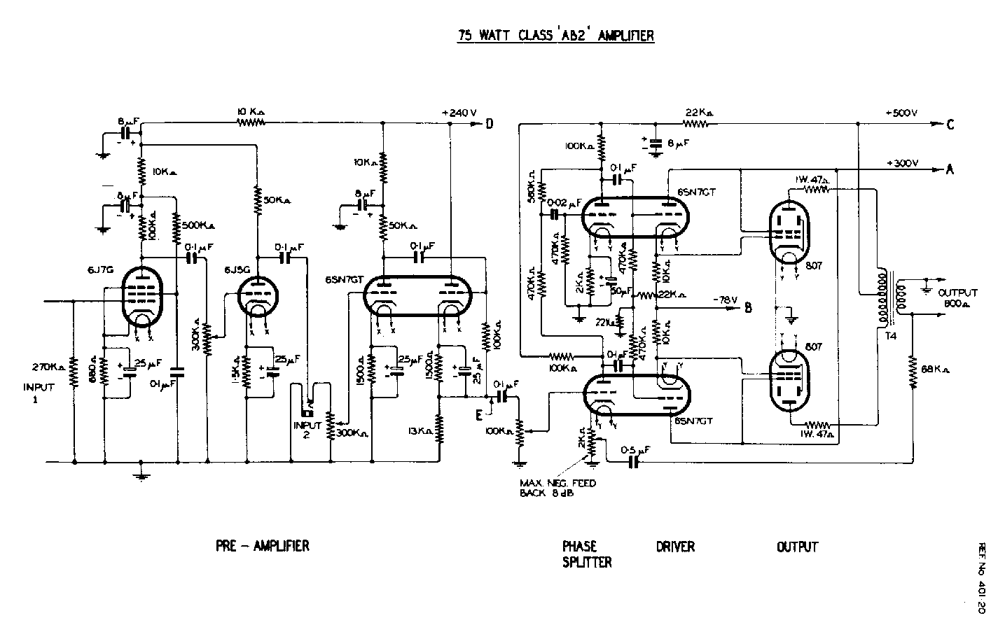

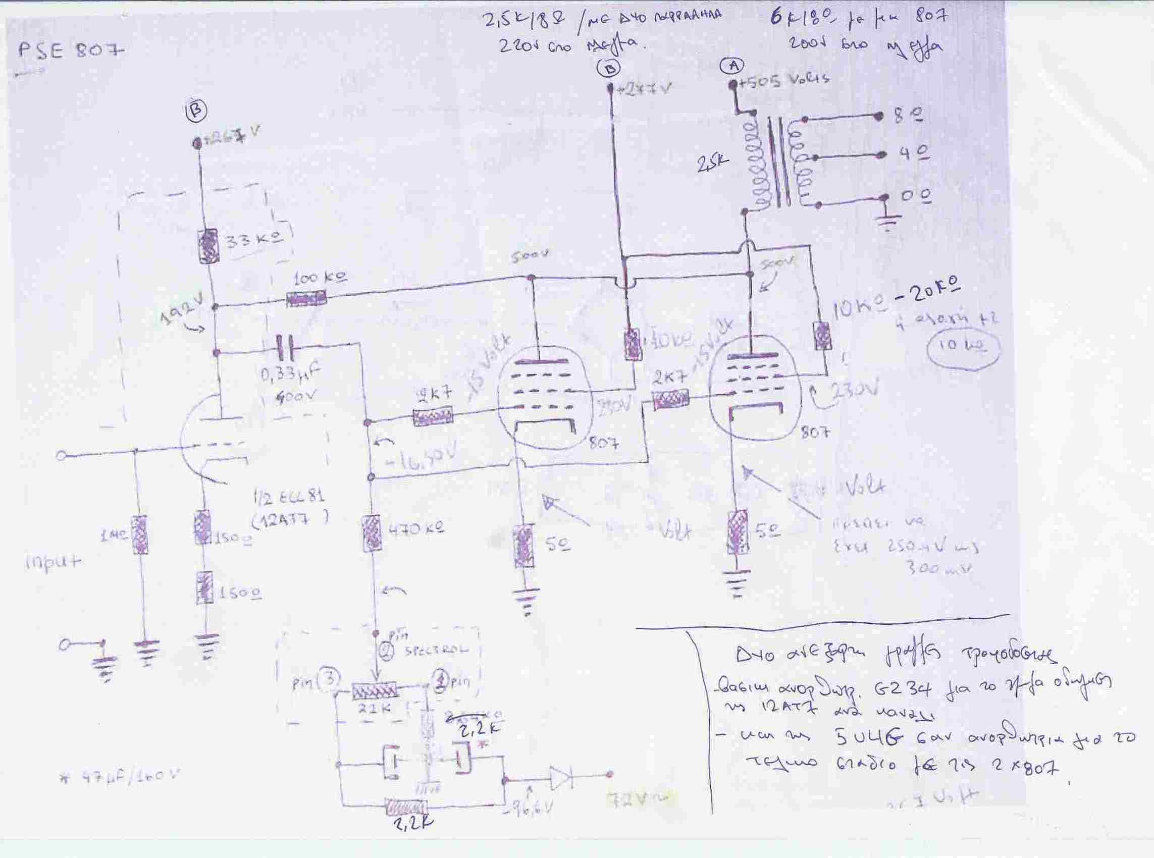

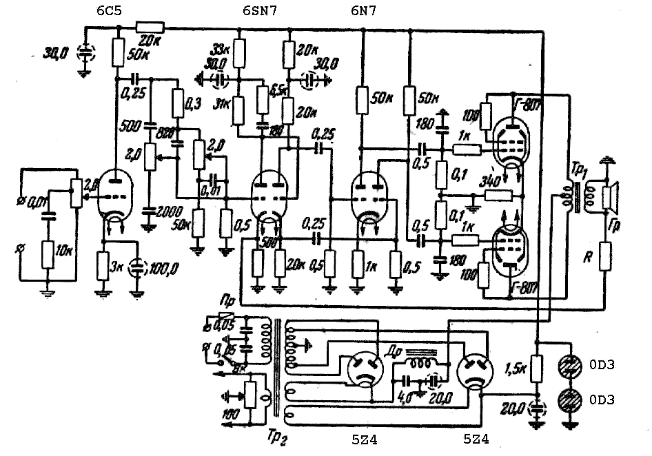

These are the schematic that I have
