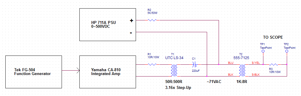

I got to thinking that this $12 30W line-matching transformer might work okay as a single-ended OPT, so I collected a few measurements to share. Test setup is in the first attachment.

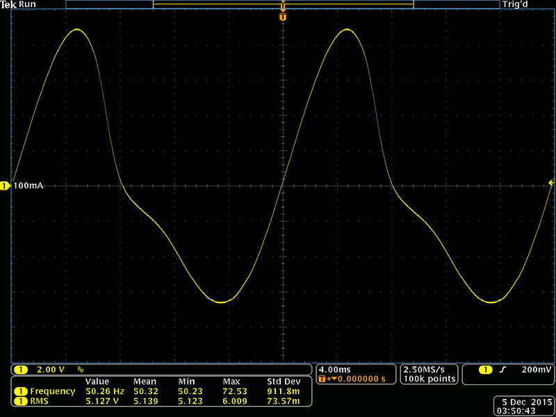

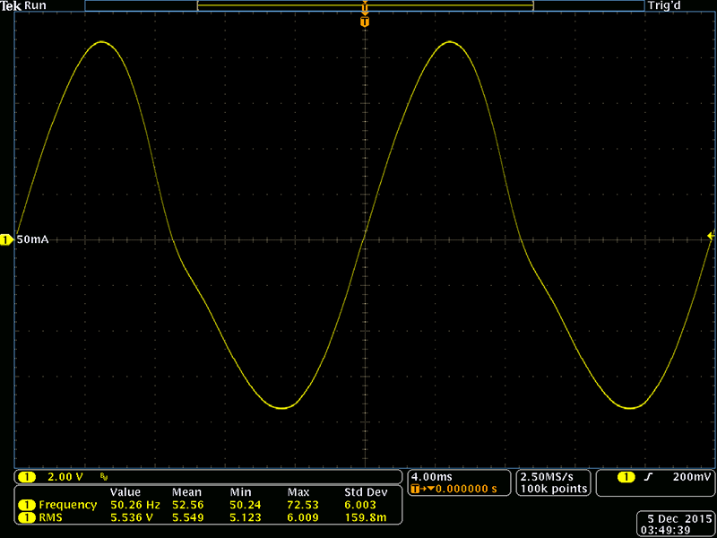

I applied roughly 71VAC (200Vpp) at 1KHz to the 5W primary tap. Primary impedance is nominally 1K at that tap, which includes the whole primary winding. I worked my way down below 100Hz, checking the secondary side waveform for visible distortion with primary DC bias up to 100mA. See attached waveforms, which are annotated. It seems clear that feedback will be necessary to achieve decent LF performance anywhere near 5W, but this could be a challenge worth pursuing.

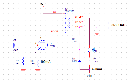

I might try a completely different approach with this little hunk of iron, however: magnetic field cancellation. The secondary has two taps, both for 8R loads, providing hookup options for 70V and 25V distribution systems. The 25V tap has a Pri/Sec turns ratio of about 4, which presumably means that core magnetism nulls with secondary DC bias current 4x primary current. I reckon that a current source to the 25V tap would need +/-25V compliance for 5W output to 8R on the 70V tap. If primary current is, ferinstance, 100mA, then a simple SS current source of 400mA would only have to dissipate 10~20W depending on its power supply voltage and allowed headroom. This crackpot scheme is at least as practical as Cat Vomit, don't ya think?

Well, this one is rated at 30W nominal. Secondary DCR is 2 ohms, so the added heat in the winding amounts to only 320mW. I like the idea of applying cancellation current to the secondary because it simplifies CCS and PSU design. I've already used this xfmr in a couple of push-pull amplifier projects. It turned in decent results aside from core saturation artifacts at low frequencies. I suspect the low turns-ratio overcomes many of the faults normally attributed to cheap OPTs. If I drive 'em around 5W max with core flux cancellation and a little NFB, I bet I can make a good amp. A very low efficiency amp, for sure, but who's counting?
If you run it like that you'll get saturation distortion and it will sound like cat vomit. Any dc current in a non gapped core will saturate post haste. Plus it will kill your low end even further by making the inductance drop out from saturation.
I hate to say it but what your trying to do isn't likely to work. Why don't you just spend a tiny bit more money and buy 2 edcor xse output transformer. At least then you'll get some positive results with the time you invest in the amp. If you do what's in your schematic all you make is a distortion machine. If your dead set on using these transformers then at least use them with a resistor in parafeed. Otherwise your just spinning your wheel.
I don't want you to discourage yourself by getting bad results from your project here.
Even with dc cancellation I think your still going to run into issue. Why put so much effort into something just to make it work in a sub par way? Then again I can understand if its just something you want to see if you can. You realize that the cancellation current on the secondary will have to be an order of magnitude more current proportional to the winding ratio to work. Plus if there's only one secondary with multiple taps you need to block the dc from going to your speakers.

My working hypothesis: If primary ampere-turns are equal and opposite to secondary ampere-turns, then there's zero net flux in the core. Wrong?
There would be some DC offset at the load due to secondary DCR, of course. I figure 0.35V open-circuit based on secondary DCR measurements. I could eliminate it by grounding the tap instead of the lower end of the winding and rejiggering the CCS. Experience suggests that it's a non-issue, but I'm always grateful for guidance on things like this.

Turns ratio would be 25.56:1, which puts secondary bias current just over 2.5A to balance 100mA in the primary. Heating might be significant, depending on winding resistance, but I doubt it. I worry about toroids in this role because they're more sensitive to DC imbalance than EI core transformers.

Okay; so I did the experiment, and it's clear that this method of flux cancellation works as expected. I resurrected an old RCA 40411 power transistor for the CCS, with a 10R emitter resistor, -25VDC supply, and base bias from another output on the same PSU (Agilent E3631A). I kept audio power down to 2.23W in order to stay within CCS compliance. Load resistance was changed to 8R 1%.
Before starting up the DC power supplies, I measured transformer bandwidth at 22Hz ~ 27KHz @-3dB. That includes the rest of my test setup, but the UTC matching xfmr is exceptionally flat. THD at 1KHz was 0.058%
With a 50Hz test signal, 45mA of DC in the primary and zero flux compensation, I measured 10% THD at the load.
At 50Hz and 100mA primary bias I achieved a distortion null of 1.3%, which occurred with secondary bias of 423mA as reported by the PSU. The null felt broad enough to be genuinely useful, but I didn't attempt to quantify that. Cool beans, I say.
