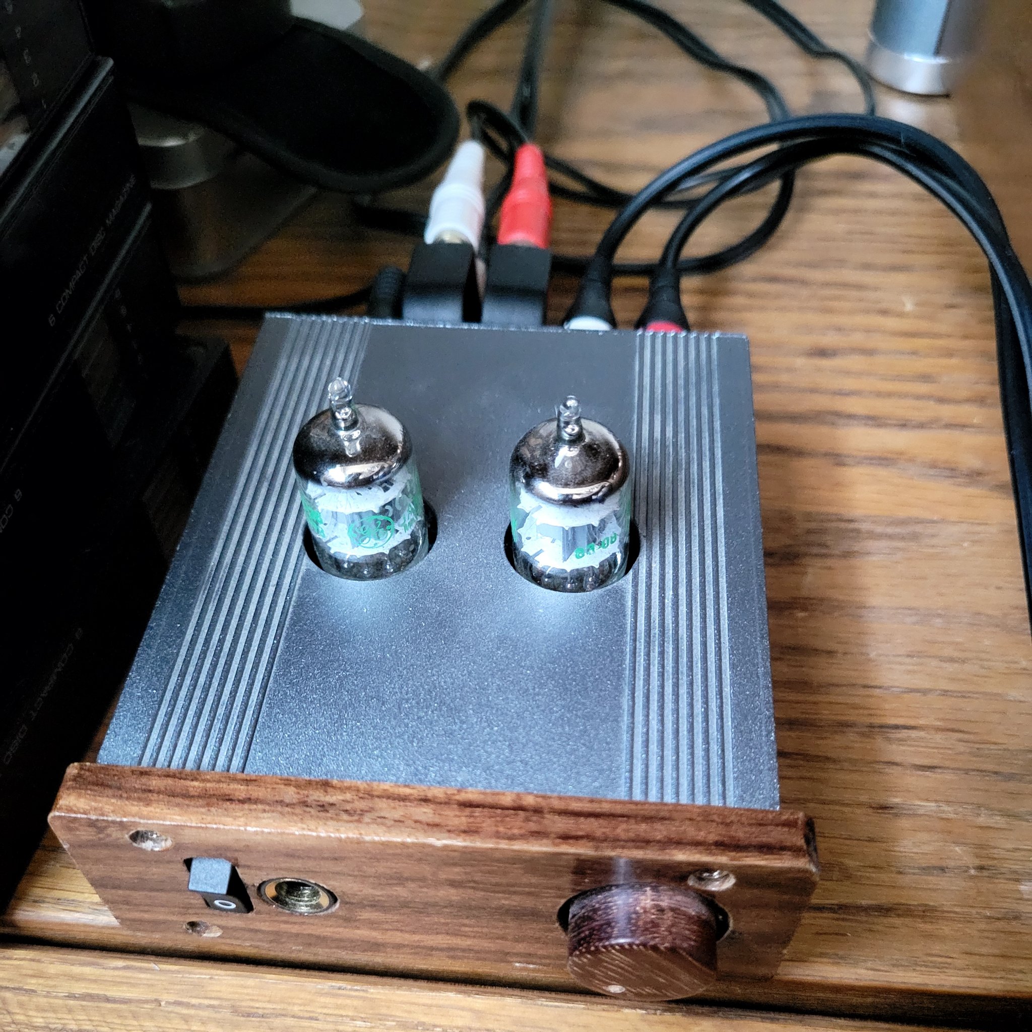

pics?
I have one that's similar with a headphone jack and line level out I bought several years ago. The GE tubes definitely made a big difference. This one I have has a SS single ended class A output stage. It sound pretty good.

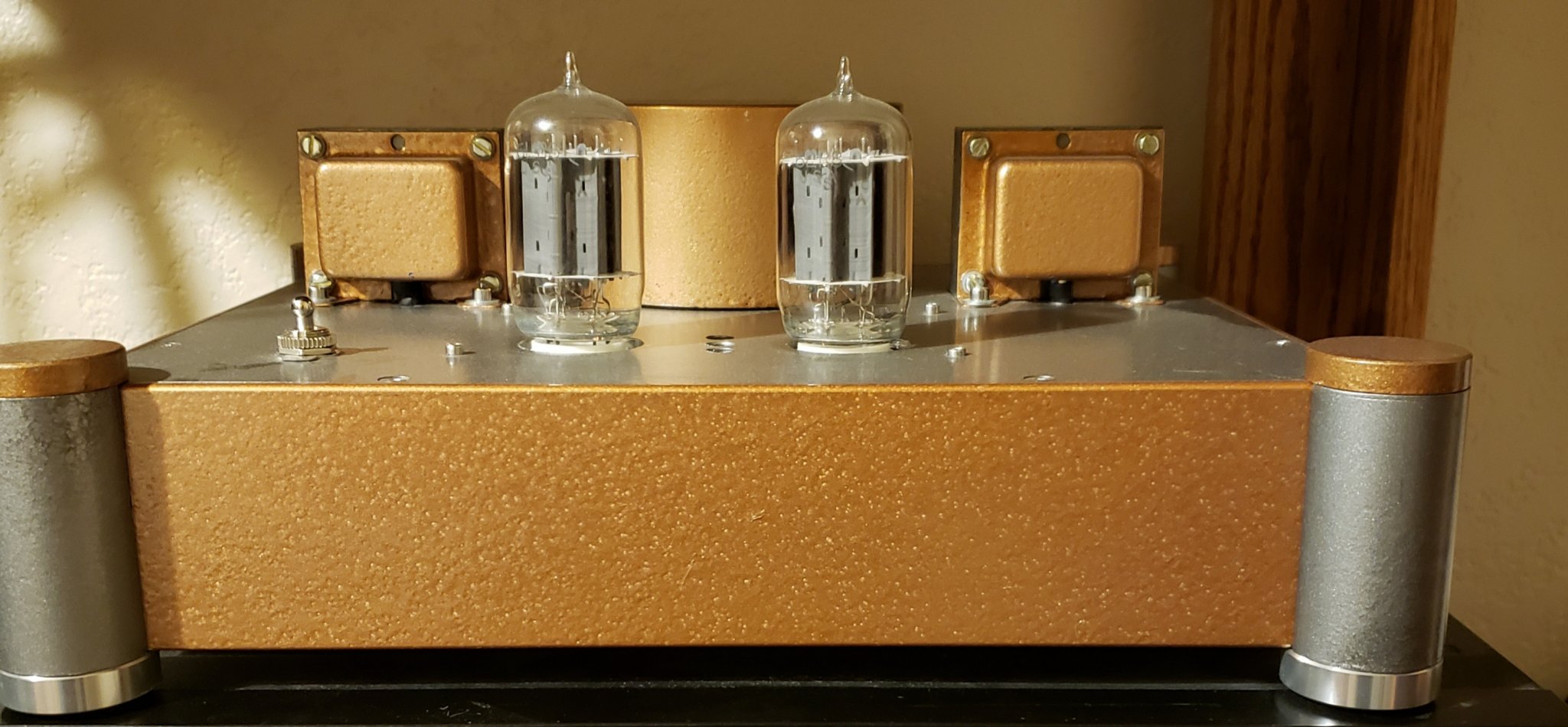

I use it with an amp I built that uses two sweep tubes.
