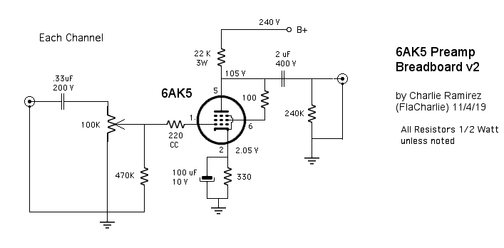

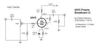

When I commented earlier in the thread, I mentioned that I had breadboarded the FX in both stock form and using more "normal" operating points. It did sound much better when operated at normal voltages.
I'm amazed that people put so much effort into upgrades (tube rolling, caps, op amps etc) to the stock unit yet they ignore the sub-optimal operating point.
The problem with modifying the stock unit to produce those voltages is that so much needs to be changed to do it, including a different power supply. It sounds like you are addressing those issues - making sure that the voltage rating of the caps is high enough and that the heater voltage isn't too high.
Anyway, I've attached the schematic of what I breadboarded, which was a big improvement over the stock operating points. I used a bench (traditional linear) power supply with some added filtration.
I'd be more inclined to just build something from scratch rather than modify the stock unit. I admit that's partly because I favor point to point wiring. And, if you build from scratch, why not try some other tube types. I probably tried at least 10 or 12 different types and, IMO, several others sounded better than the 6AK5. But modifying the stock unit doesn't give you much choice, just different variations of the same basic tube.
Also, I still see a lot of people refer to these as a "buffer". It is not, it's a simple anode follower design and with the 6AK5 the output impedance is not well suited for use with SS or Class D amps, which seem to be what most people are using them with. Their output impedance is fine for use with a tube amp but if you use a SS or Class D you will get better results by adding a cathode follower (buffer).
The other issue with the FX is the excessive gain. Not that this only applies to the FX, most all commercial preamps have this problem. The mu (amplification factor) of the 6AK5 in triode (as the FX uses it) is roughly 35.
Gain isn't really needed at all in most cases. Pretty much all amps can be driven to full power using a "passive preamp" (aka a simple volume control) if you use a modern source like a CD player or DAC. Even with zero gain, the signal usually needs to be attenuated. So, with a mu ~35, many people find it difficult to make minor level adjustments, it's either too loud or not loud enough because the range of the volume control is so limited.
In the end, the preamp I built uses the 1626 but I also liked the 6V7G and the Russian 2P29L better than the 6AK5. The 1626 has a mu of 5, so there's a bit of gain available if you ever need it. I mostly use tube amps but I also wanted to be able to drive my Yamaha SS power amp that has an input impedance of 20k. Ideally, that requires the preamp to have an output impedance of 2k or less. Because of the low plate resistance of the 1626, my pre has an output impedance of ~1.4k without using a cathode follower. Here's a thread about it:
