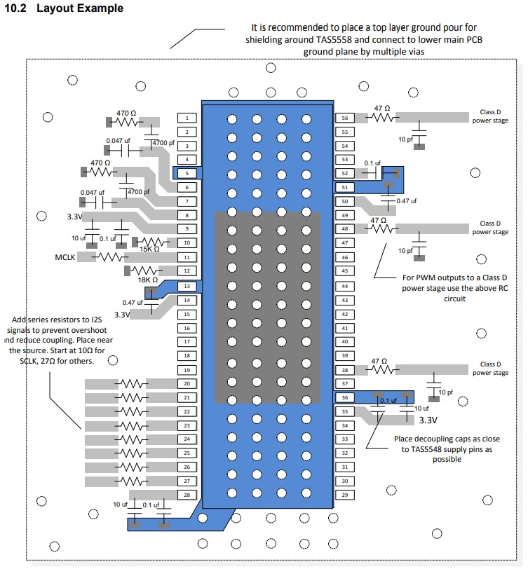

I opened them up to check - the V200 is version 12. Where the USB is on other models, there is a designated space/connections for a bluetooth module. There is also an empty space where an ADC can go too, and there's no USB. 2 SPDIF in only, however, I can't see a CS8416 anywhere (underside the heatsink I assume) and all five inputs are available in the firmware. There's a multiplexer - 74HC253 - which I didn't expect - but I guess this is an I2S source switch for the TAS5548?
The D802 has V2-2017-11-11 written on the PCB. It seems the USB is different from V1 - it is a CM6642 IC now, and the regulators are different from V1 but not much, if anything else has changed. The regs are an adjustable LM2596, which I guess from resistor values is 12V. There are two LM317 after it - its seems 5V and 3.3V from resistor values. It seems that only the final reg is supplying power - the others seem to be there to drop the supply down to 5V. I can't see anything that is running from either 12V or 5V. Can anyone confirm if this correct?
Anyway, I think the D802 is more of a finished product with just XO, regulators and perhaps a bluetooth to play with, while the V200 will be the most fun to modify.
